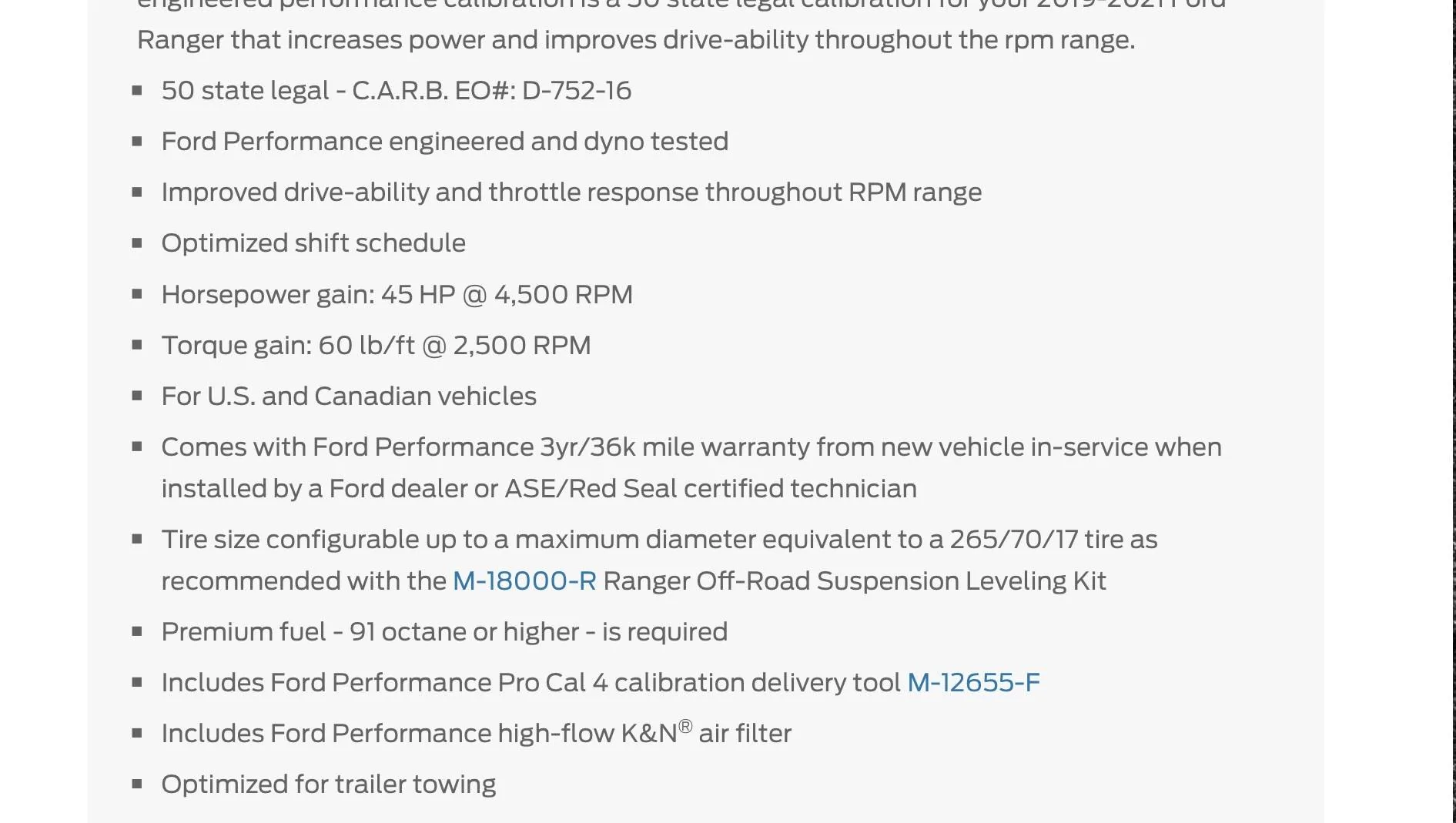

Per the Ford Performance website - Comes with Ford Performance 3yr/36k mile warranty from new vehicle in-service when installed by a Ford dealer or ASE/Red Seal certified technician.

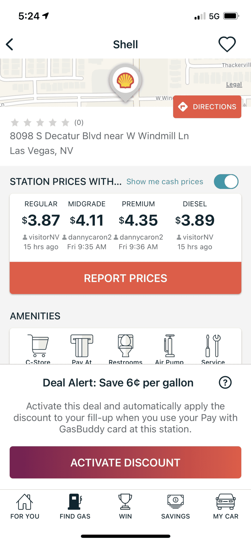

Depends on your definition of “isn’t too much”
In Vegas it will cost you at least $8.16 more per fill up to step up to 93 octane (used 17 gallons for calc). Makes for $73.95 per fill up.
Maybe your fuel cost is not this high today in your area (yet). But it could be in your future. Might consider it since your even talking about MPG.

There is no issue with towing. My mileage went up about 1 mpg.
