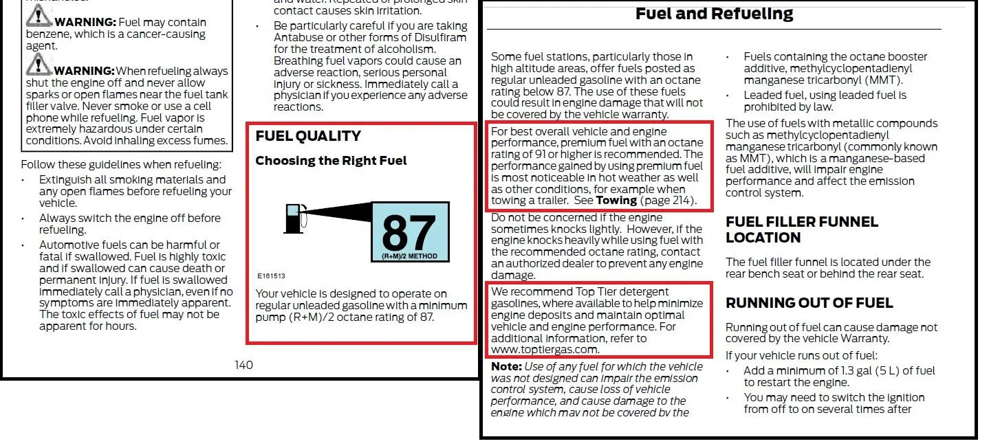

One more new guy question. Reading the manual for my new truck (hit 150 miles today) I see that Ford recommends premium fuel for hard use, etc. When I’m driving in 85 degree heat, I’m feeling a bit of rumbling that reminds me of an old Miata running on the knock sensor. I still have 3/4 of the dealer’s full tank of regular unleaded, but intend to fill with 93 octane when it gets to 1/2 tank., just to see if there is any difference. Has anyone else experienced this?
Welcome new guy.
Let's re-read the owners manual:
"For best overall vehicle and engine performance, premium fuel with an octane rating of 91 or higher is recommended." <-- (notice that period at the end of the sentence)​
It then says it's most noticeable in hot weather and towing a trailer.​
Who wouldn't want best overall vehicle and engine performance?
The more you read and learn about these direct injected turbocharged 4 bangers.... the more you come to realize the benefits of using top tier fuel with at least 91 Octane. Without 91 Octane the computer has to work it's magic, making changes, and all of those changes are detrimental to performance.
