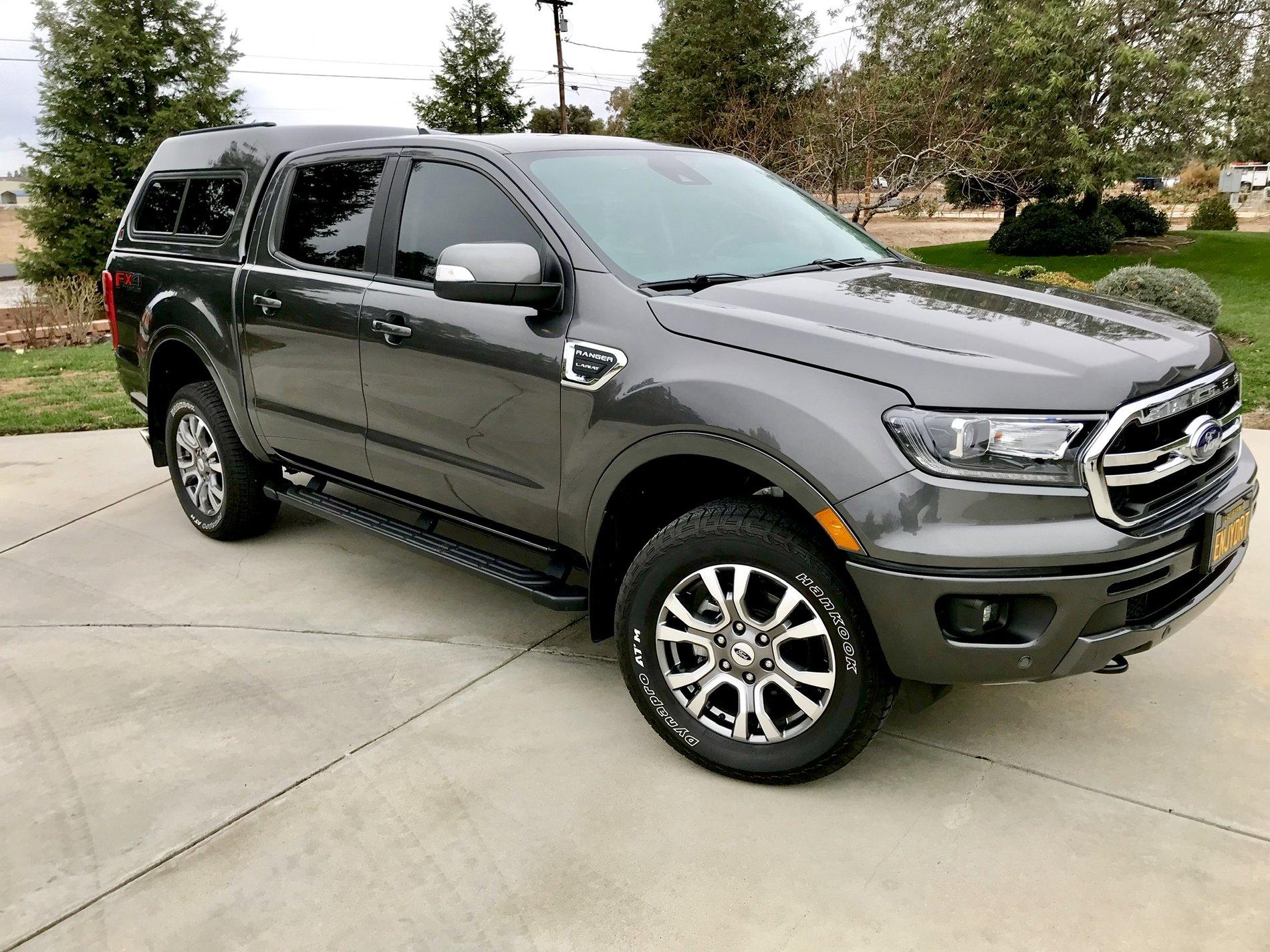

I went through all the stuff you've mentioned about a month ago on my Ranger. Wash, clay bar, polish, install PPF, install ceramic coating. I also used Menzerna, and was very happy with how it turned out. I did not bother taping off any part of the truck during the polishing process, and there were no marks left on any of the non-painted surfaces I may have touched with the polisher - with one small exception: there were some small discolorations on the bed caps where the polish was worked into the plastic just a bit, but that came out pretty easily with some IPA solution, a microfiber towel, and some elbow grease. I found that I didn't need to do much polishing, either. I went over the whole truck once with a polishing pad, and went back over a few small areas with a slightly more aggressive pad, then again with the polishing pad where there were still tiny micro scratches in the paint. All in all, the whole process took most of 3 days (but a lot of time was spent on the PPF, as it was my first time ever doing it and that stuff is pretty tricky) but I'm really, really happy with the results.
I filmed the whole process, and am working on editing it all down into a shortish video I'll put up on my YT channel as soon as it's ready. I'm happy to answer any other questions you may have as you prepare to do your truck.
Good luck!
