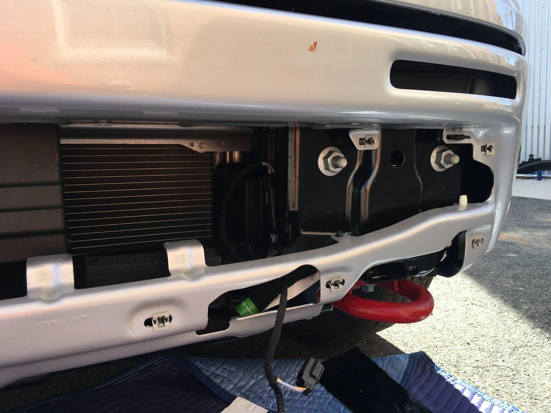

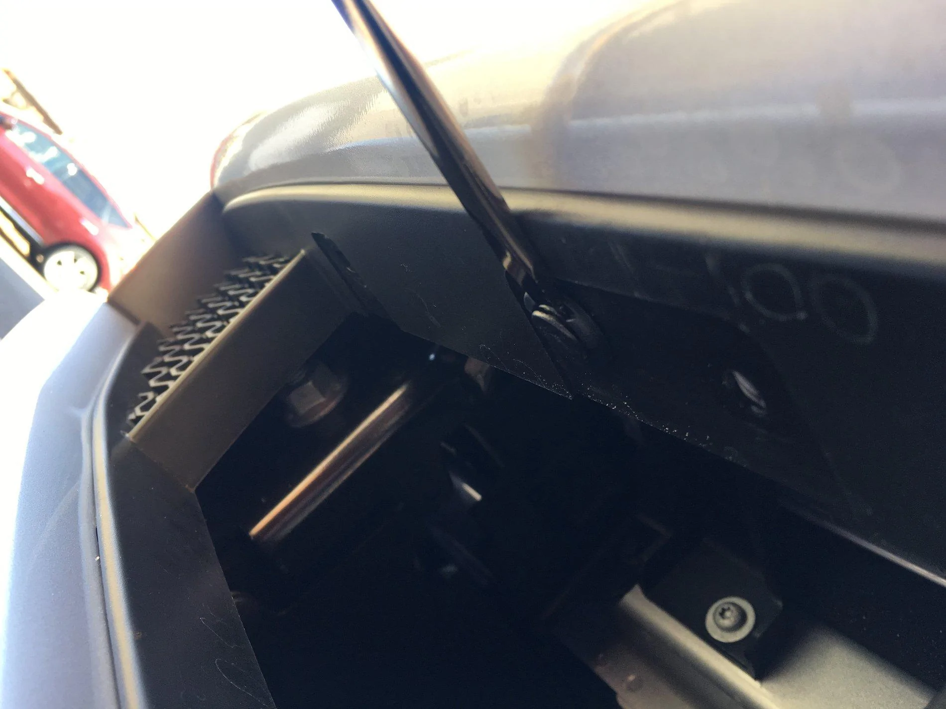

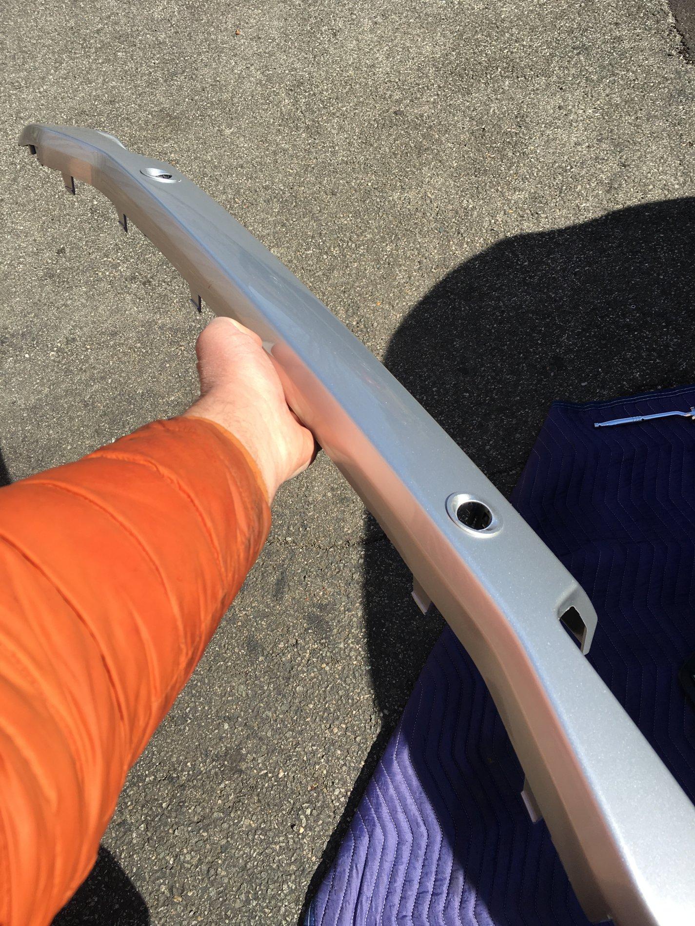

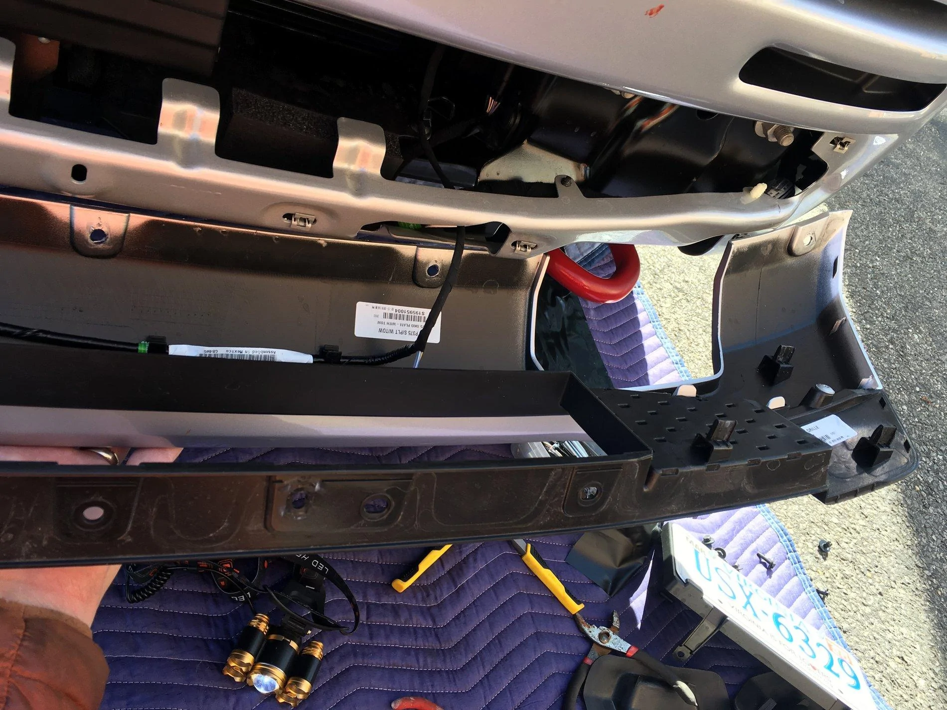

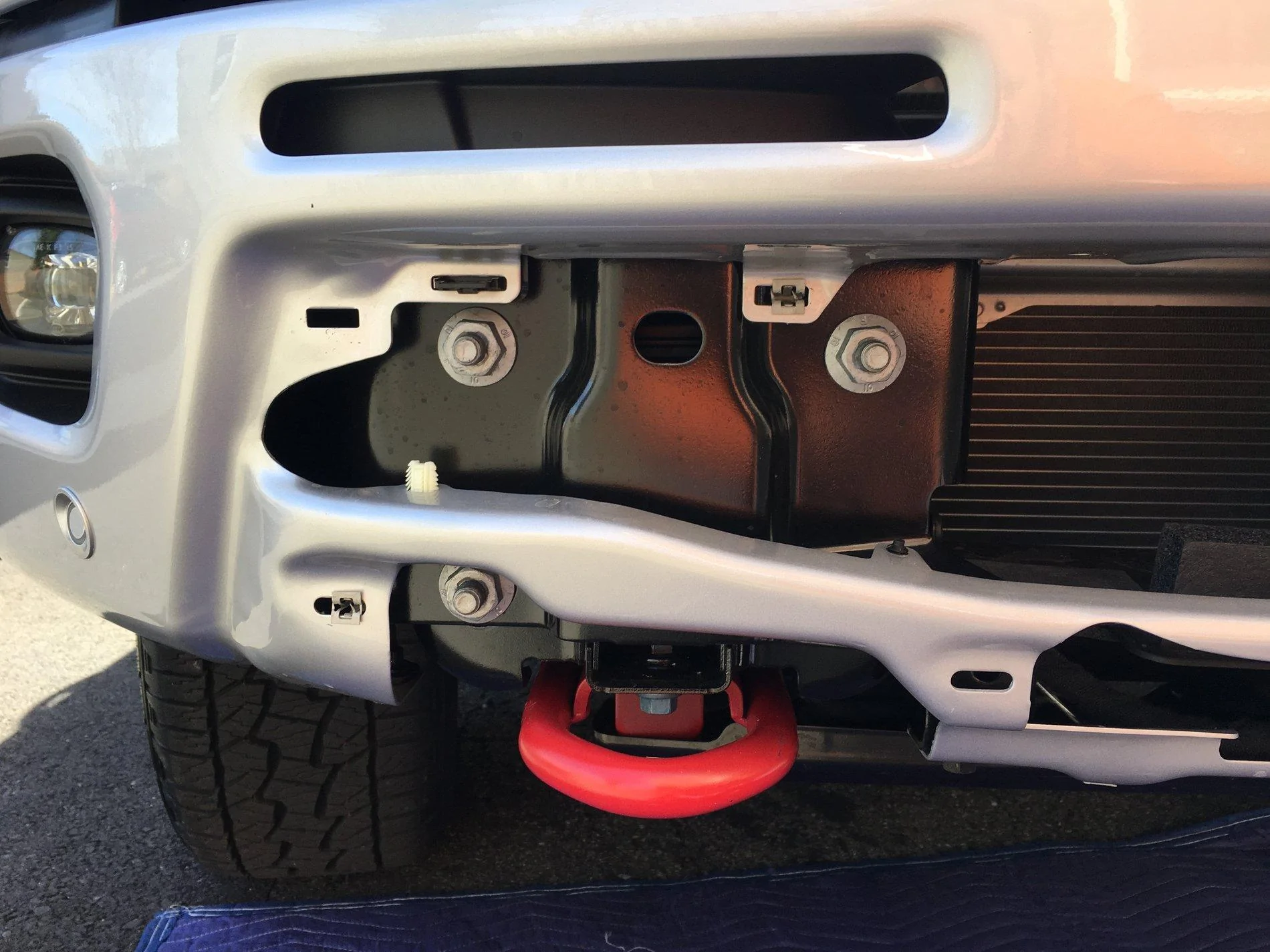

Got it off. Here are a few pics. You can see the places where it attaches. There are a few clips too but you can pull it off with some pressure and if you can squeeze the back of the clip that helps.

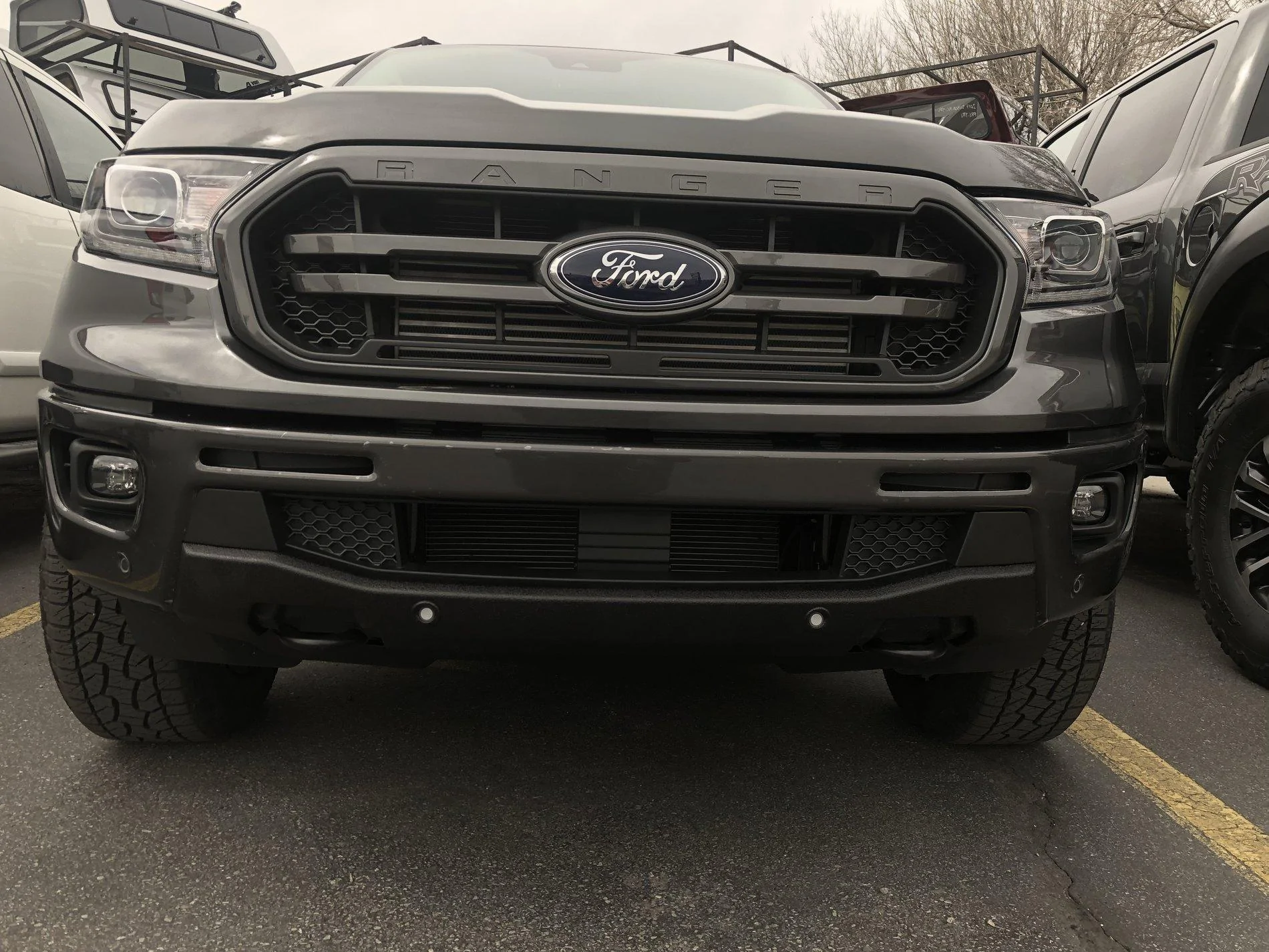

Looks great! What did the LineX run you?
So they sprayed both sides of both pieces and it was only $160.00...My bed was $595.00 had it done in about 3 hours.
