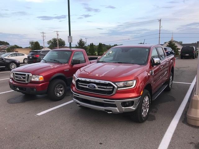

(I found it's older brother in the wild)
