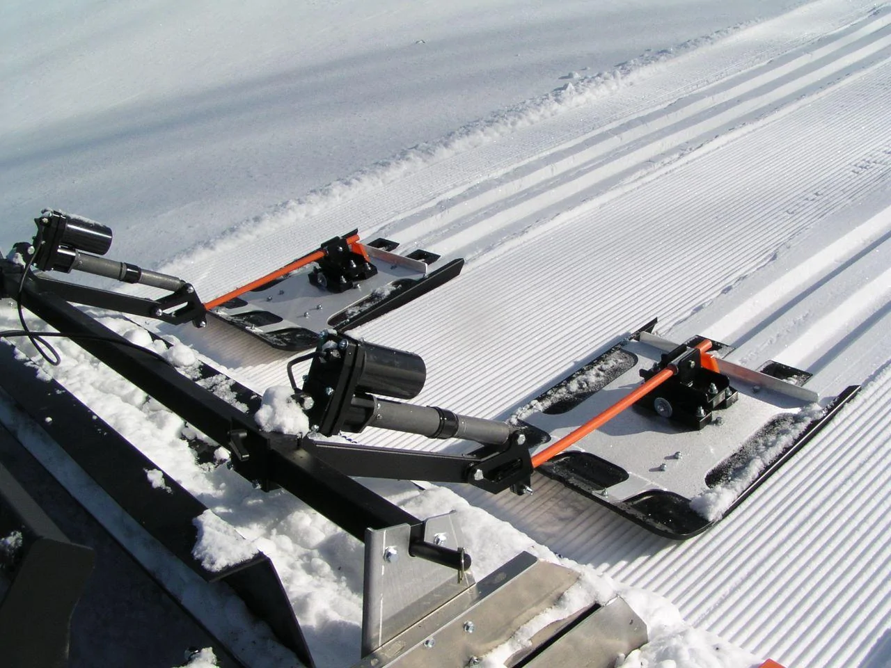

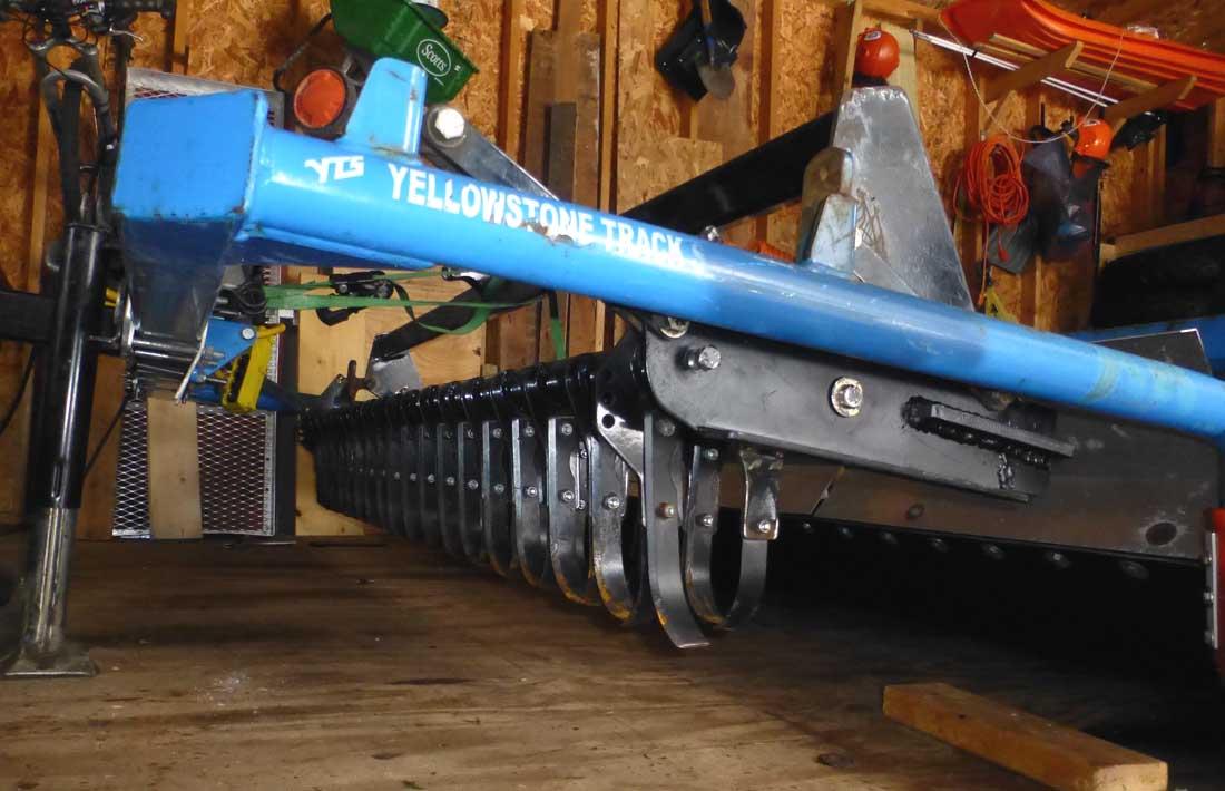

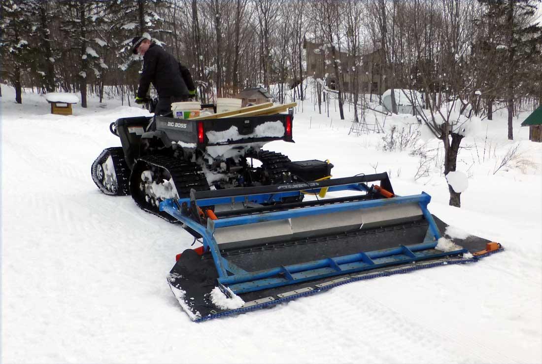

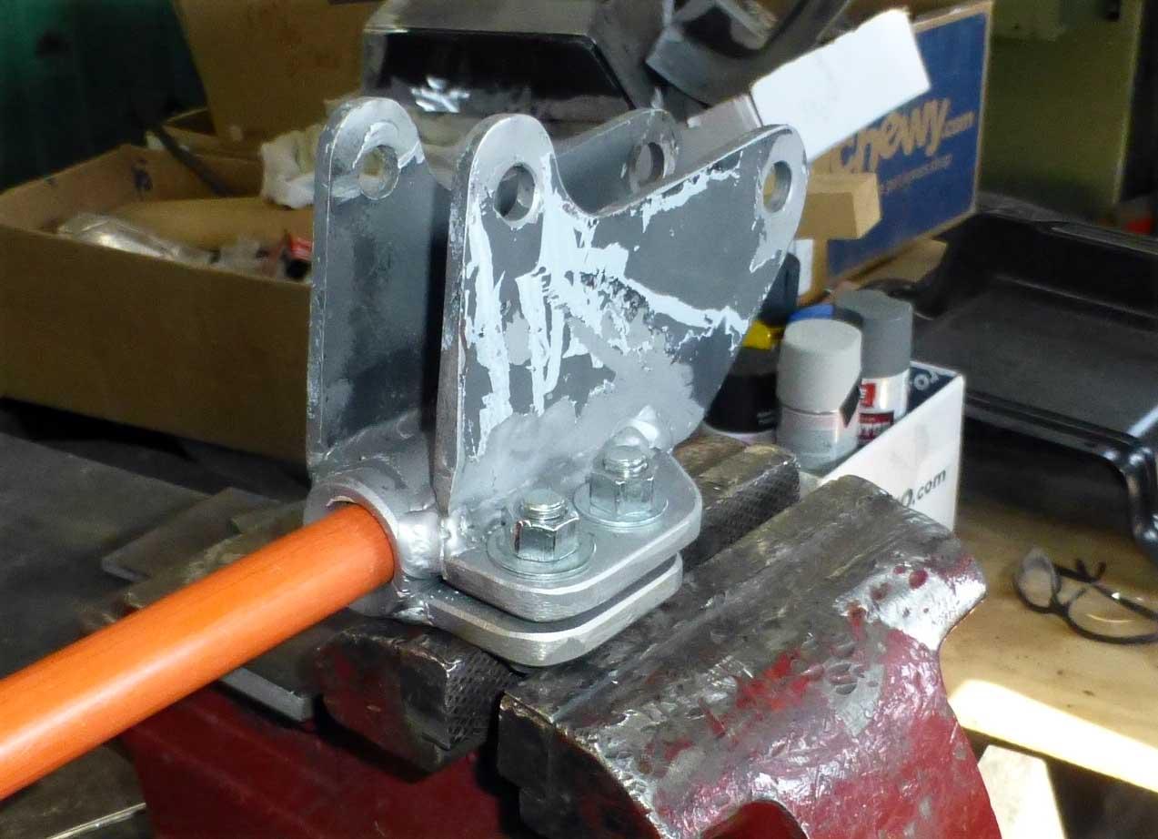

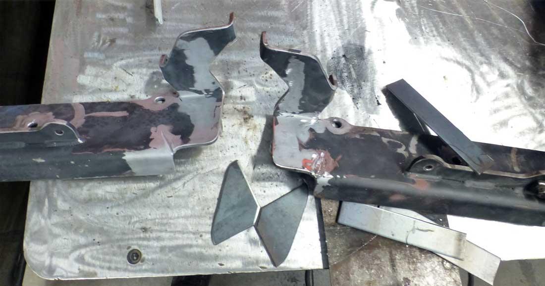

Here are photos taken while this machine was disassembled. This cutting depth control arm was bent, I'd guess from the hydraulic cylinder once used on it. It has a Burr actuator on it now which most Ginzu's use.I'm rehabbing a dated 108" ginzu groomer and will retail it after done. I'd post more pictures if anyone here is interested in seeing its progress. Its mostly welding, painting and replacing parts. Here is them at YTS who manufacturers them.

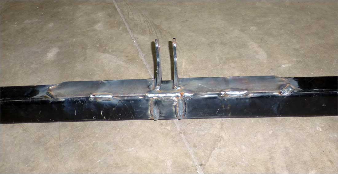

I cut some pie shapes out, straitened it up and welded it back up. Added a fish plate as well. Tube is just 1/8 walled.

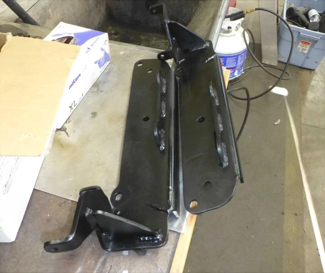

The tooth carrier brackets were cracked and bent as well. You ca see some gussets I'll add and the cracks are ground out to be welded. This is all mild 1/4" plate.
All better!

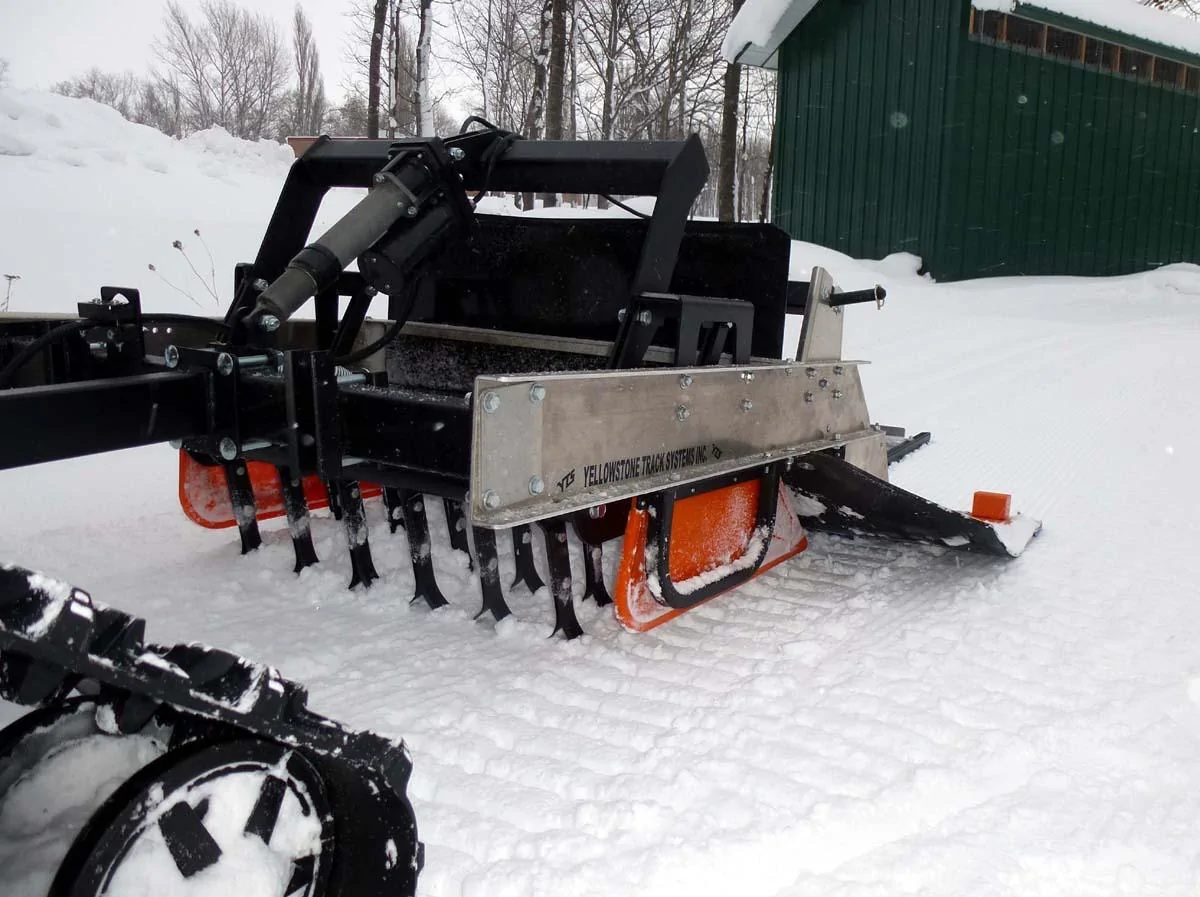

Here they are reassembled on da machine. Clear as mud!!!
