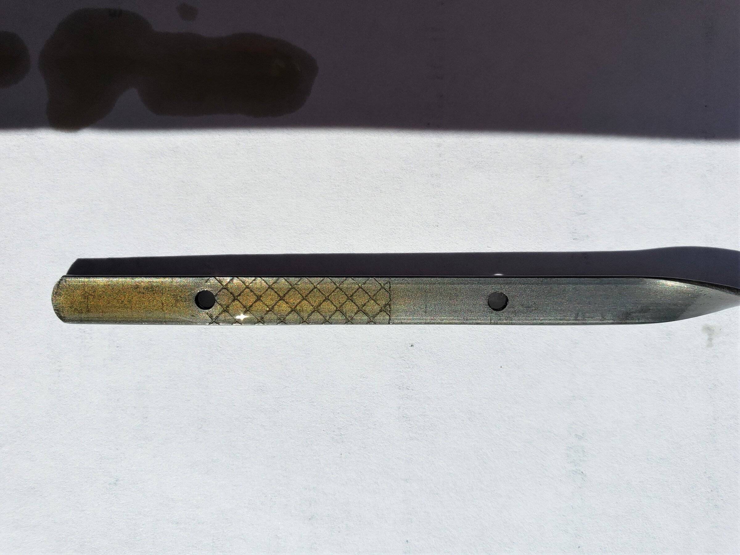

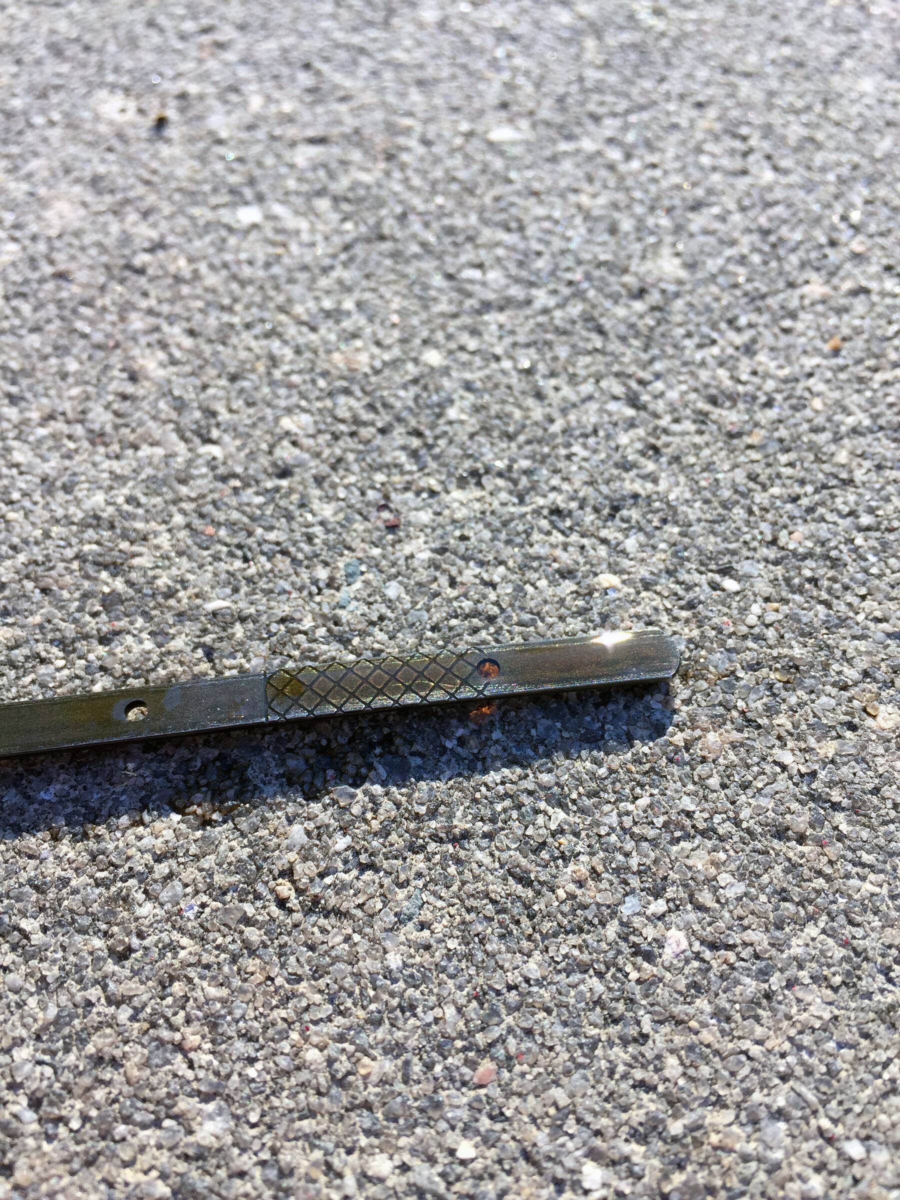

The only way I've been able to get a reasonable oil level reading is to park the truck on level ground and check the oil after it has been setting overnight. I check it 1st with out wiping the oil off and then again after wiping the oil off. I'm thinking that the oil needs a lot of time to drain off the dipstick.

Well, a cold engine sitting overnight did the trick...still need the full blast of the sun to see that I'm right on the mark... ? ?
Still looking for an upgrade dipstick that works better than this dipshit... ?

Same problem...here's my level after an overnight check...

FWIW, I can't think of one vehicle I have owned over the past 50 years that I could check the oil right after changing it or shutting it off. The oil draining down from the top of the engine drips onto the dipstick and gives you a false reading. It takes quite awhile for all the oil to run back into the pan and get an accurate reading, an hour or two minimum.
The one unusual thing I have noticed with the three 2.3 Ecoboost powered vehicles I have owned is the oil level on the dipstick varies quite a bit between hot and cold. If I check the oil first thing in the morning after sitting all night it will be at the top of the hash marks. If I let it sit an hour after having been throughly warmed up it will read half way between the top of the hash marks and the max fill hole. Over the years I have had vehicles with automatic transmissions that had minimum marks for cold and hot but I have never noticed enough of a change with the engine between hot and cold to note it.
