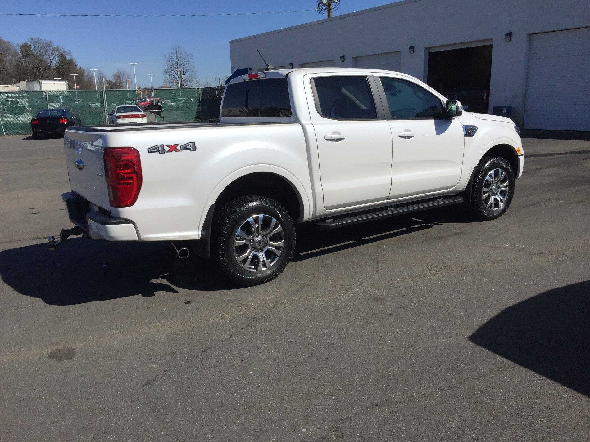

I have a stock 2019 Lariat 4x4, non leveled-lifted. Excessive body movement/bouncy ride are a bit much. I read where Bilstein and Eibach offer decent OEM style shocks that are a notable improvement over the stock, factory shocks. Looking for opinions and leads - thanks.
