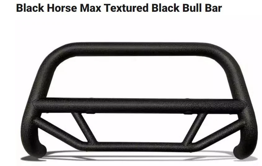

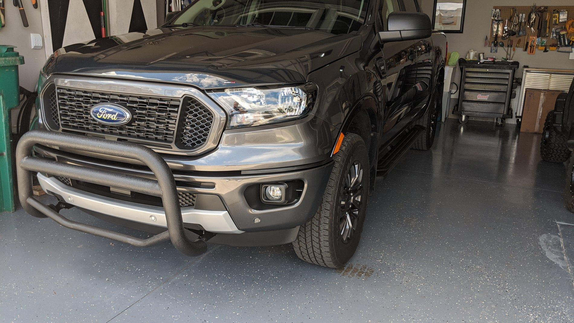

I bought the Black Horse Bull Bar and modified it. The center cross bar was blocking the AEB radar unit. So I cut it off and raised it. I removed the 2 small bottom pieces hoping that it would not block the parking sensors, but it still does. So now when I get in my truck, I just turn off the parking sensors. Don't need them anyway. AEB and cruise work fine.
The first image is what I started with and 2nd is how it looks now..
