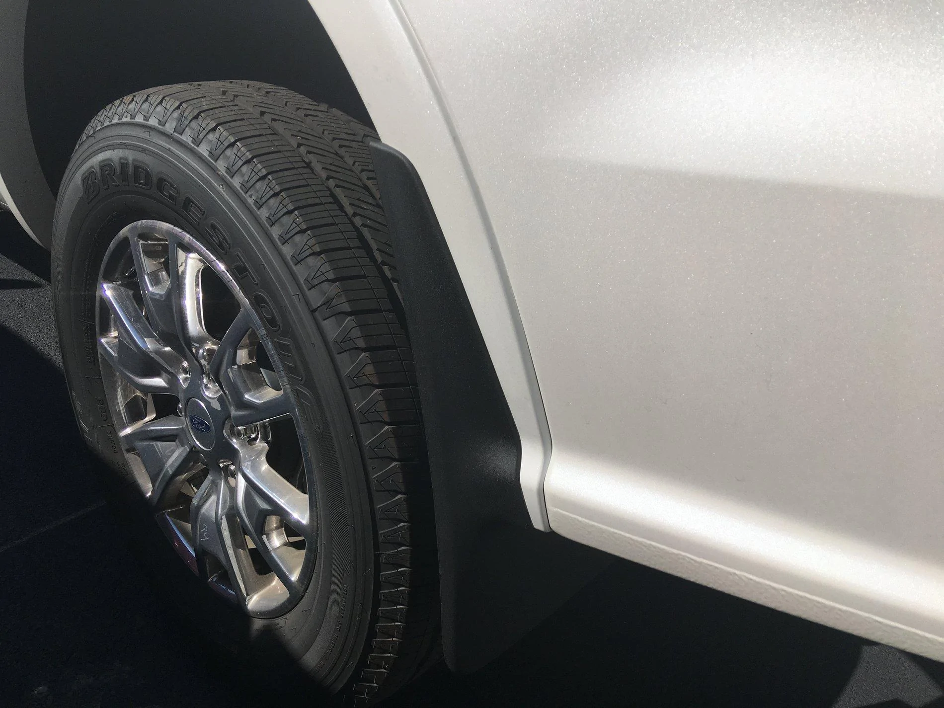

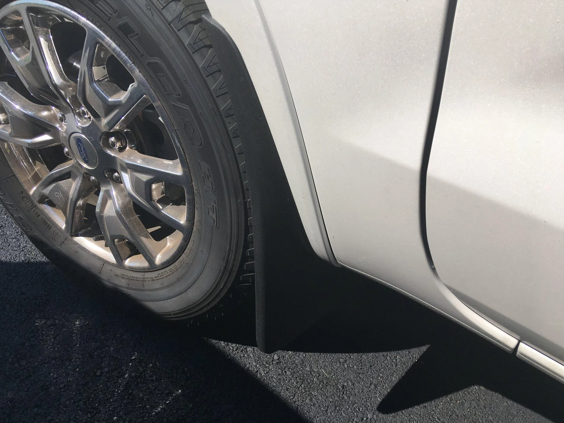

Rich,I got the Ford mud flaps and they fit and work great. Easy install too. Bret

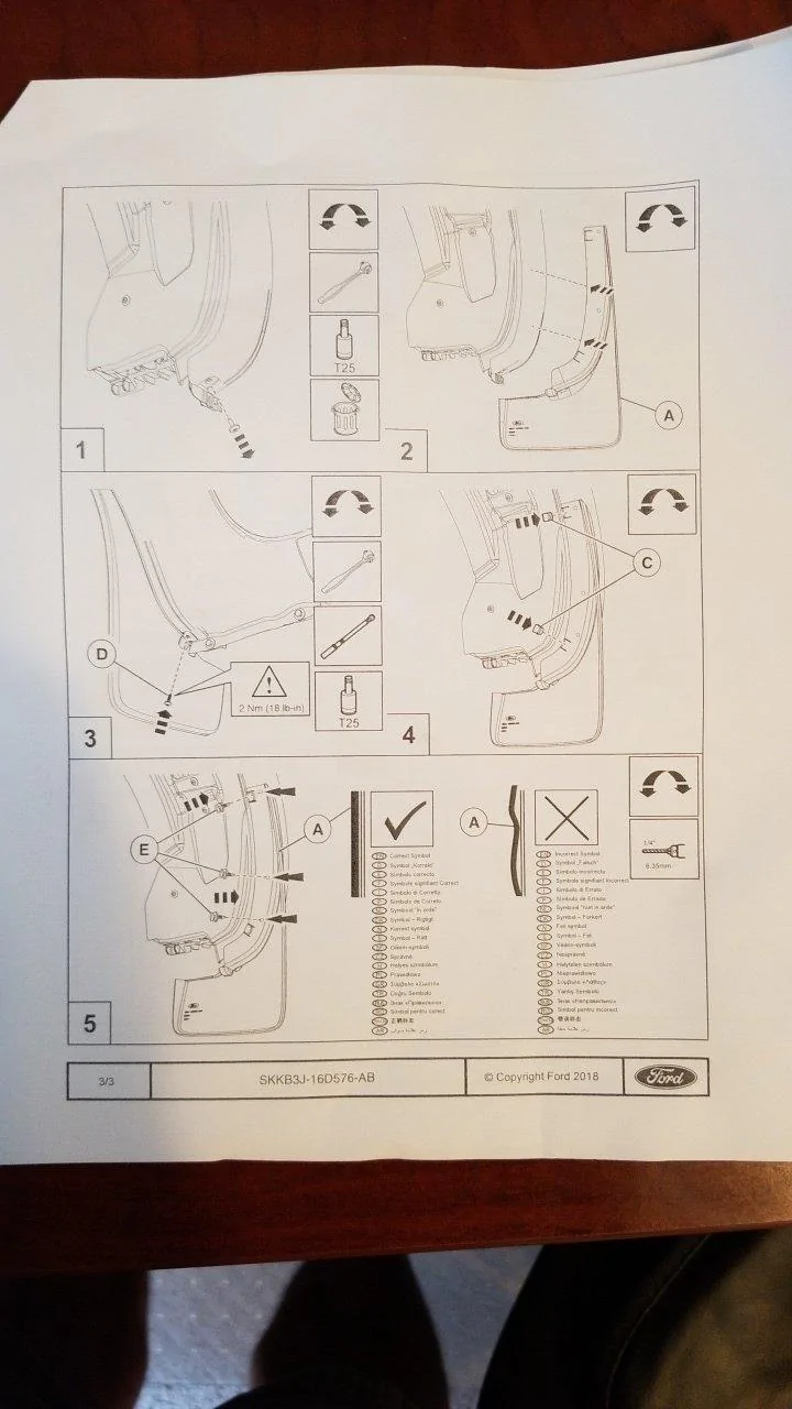

Thanks - did you have to remove the tires? I'm not inclined to do myself although I'd consider if I could see install instructions. Dealer claims they would have to remove tires and $$$. I had them put on the Borla/Ford cat back and it came with great instructions but I haven't found any online.

Very easy to do yourself,15 minutes max and you dont have to remove the tires. I tossed the directions but just a couple of holes to drill and couple screws and clips,very easy. Bret

No need to remove the wheels...you can turn the front tires to give you space. The back wasn't a problem.
