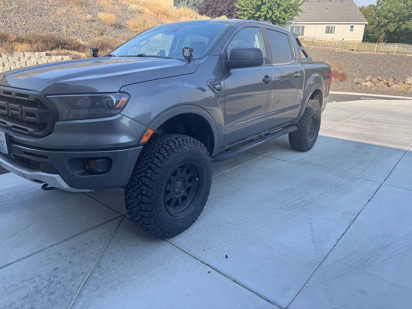

I've been slacking on getting my build thread started on my 2020 Ford Ranger XLT FX4 in magnetic gray, Sir Reginald the Gray (or Reggie).
New:
Current:
Modifications:
Interior:
  • Built Right Industries dash tray mount
  • Ram Mounts phone mount
  • President Andy II CB
Exterior:
  • Soft roll tonneau cover
  • Ford Performance chase rack
  • Ford Raptor grill w / lights
  • Swing case tool box (driver's side)
  • AlphaRex Luxx alpha-black LED headlights
  • White Knuckle rock sliders
  • Baja Designs Squadron Amber fog lights
  • Bushwacker fender flares
  • Black Rhino Stadium 17x9 +20mm
  • ReadyLift high clearance intrusion beams
  • Radflo 3" lift adjustable 2.5 coilovers
  • Radflo 0-2" lift adjustable rear struts
  • Camburg upper control arms
  • Rough Country 9500 synthetic line winch
  • 589 Fabrication hidden winch mount
  • Firestik II FS3 Antenna
  • Bullet Proof Diesel Dual Antenna Mount

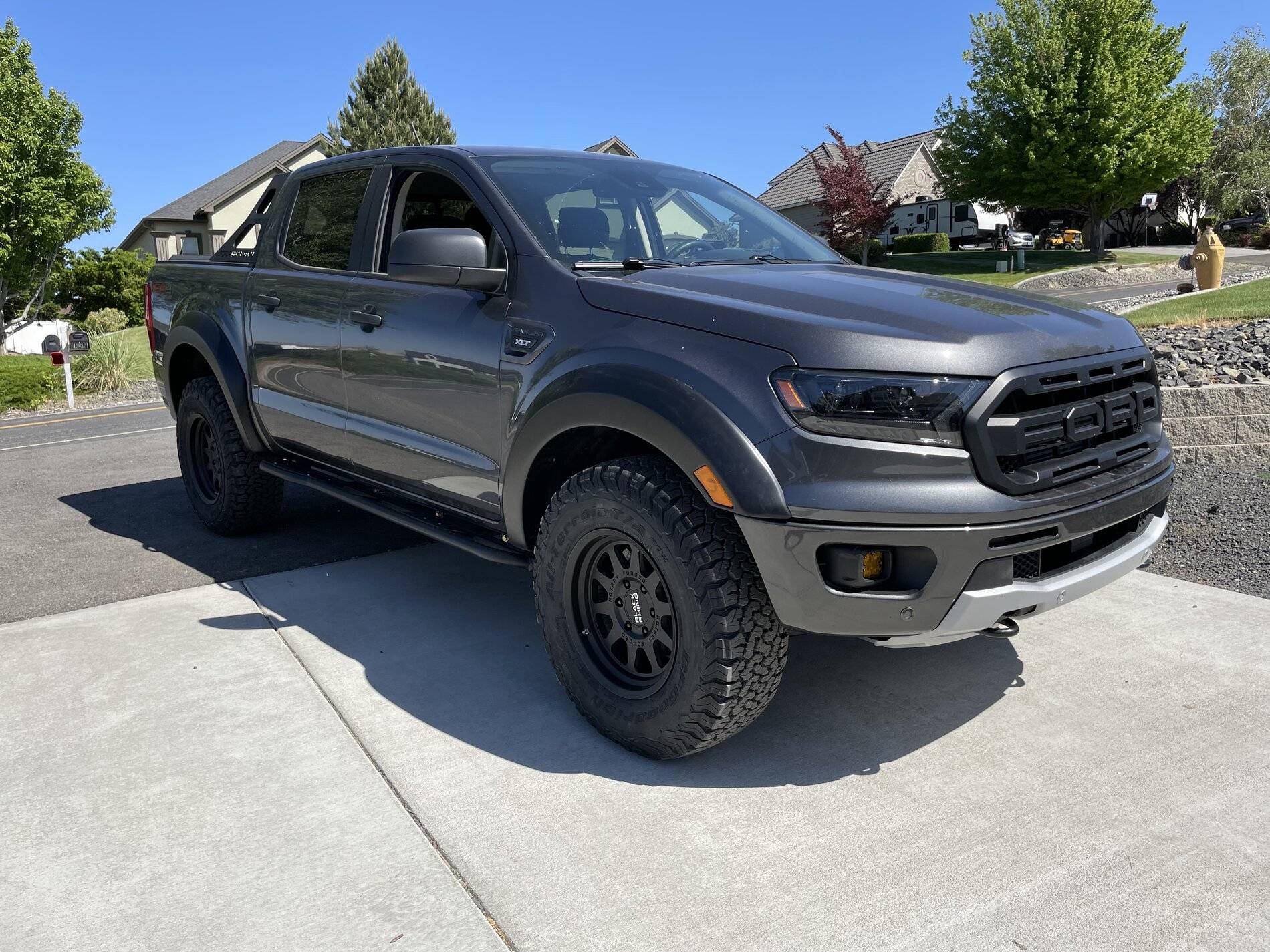

Some more photos now that it's day time. These have a slight (15 degree) angle to them and stay about 1/2" to 1" away from the pinch weld.

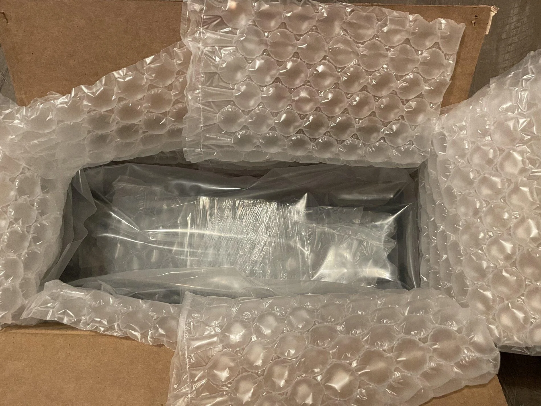

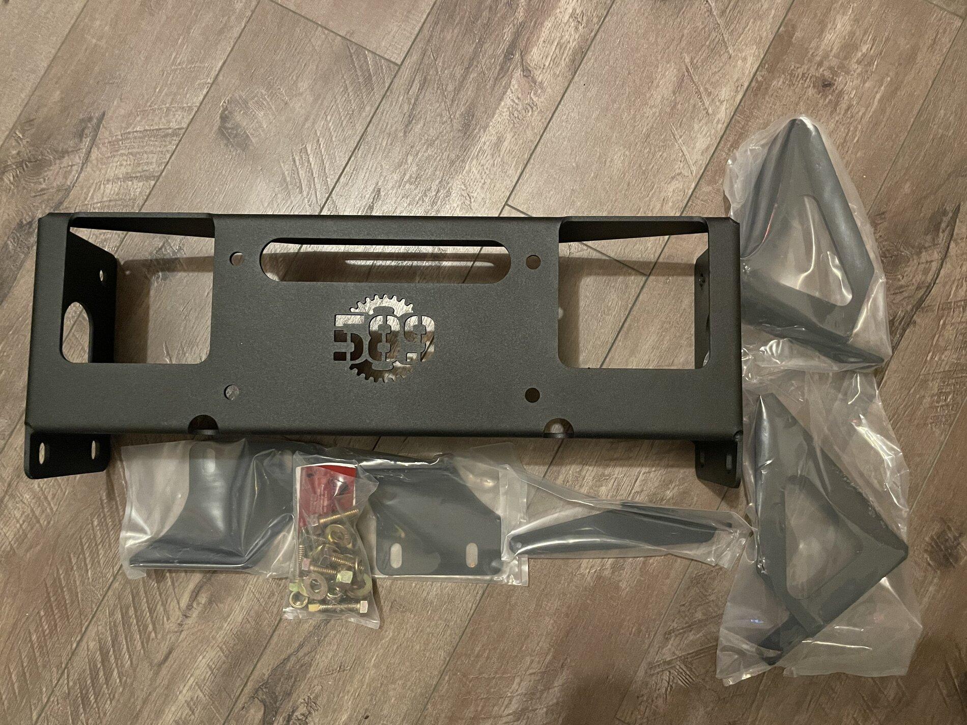

@589FAB hidden winch mount came in today! Just need the winch and intrusion beams and I'll be ready to get the front end taken care of while I wait for the Radflos to come in.
I was rather surprised to see a "Fragile Handle With Care" sticker on something from 589 Fabrication.
My guess is they don't want to leave it to chance that it gets beat up in shipping. This thing was packed in there snug as a bug in a rug.
Here it is in all it's glory. I feel you can tell a lot about a company based on how they ship things. These folks take pride in their work, I'm excited to try it out :)

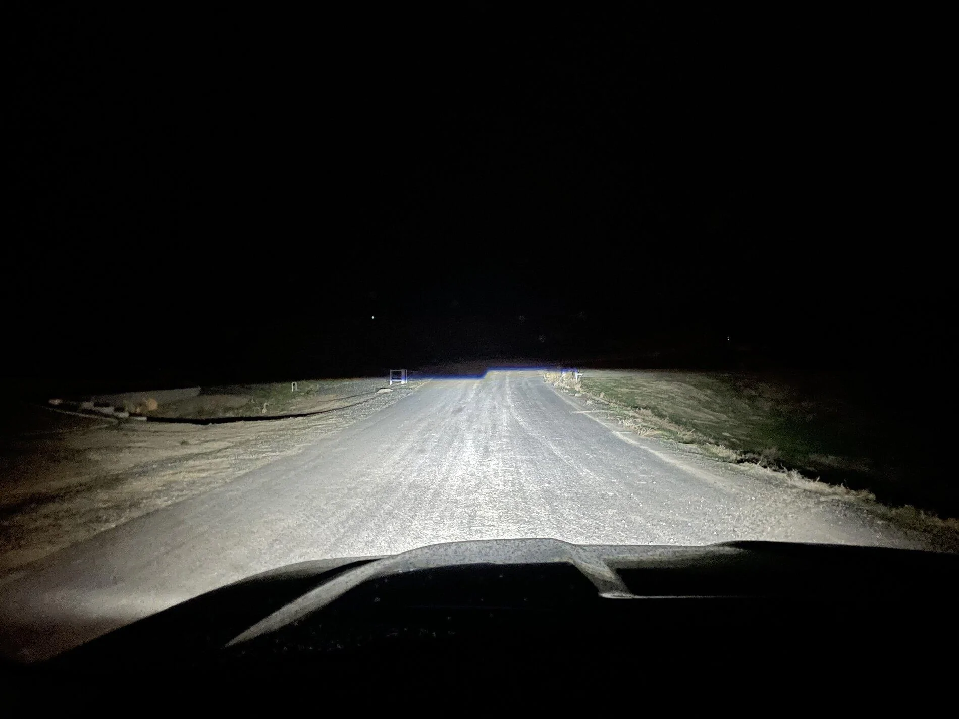

Would you reccomend the upgraded lights over just upgrading the bulbs? I have the bulbs now but can't decide if I like the look of the actual housing as a whole.
I didn't try just bulbs in the Ranger. I had bulbs in my Forester XT and I liked them fine; but I'm loving the headlights. Seeing that cutoff line from the Luxx makes me happy :D. I love the look, way better than the halogen housings I had previously, and I've gotten used to the little start up sequence on this version.

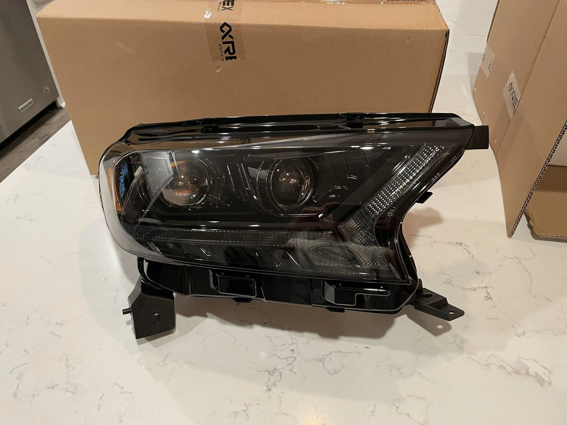

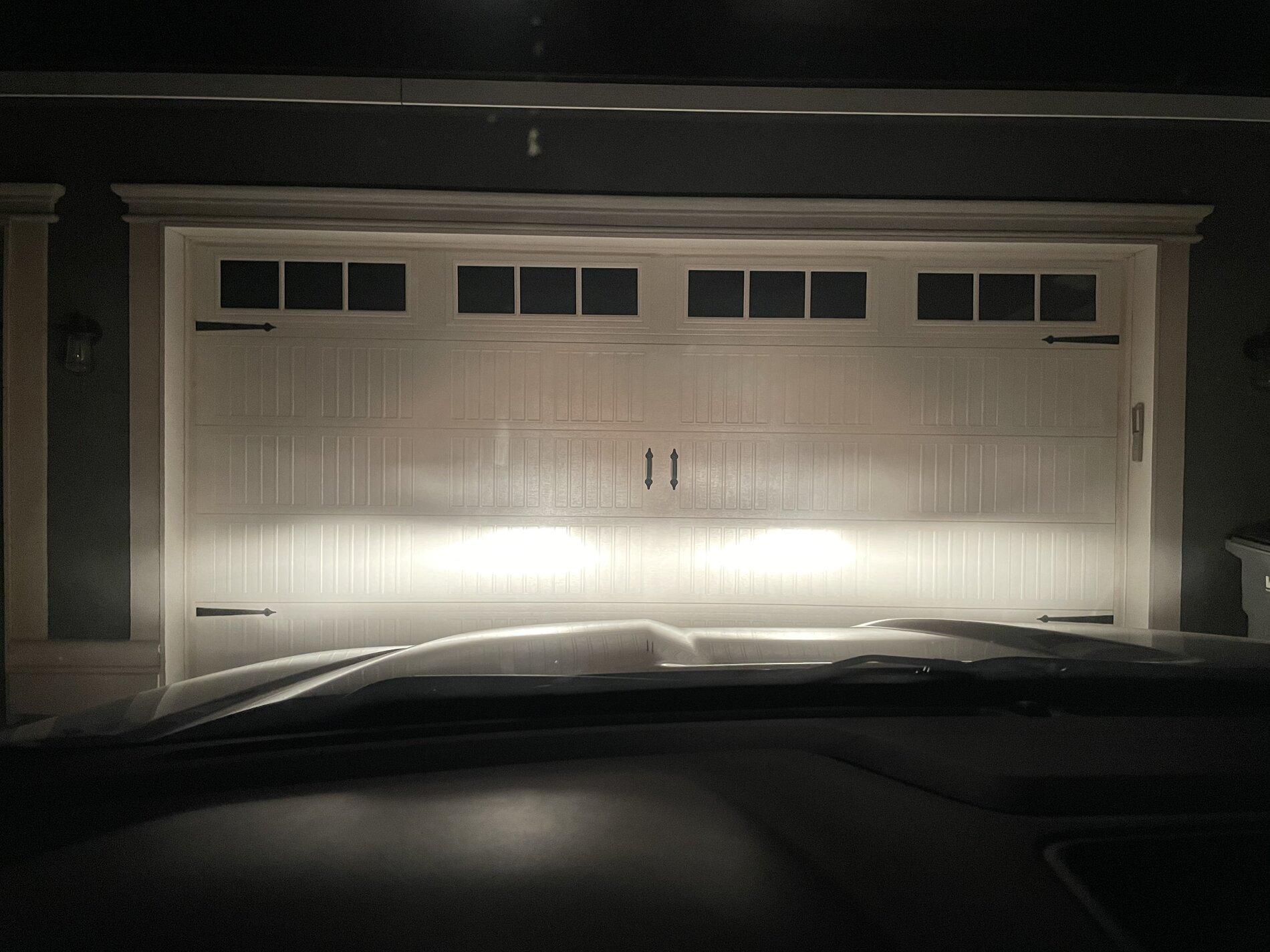

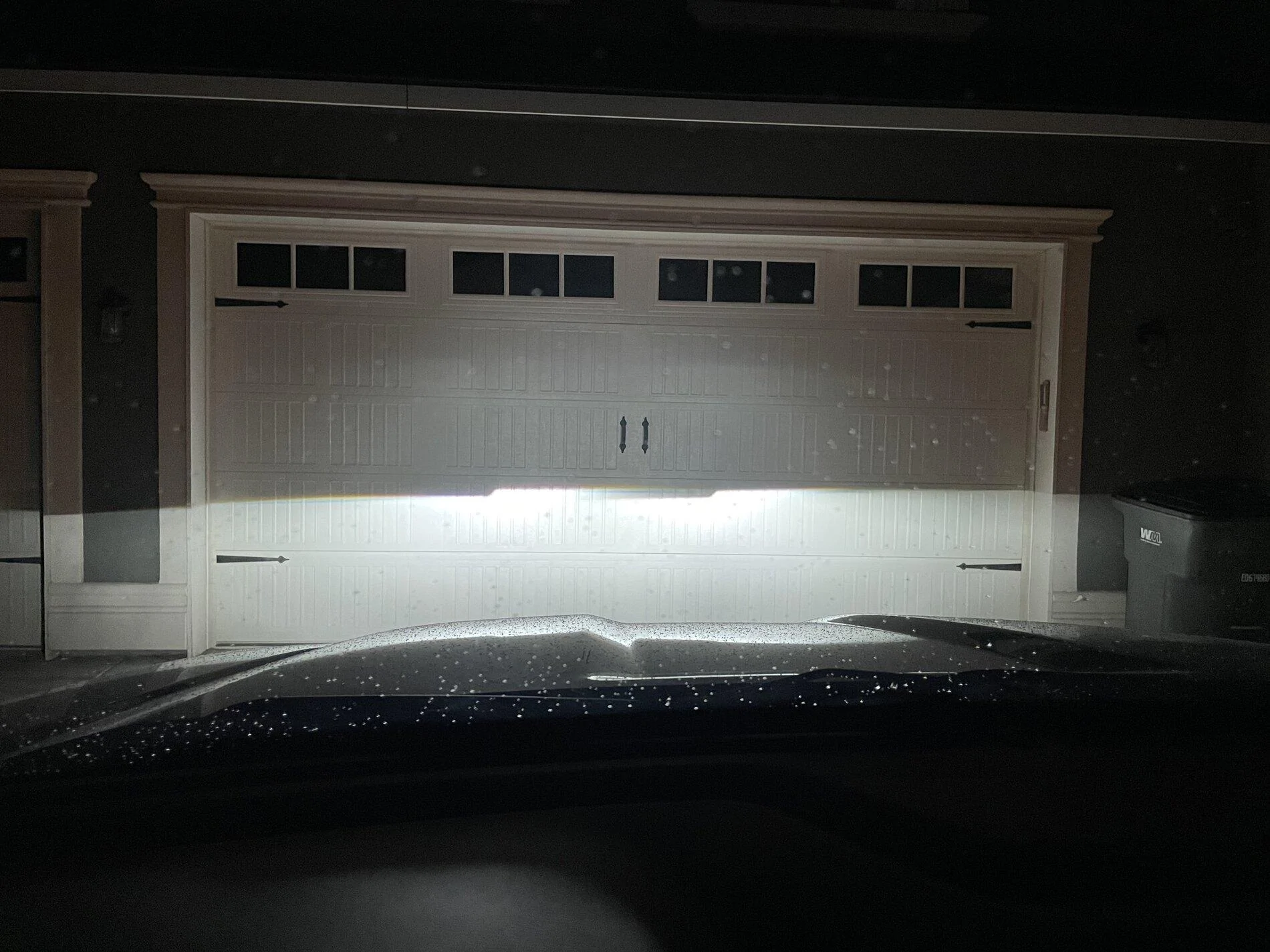

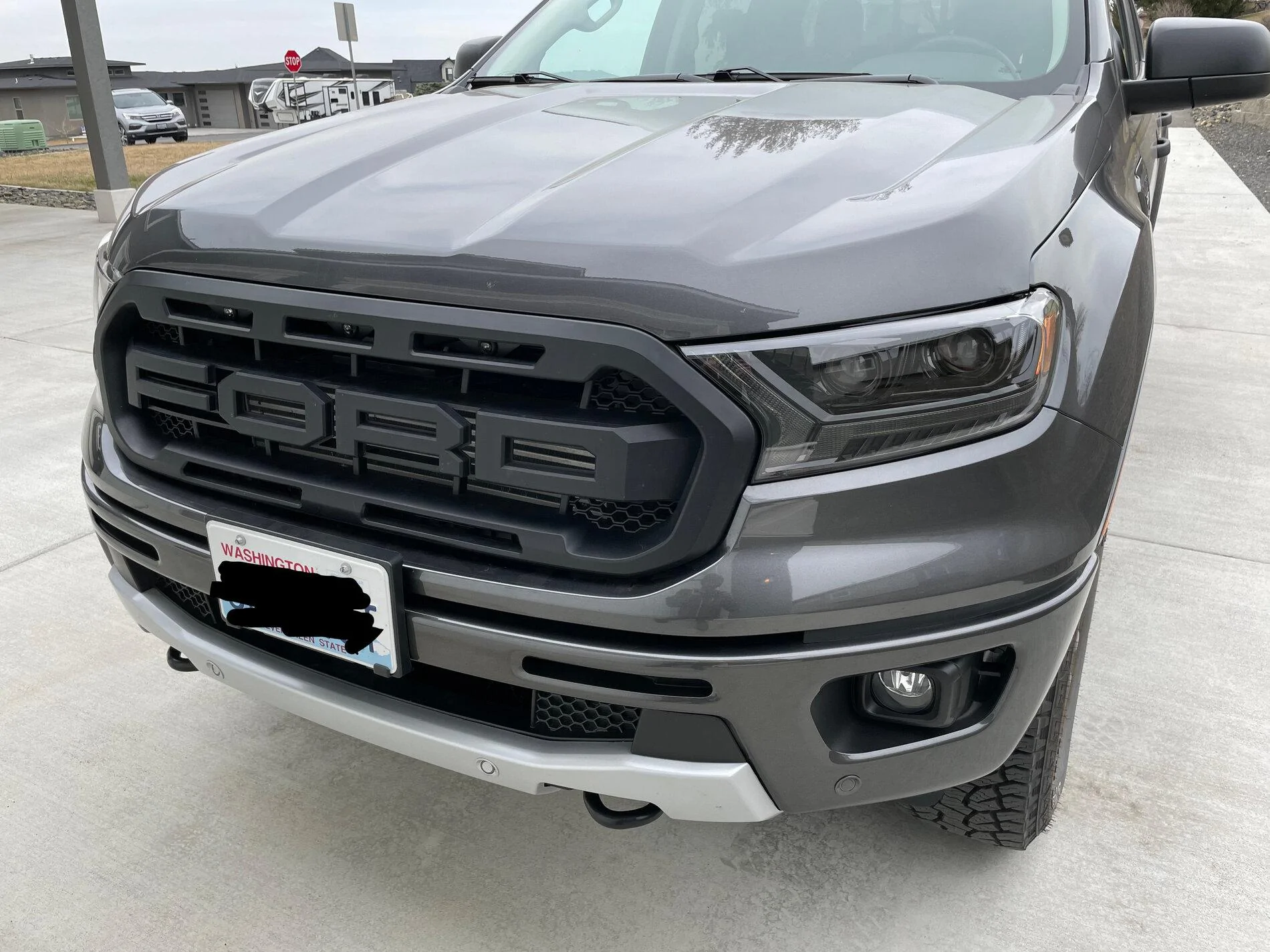

Just realized I forgot to post here when I added the Alpha Rex headlights :)
Such a sexy housing. I went with the black Luxx series and the appearance is awesome.
Won't be the last time I tear the front apart... :D
Before
After (not aimed)
before
After

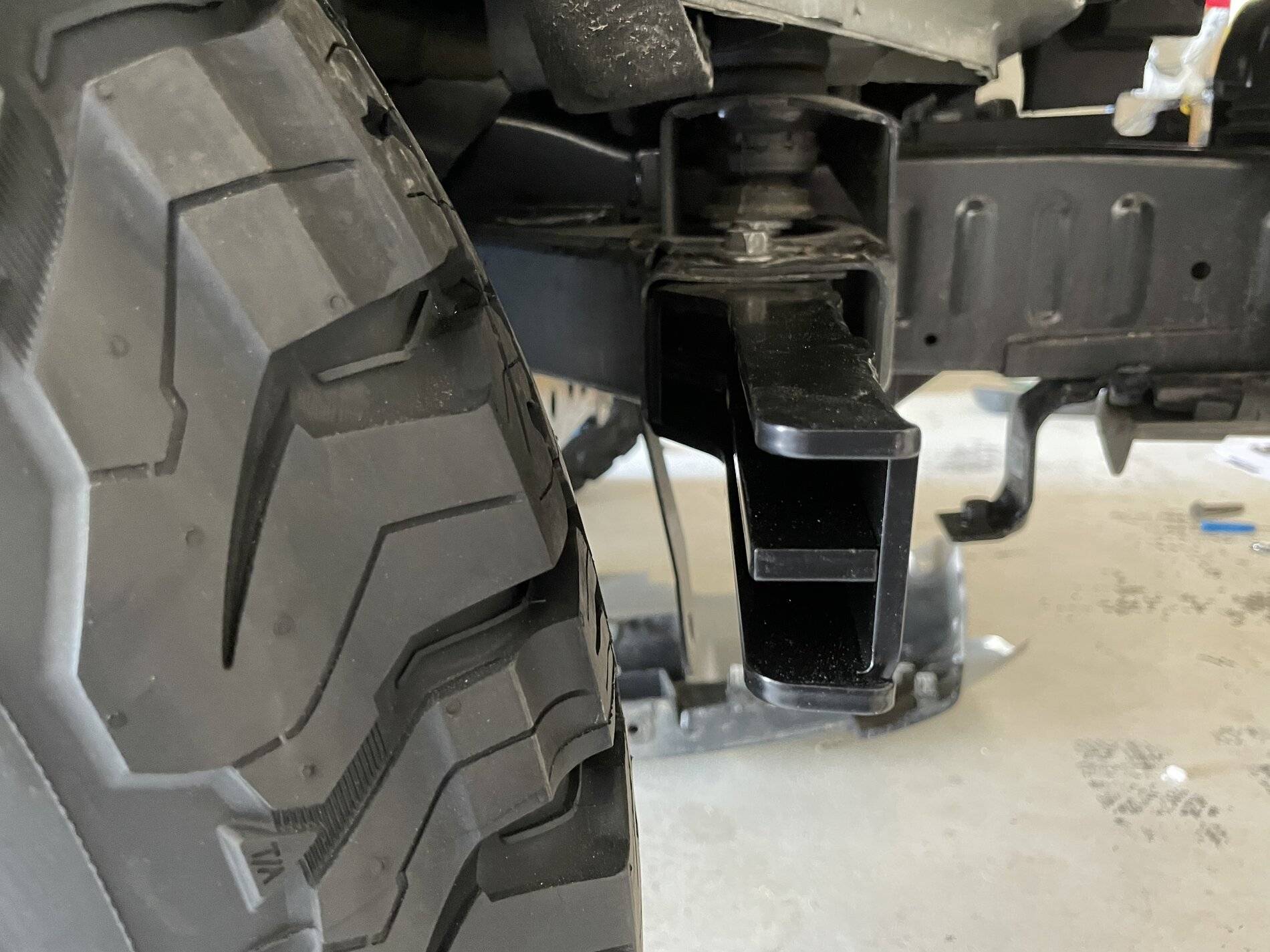

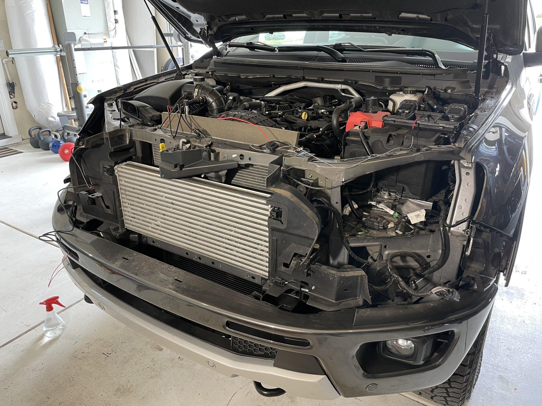

The lift is going to take a while due to supply delays. That said some of the parts are trickling in. The wheels and tires came in and I couldn't just let them sit in the garage so I figured I’d see how much they rub and if the Ready Lift high clearance intrusion beams could handle stock height with 285/70R17 KO2s.
I went to work taking off the front bumper using ADD's stealth bumper install guide as a reference. I'd like to remove the beams without cutting if possible.
With the stock crash beams there’s basically no room in the front. So, I added the front Ready Lift.
The ready lift beams make a huge difference. The front isn't an issue just sitting any more(no testing don on flex).
Now I need to get the back taken care of, the tires hit pretty quickly when turning. Probably do that tomorrow.

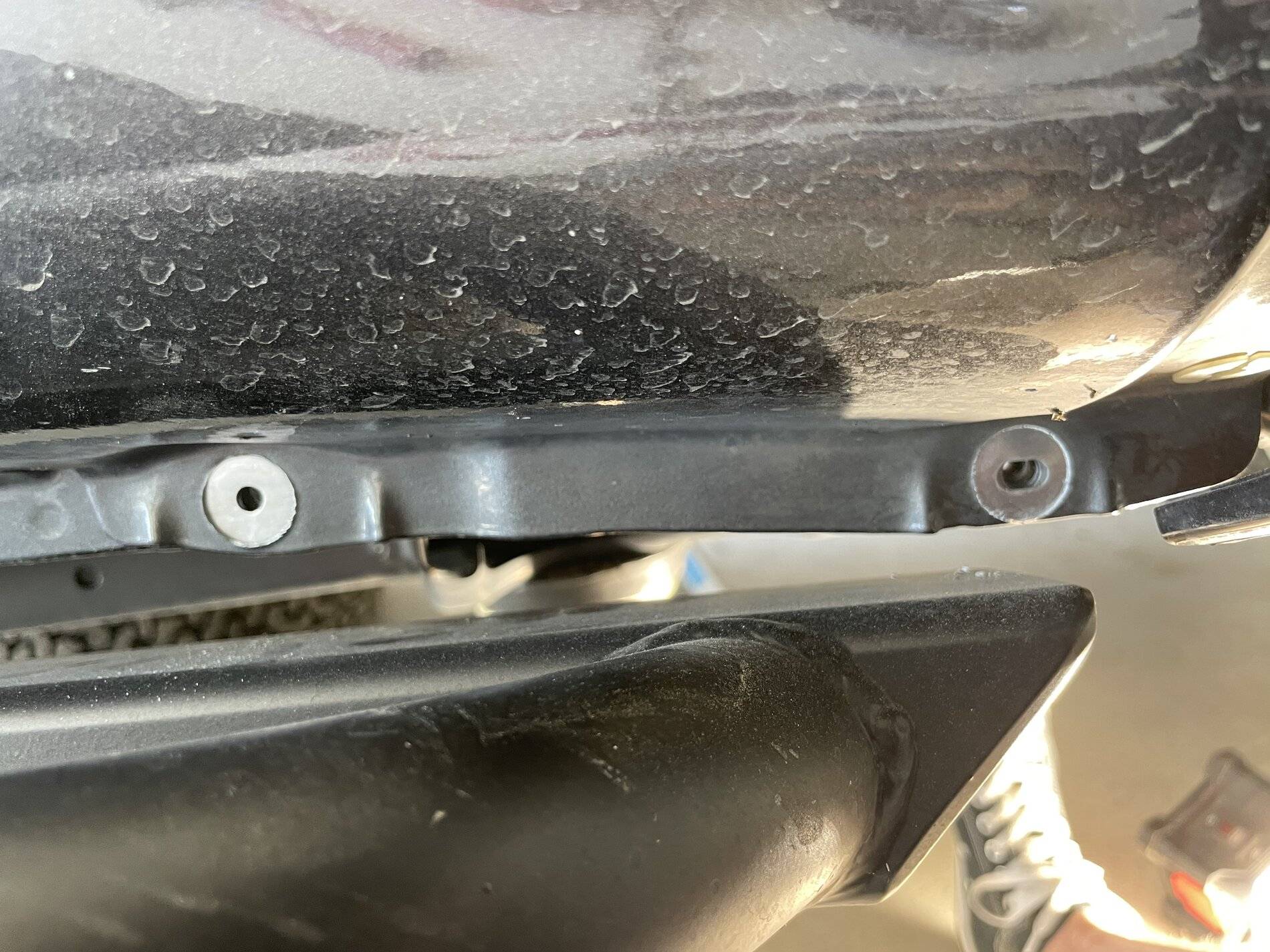

While the bumper was off I added the Baja Designs fogs and took off the little front air damns in front of the tires. I was hoping to add the winch too, but that keeps getting delayed. Truck looks pretty mean; can't wait for the rest of the parts to get here ?

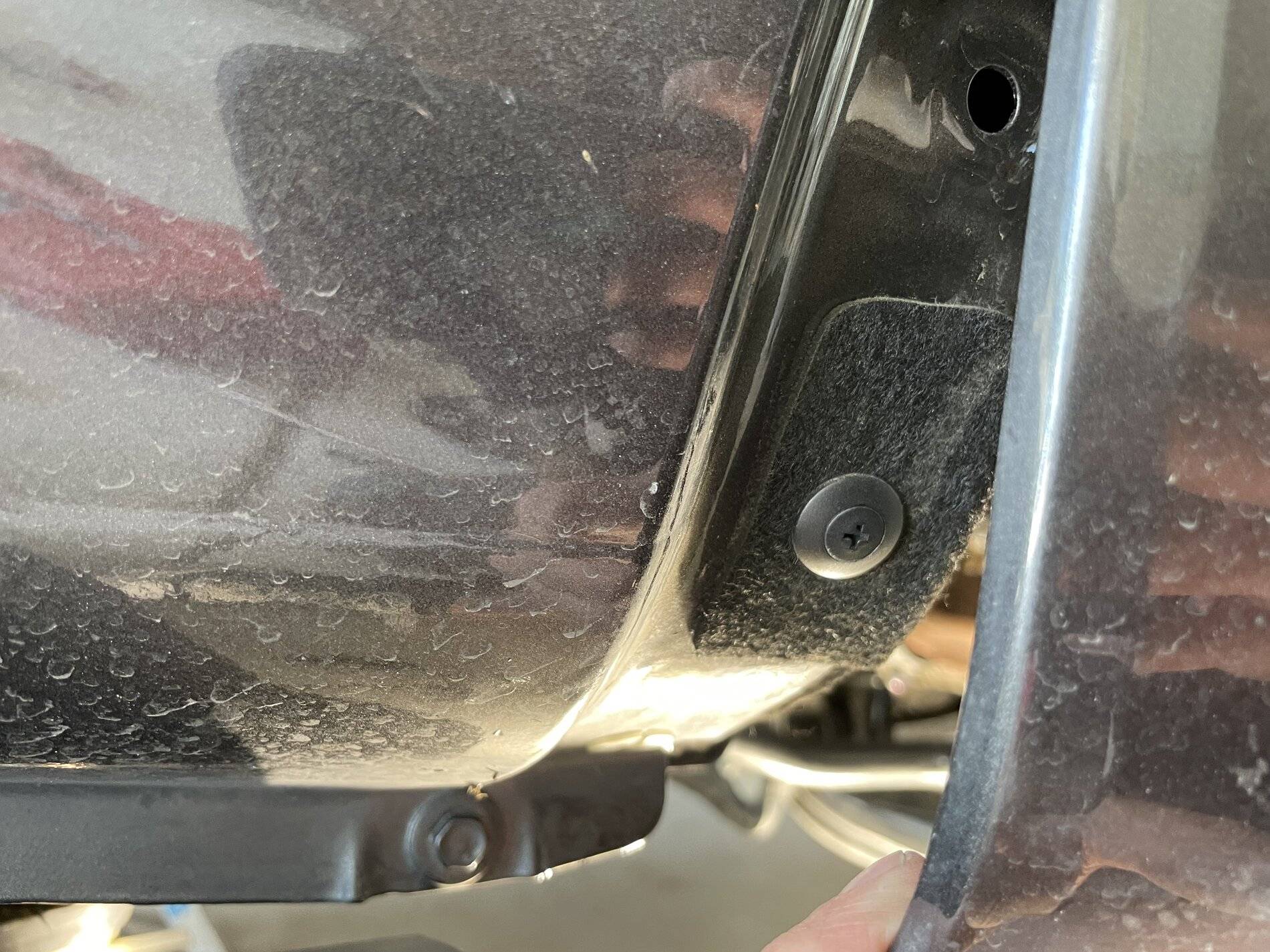

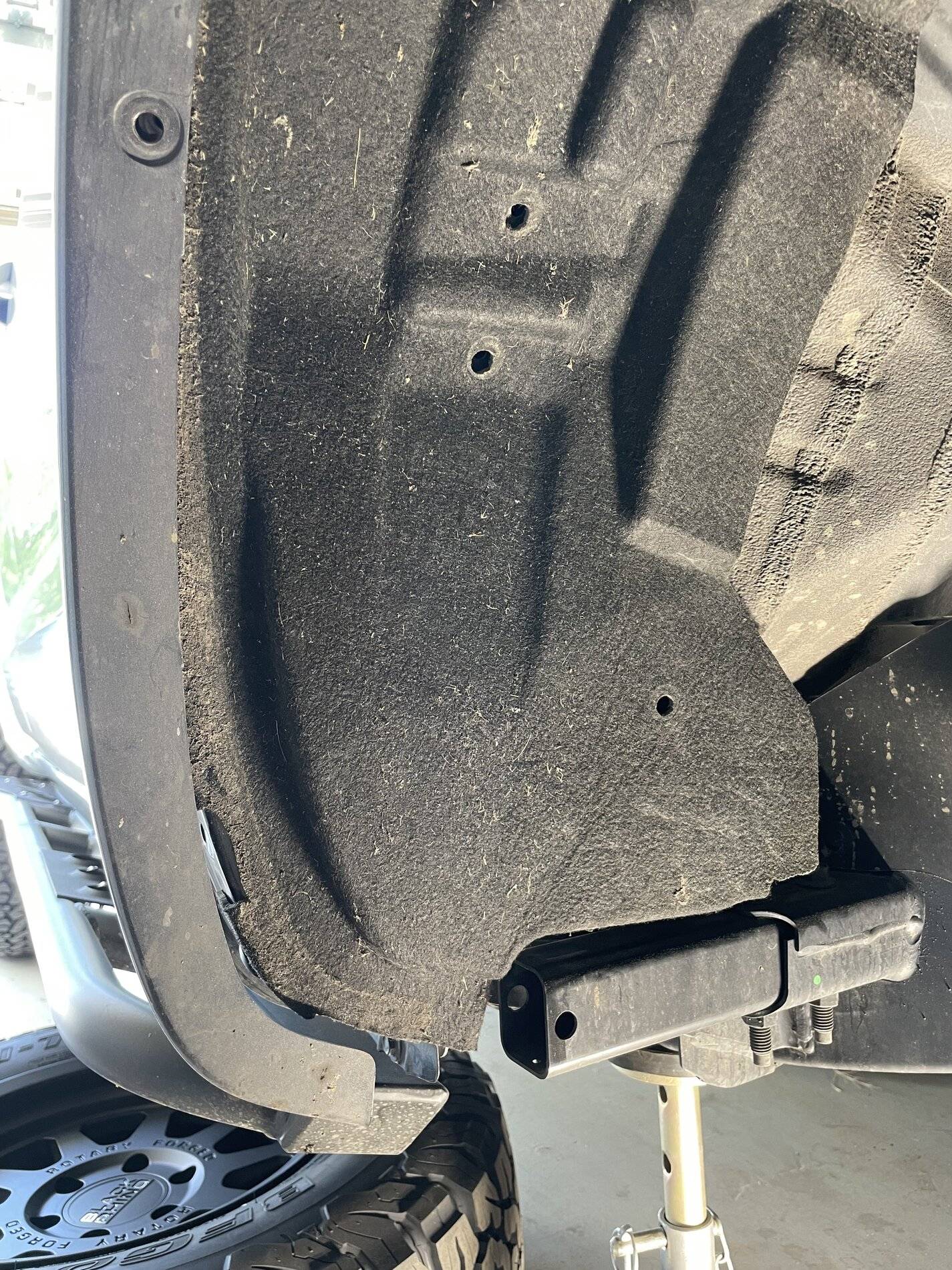

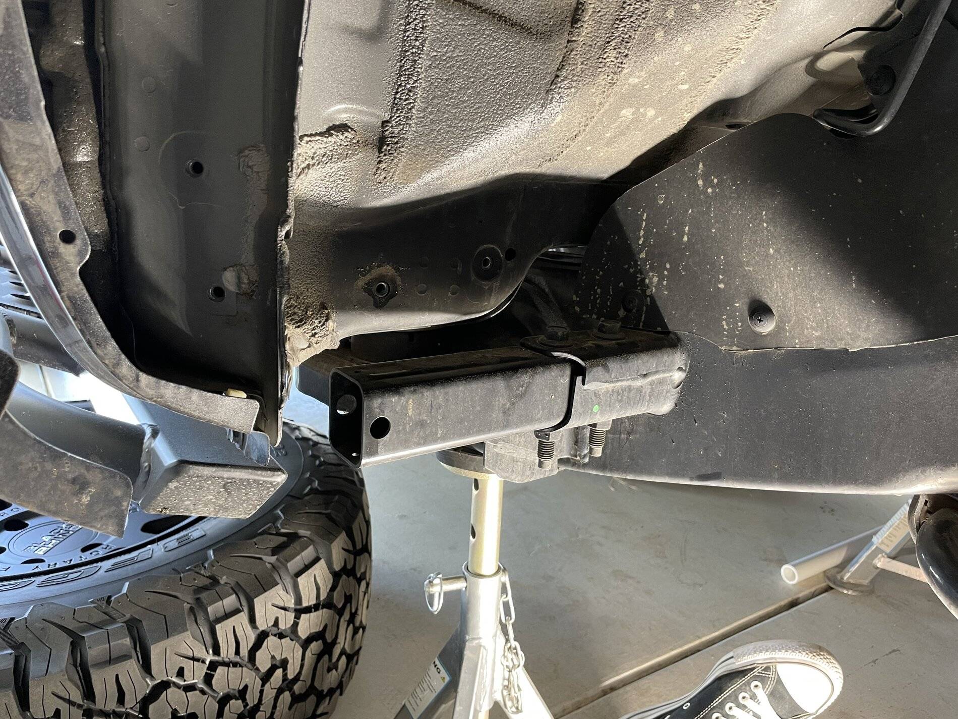

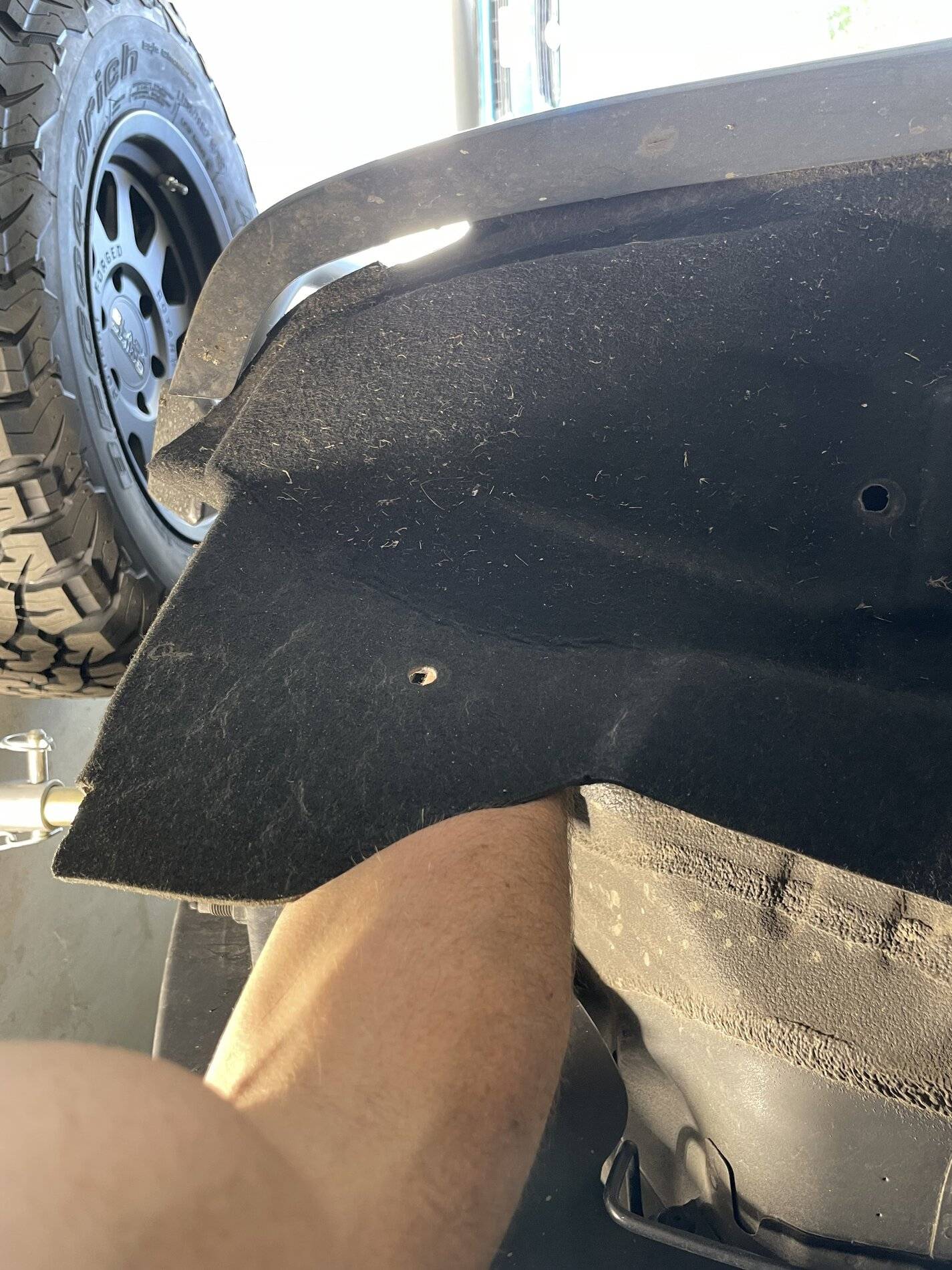

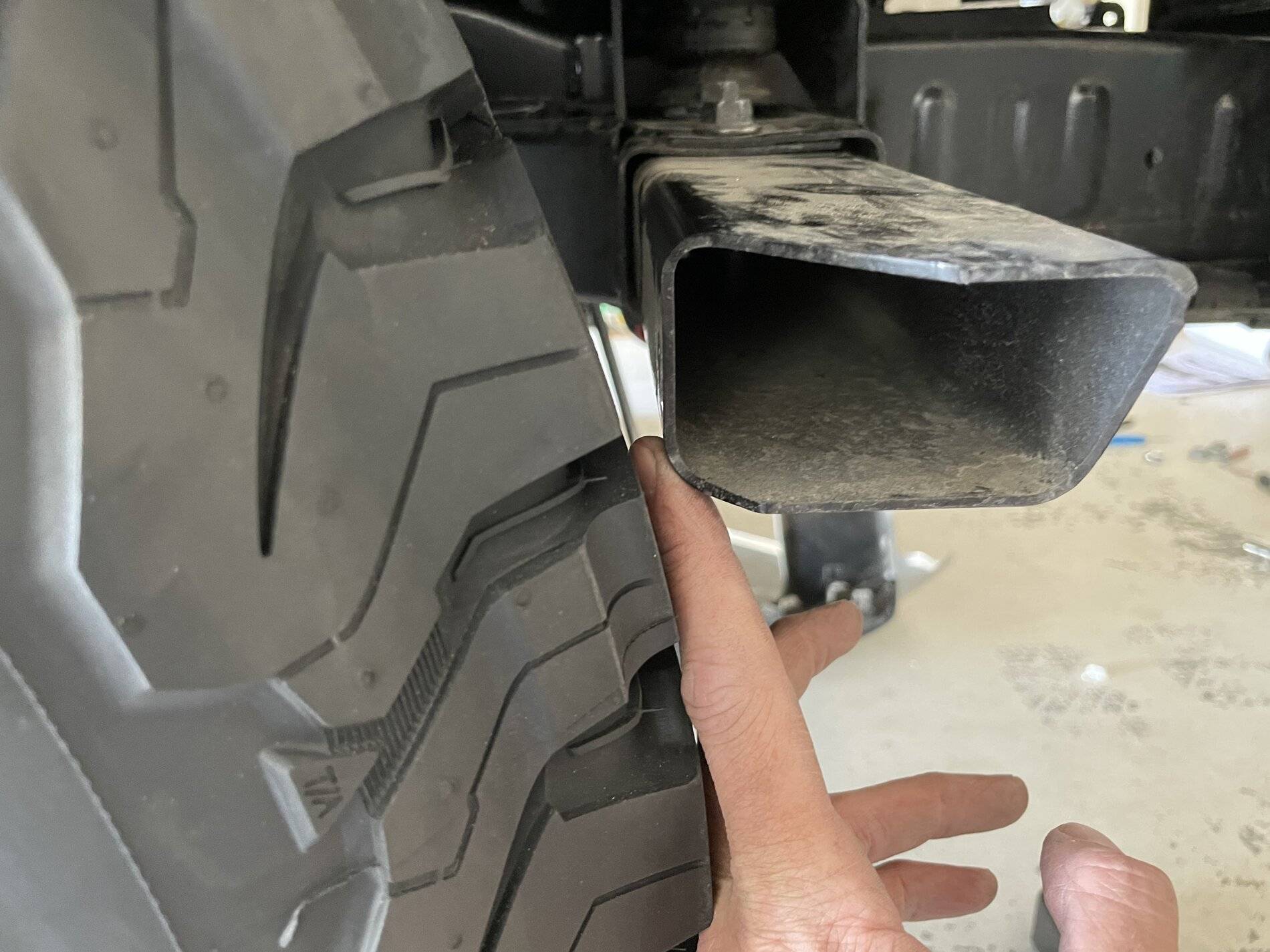

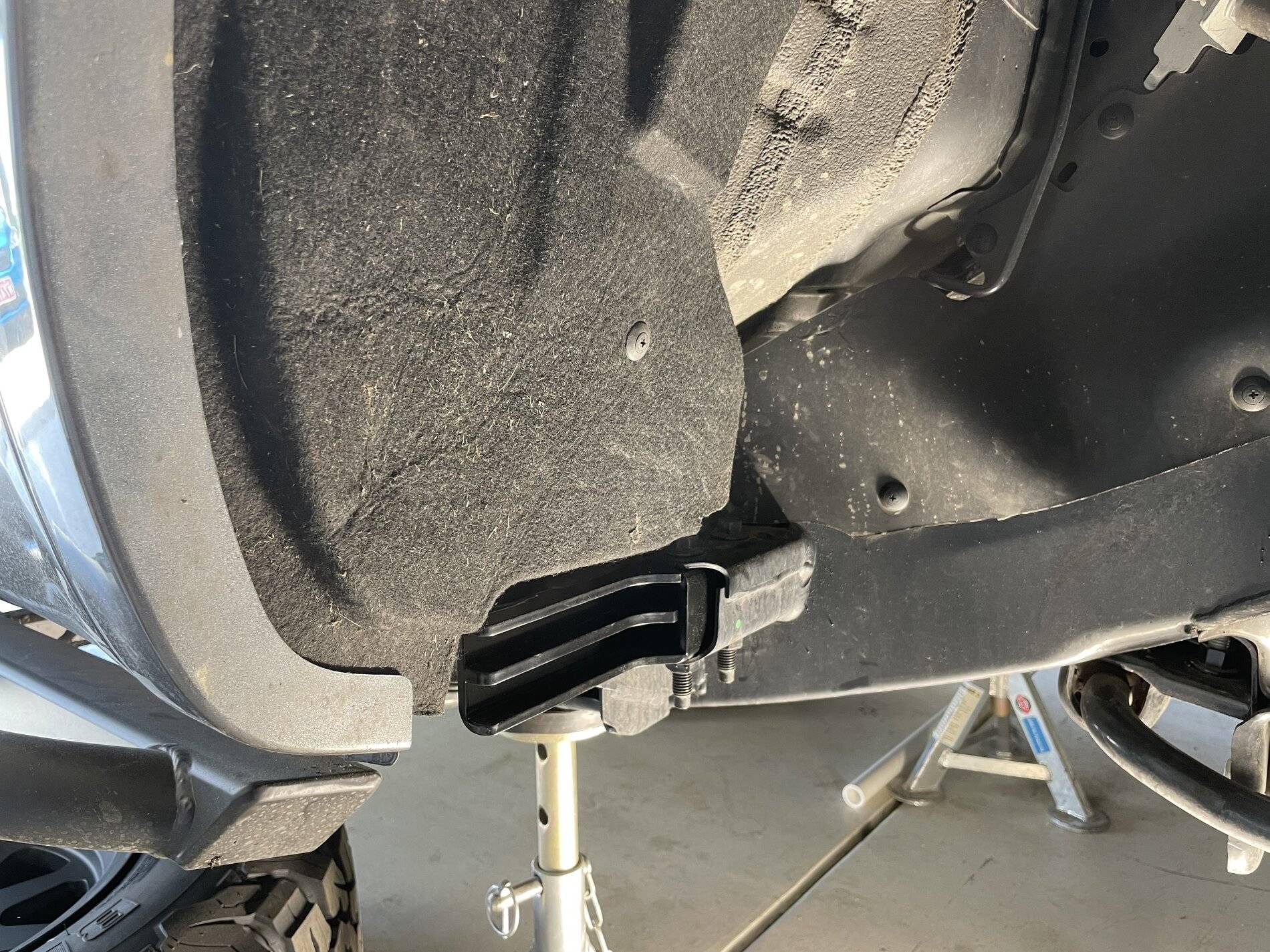

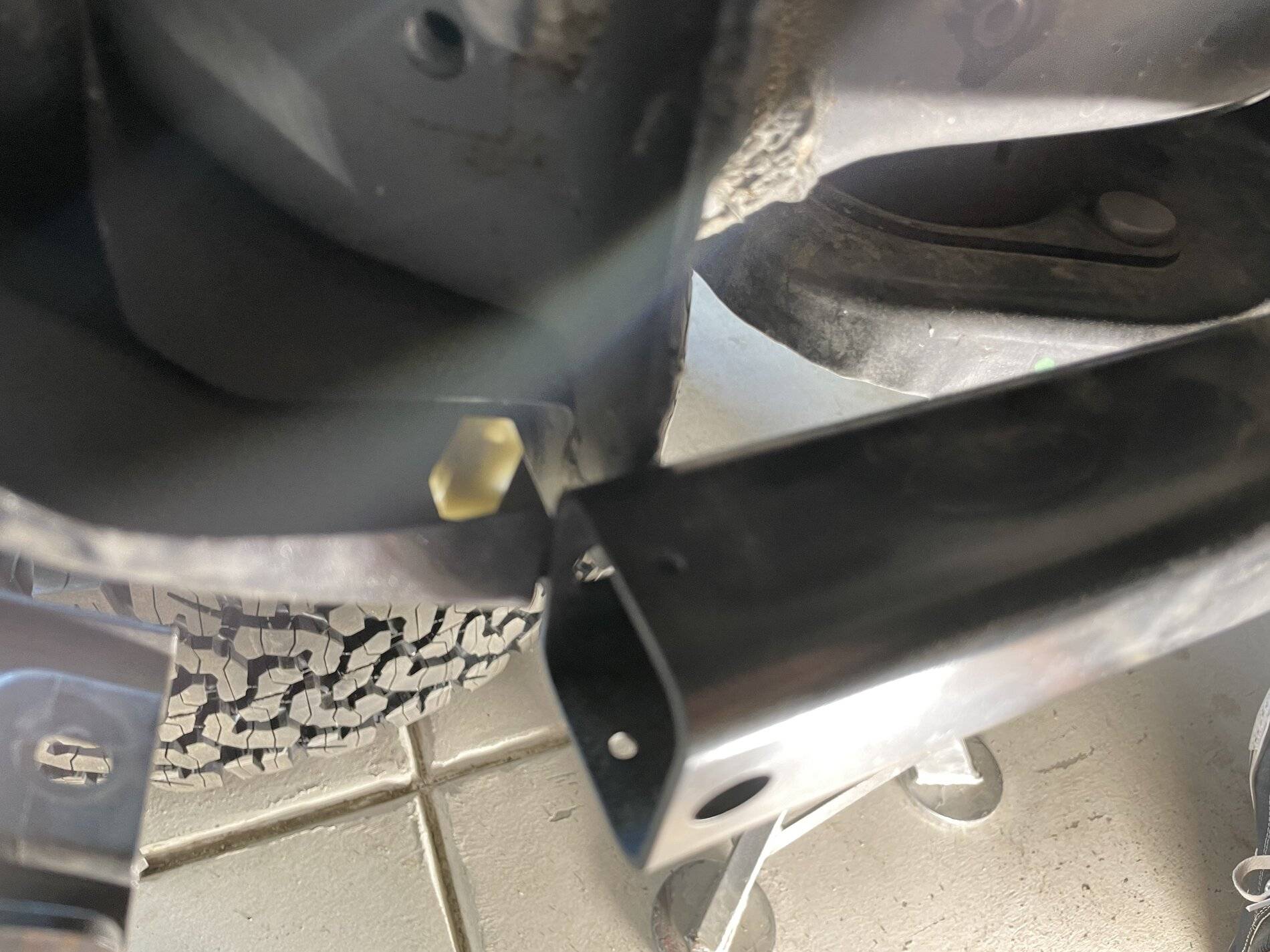

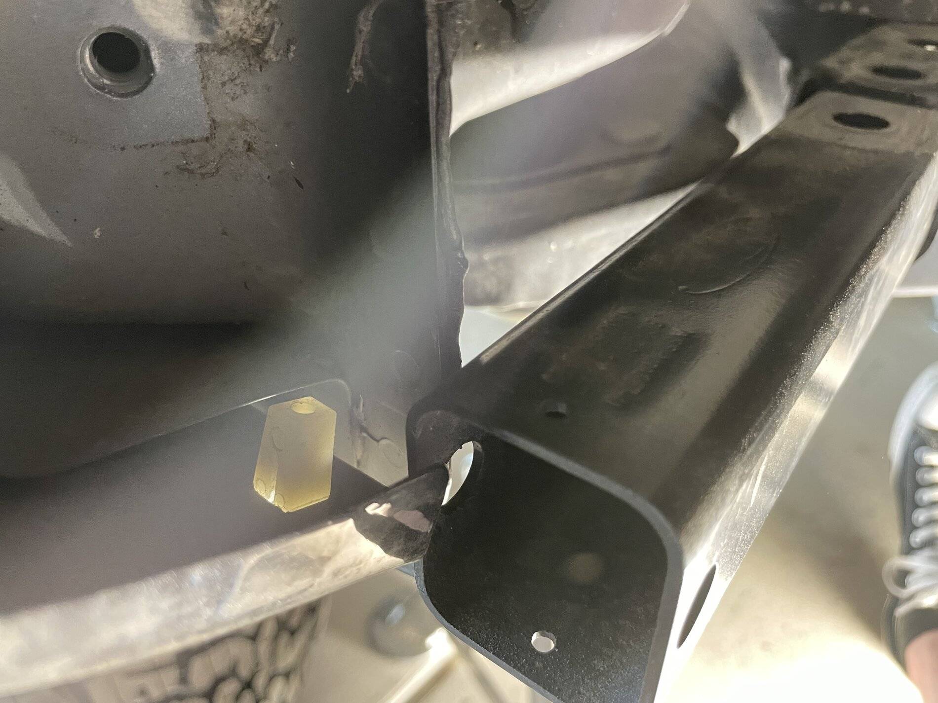

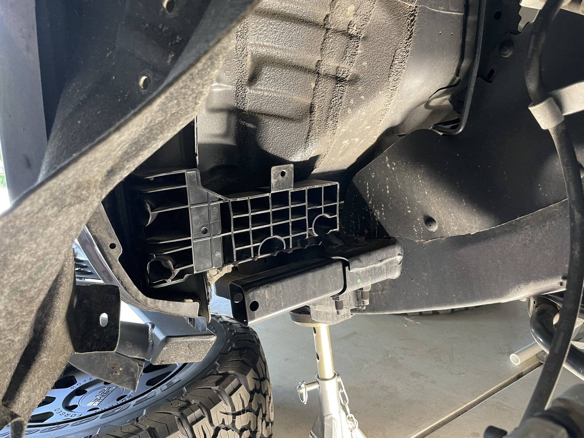

Tackled changing the rear intrusion beams to the ReadyLift high clearance ones today. I didn't have to cut anything (front or rear), and the tires basically fit. There's some rubbing on the fender liner at full lock, but I expect that'll be gone once the lift gets here.
Started by removing all the fender liner pins and the torx screw at the bottom of the fender.
Reach behind the felt liner and push out the plastic clips holding the fender trim on.
Take the clip out from the felt fender liner under the fender trim
Pull the felt fender liner all the way out of the way to make work easier.
Take out the plastic block.
With everything out of the way, it barely doesn't make it.
I unscrewed the two bolts at the bottom of the fender, not sure if this helped or not.
Using a deadblow hammer, slightly bend the edge of the fender inward. Doesn't need much! Once bent in, pull on the intrusion beam as you push on the fender, once it's past the corner you can wiggle it out.
Put everything back and button it up.
Added the fender flares, adjusted the headlights, and should be good to go. As mentioned, it does slightly rub on the felt fender liner at full lock but not bad for 285/70R17 with 0 lift :D I'll drive it around and if it rubs too much I'll switch back to stock tires until the lift gets here, but I'm pretty hopeful.

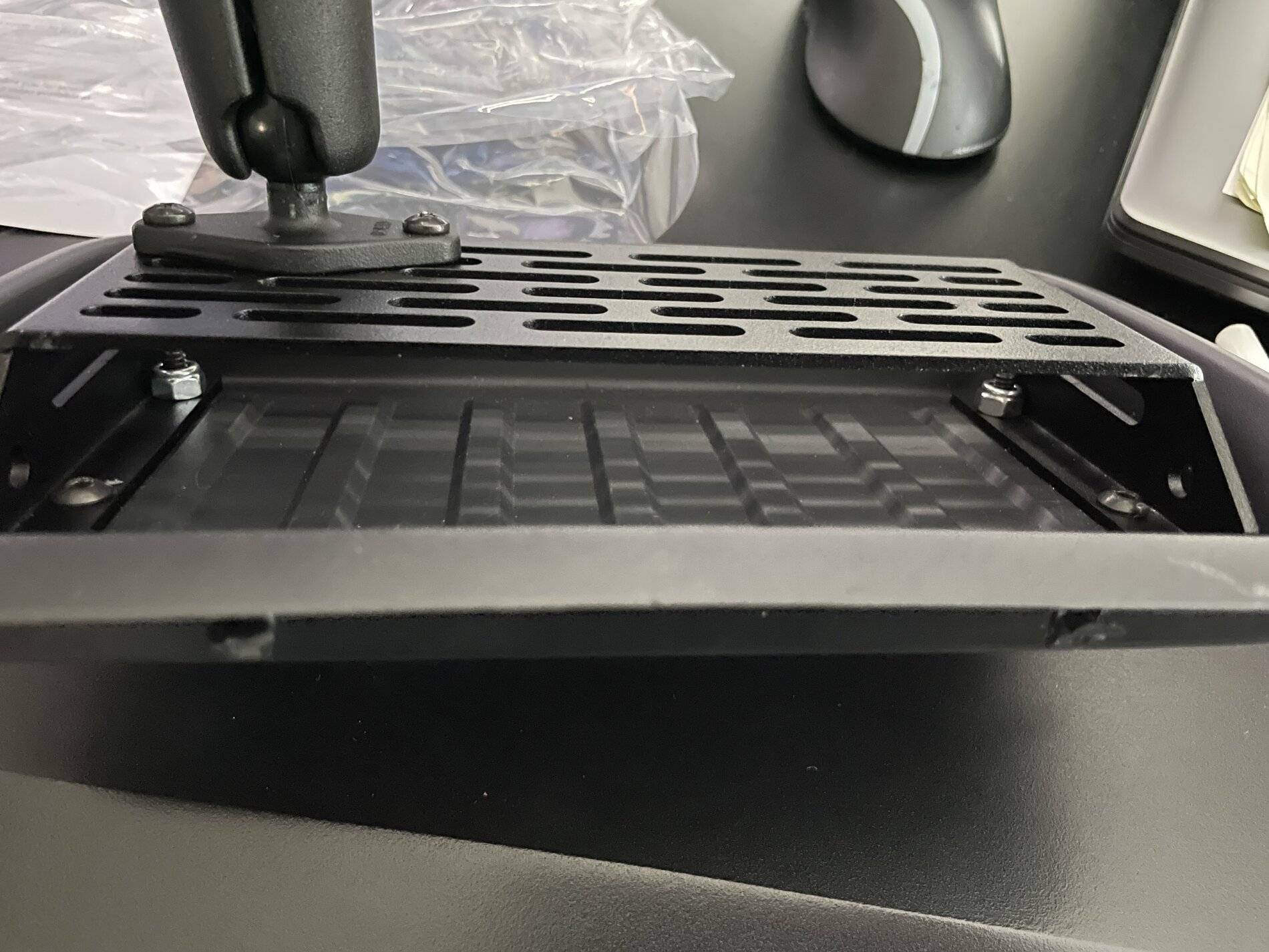

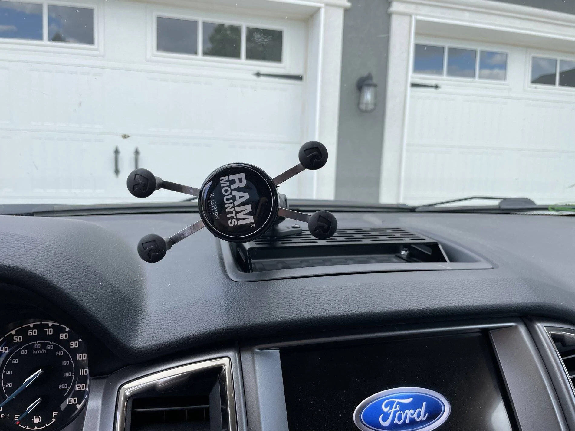

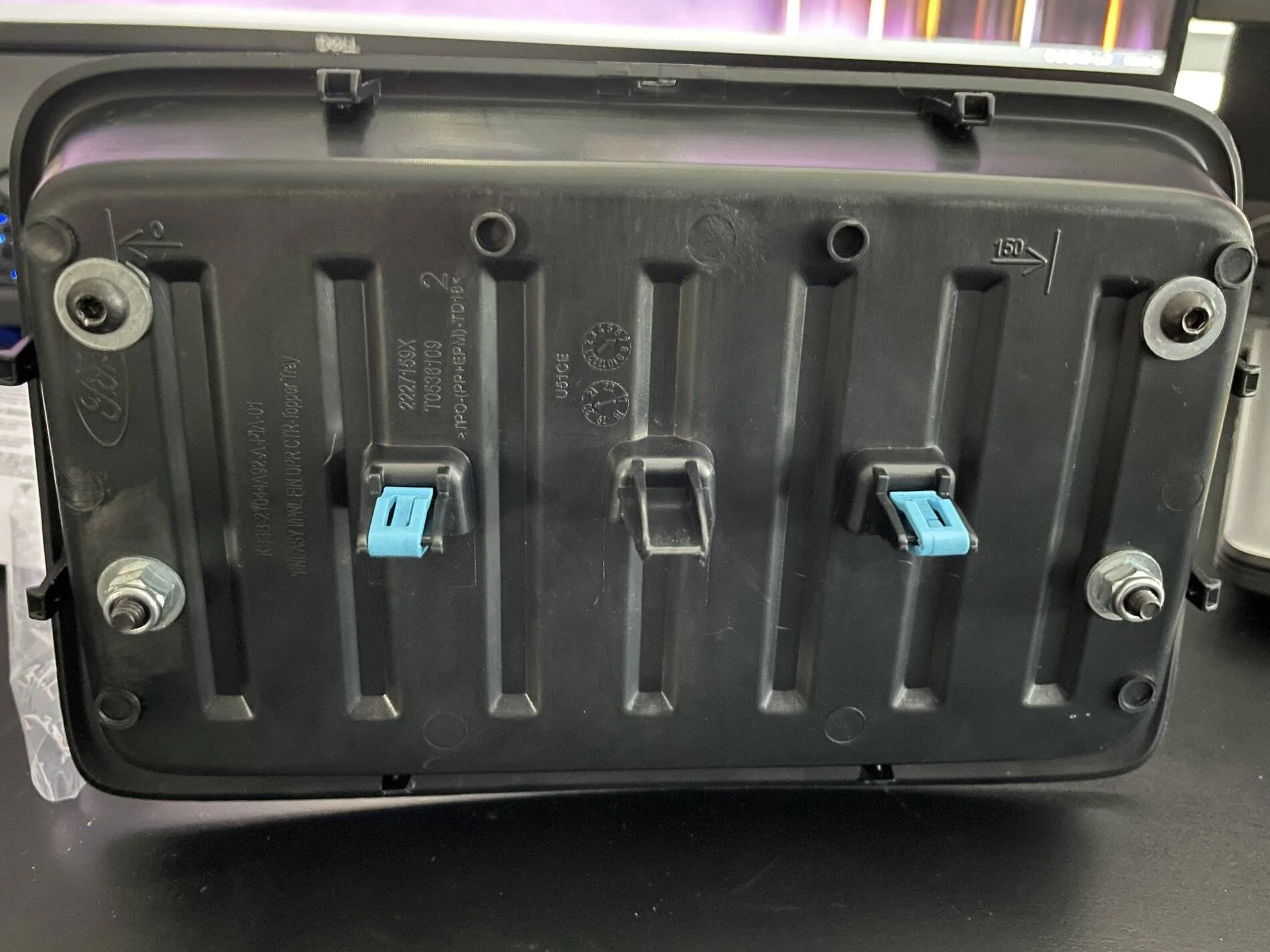

Added dash tray mount from Built Right Industries today. So far I’m happy, it'll be nice to have place for my phone that's out of the way but easy to check (for maps).
I mounted the tray toward the windshield which caused an issue with the bolts running into the mounting surface in the truck. Easy fix though, just mounted the back two bolts upside down and all is well. You can’t really see the nuts since they’re under the tray.

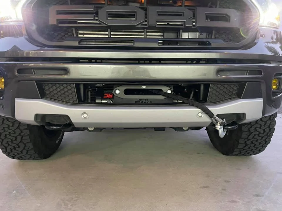

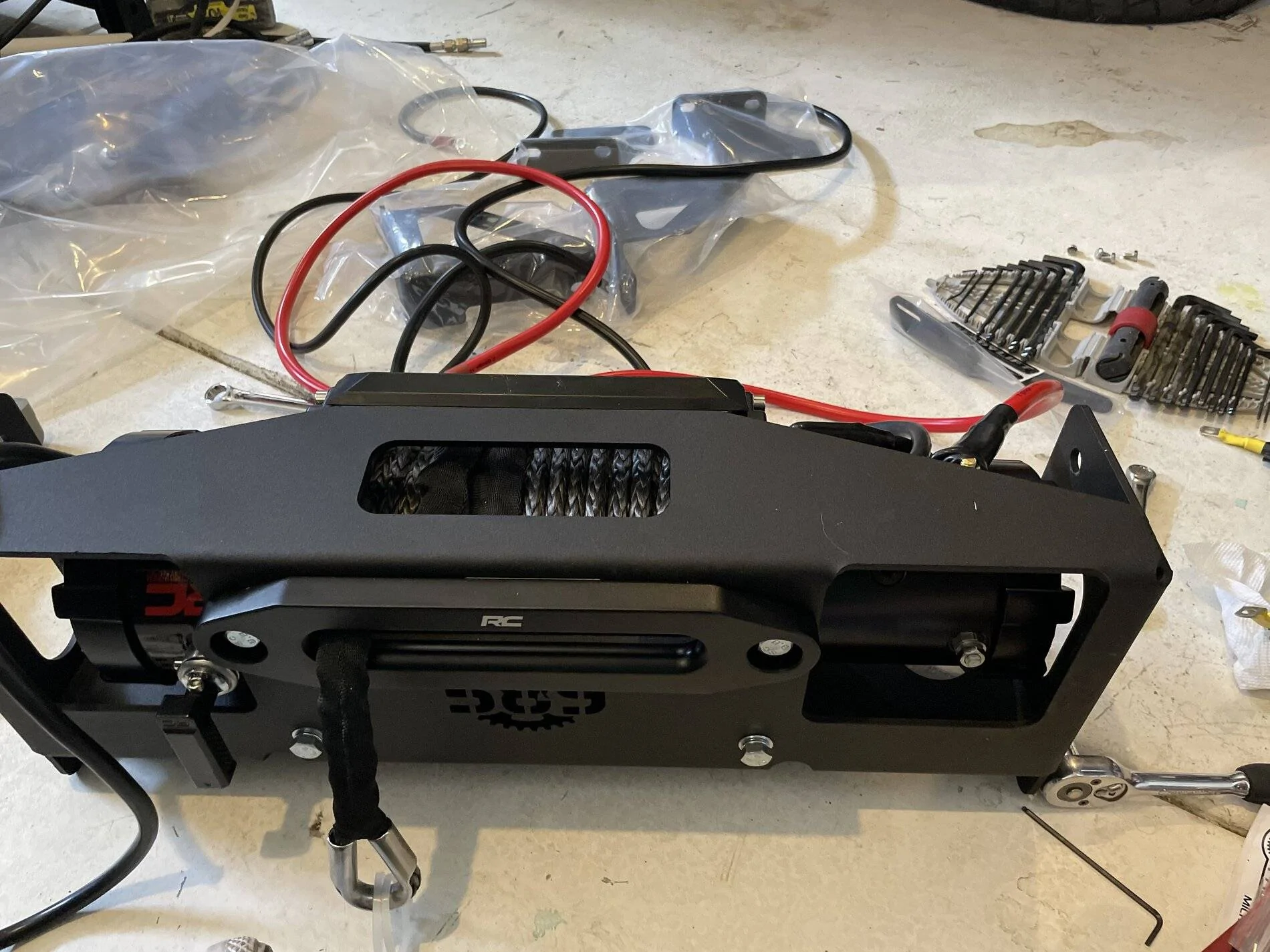

I didn't take a lot of pictures of this change, but I added a rough country 9500 synthetic line winch, 589 Fabrication hidden winch plate, and ADD adaptive cruise control relocation.
For the ADD adaptive cruise control I used 3" stainless bolts with two 1" spacers (painted black) to lower the mount closer to the bottom of the grill. You can see the sensor below the "R" and "D" in the image below. I was able to separate the wiring and had enough length so I didn't have to splice any wires (yet). I haven't moved it to the center yet, I'll try that if I run into any issues with the sensor.
Overall happy for now. I expect I'll change this up once I find a bumper with a winch that I like for the ranger.
Next I'll be adding a thimble to the winch line once I get the lift complete.
