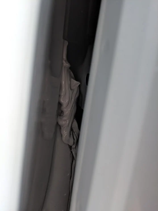

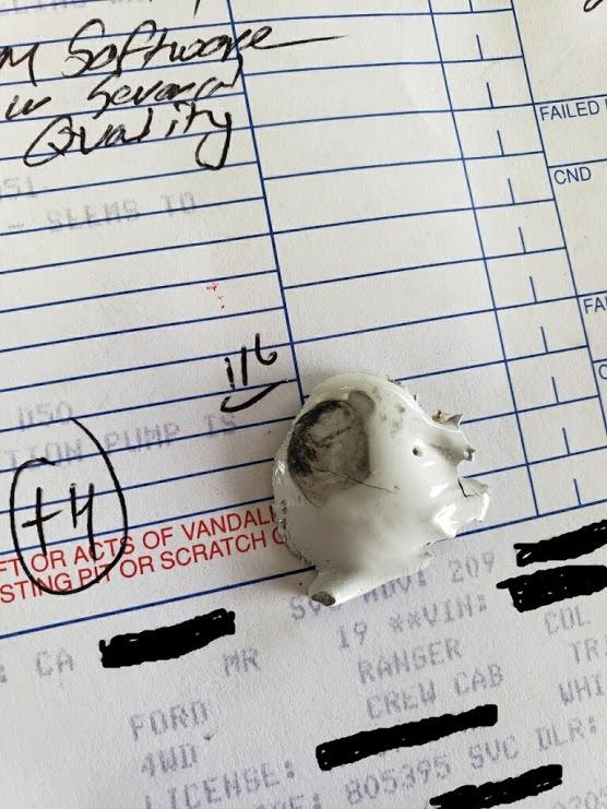

Funny this thread should pop up today, I have my ranger currently in service for a few warranty issues and one of those issues is clicking/creaking sound from left rear side of the cab. You can hear it on the inside of the cab. I noticed that when it rains it seems to quiet down. Well, my Ford dealer found the issue (they are always great and extremely helpful). Perhaps this is what you guys are hearing, there is a sealant/mastic used on the bed. That sealant/mastic was used in great excess and it was rubbing against the cab. Since the cab and bed are separate, whenever the I went over even the slightest of rough roads it would rub. It really sounds like it is in the cab but it is, at least in my case, on the outside between the bed and cab. I attached a couple of pics to give you an idea of what it looks like. Take a look and see if this is whats causing your noise.
Looking in between the cab and bed from the side of the truck.

This is what the tech removed. you can see the dark spot where it was rubbing.
