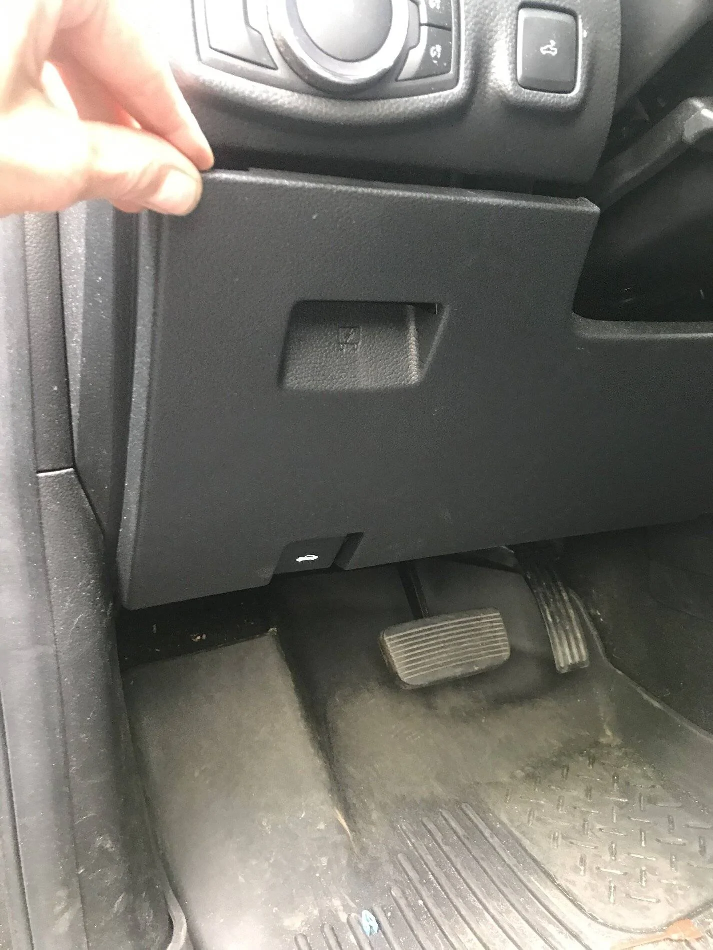

1. With the rear seat head rests so close to the rear window how do you clean the inside of the rear glass? I looked for a release for the seat back but couldn't find one.
2. On the dash right below the hradlight switch is an opening that looks like it would be a release but there is nothing inside when I stuck my fingers in?

Welcome to the forum George from a fellow Scab owner.
1. The headrests are removable. Base of to rods there’s buttons you need to push to release them. Many of us removed them as the block rear views. If you have kids then I would keep them. There is some threads on here about them. Possible tilt mod you you got an early enough one. Otherwise you might have the non tilt.

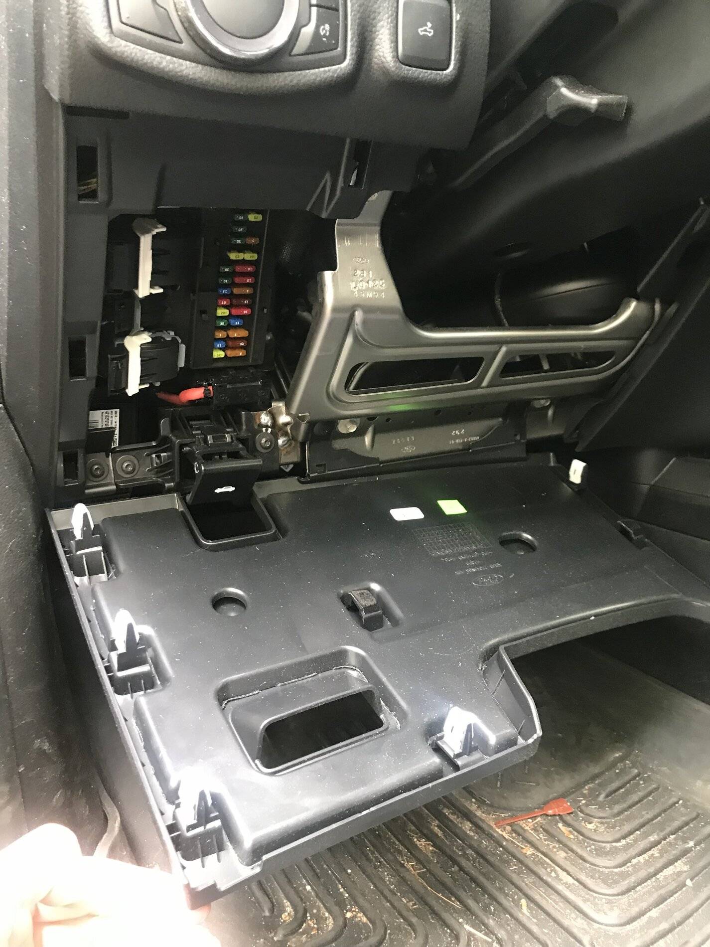

2. give that little hand pocket a straight out pull and it will allow access to fuse panel. Much nicer than what last Gen Rangers had

Nice access to the fuse box.
Thanks for posting this photo. I have yet to need to do this... but now I'll remember how to access this.
