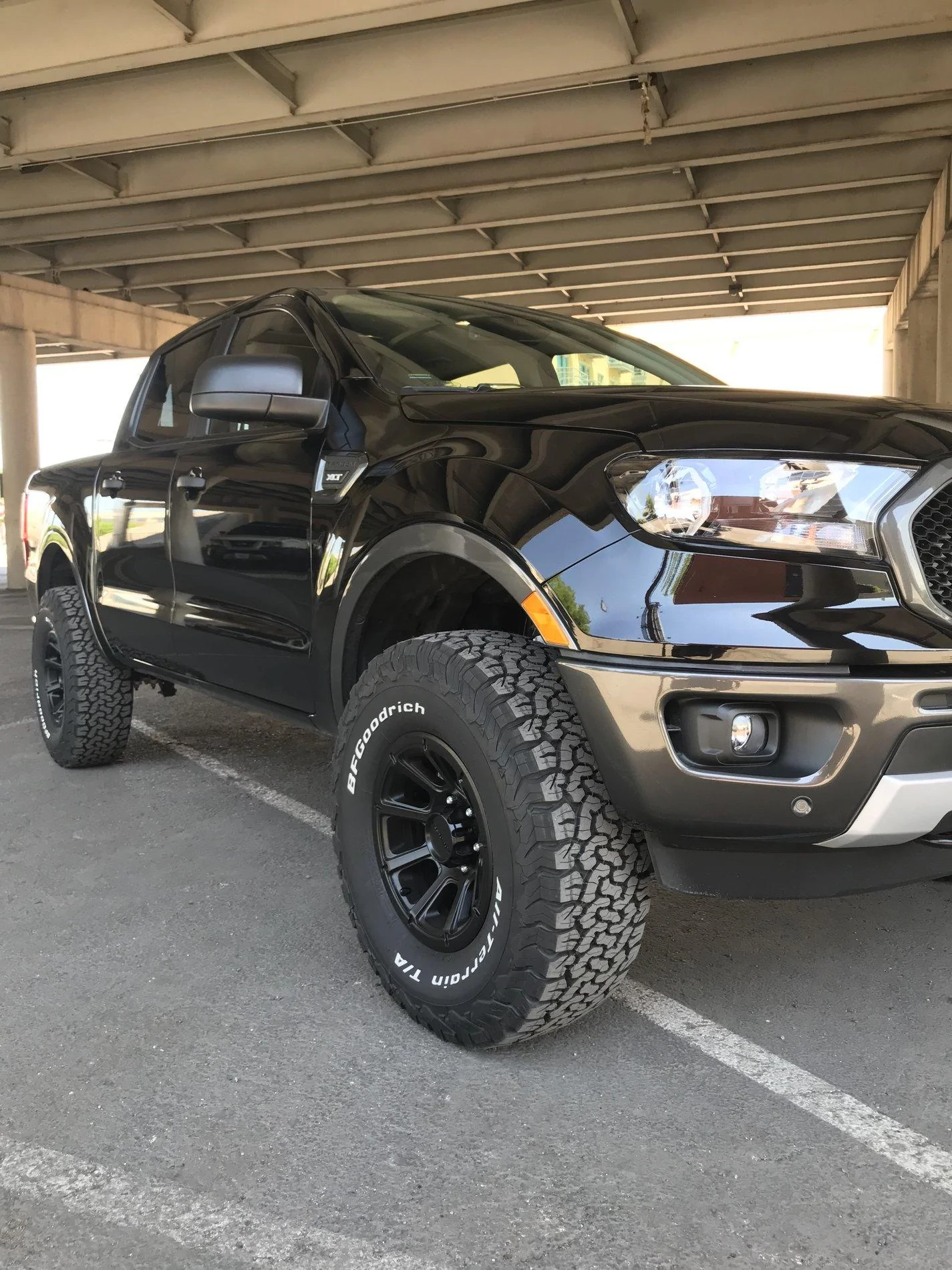

Here he is Tiger Woods, GF gave him the name. Purchased same week he won the masters and we will leave it there
Looks great! I'm also a BFG A/T fan. Have had good luck with them on my 93 F-150. Great in snow. Paws like a Tiger. Yea, when you have some time would be nice 2 know some details but wheels & tires look nice.

Rough Country 3” level kit. BF 285/75/16 on a Vision 16x8 wheel, 0 offset, 4.5” backspace. Kit cost $500 installed, tire/wheel package $1600 thru Discount Tire. Had to cut crash bar even with lift

Thanks for all the info.

Great looking setup on a very capable looking rig! Thank you for your patronage!

Can't speak for the wheels but I have always preferred the white letters out!!
That said it would look better if it were Firestone's over BFG!! ?

Do you have some more pics to share? Also wondering how much clearance there is between the 16" wheels and brake calipers?
16" wheels are standard on the base XL so there shouldn't be any problems.

i like the 16s better. tires and wheels cost a bit less in some cases and you get a more cush ride from the tire off road.
