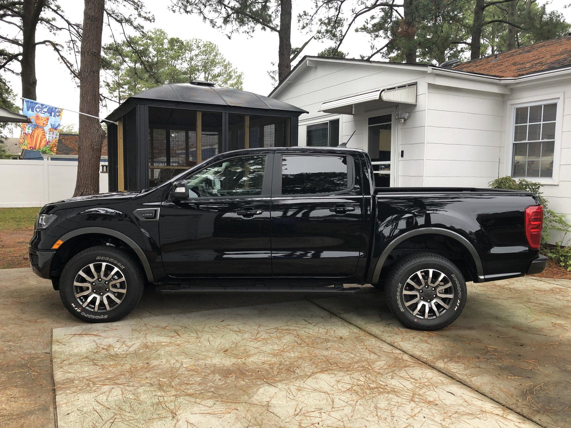

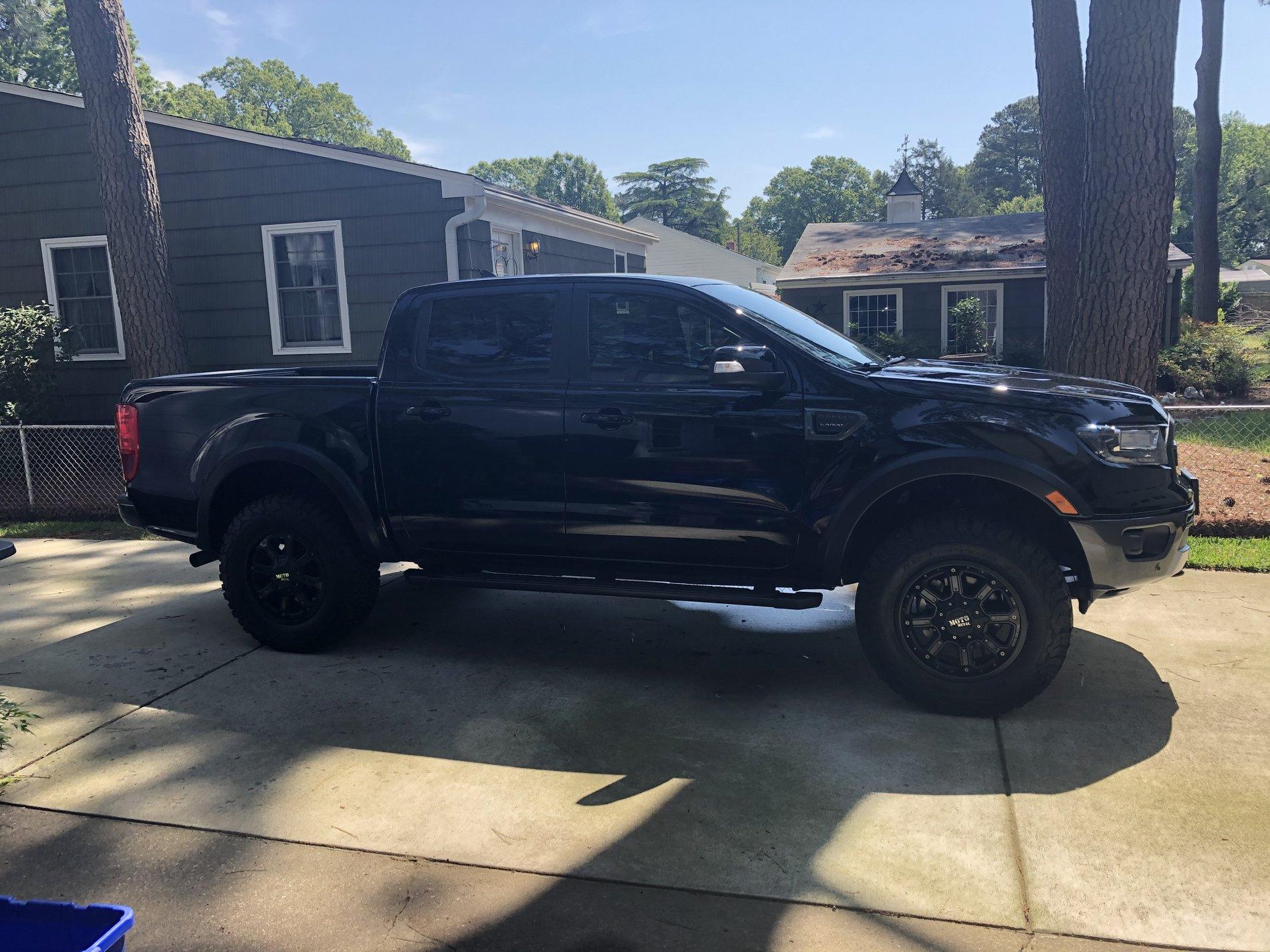

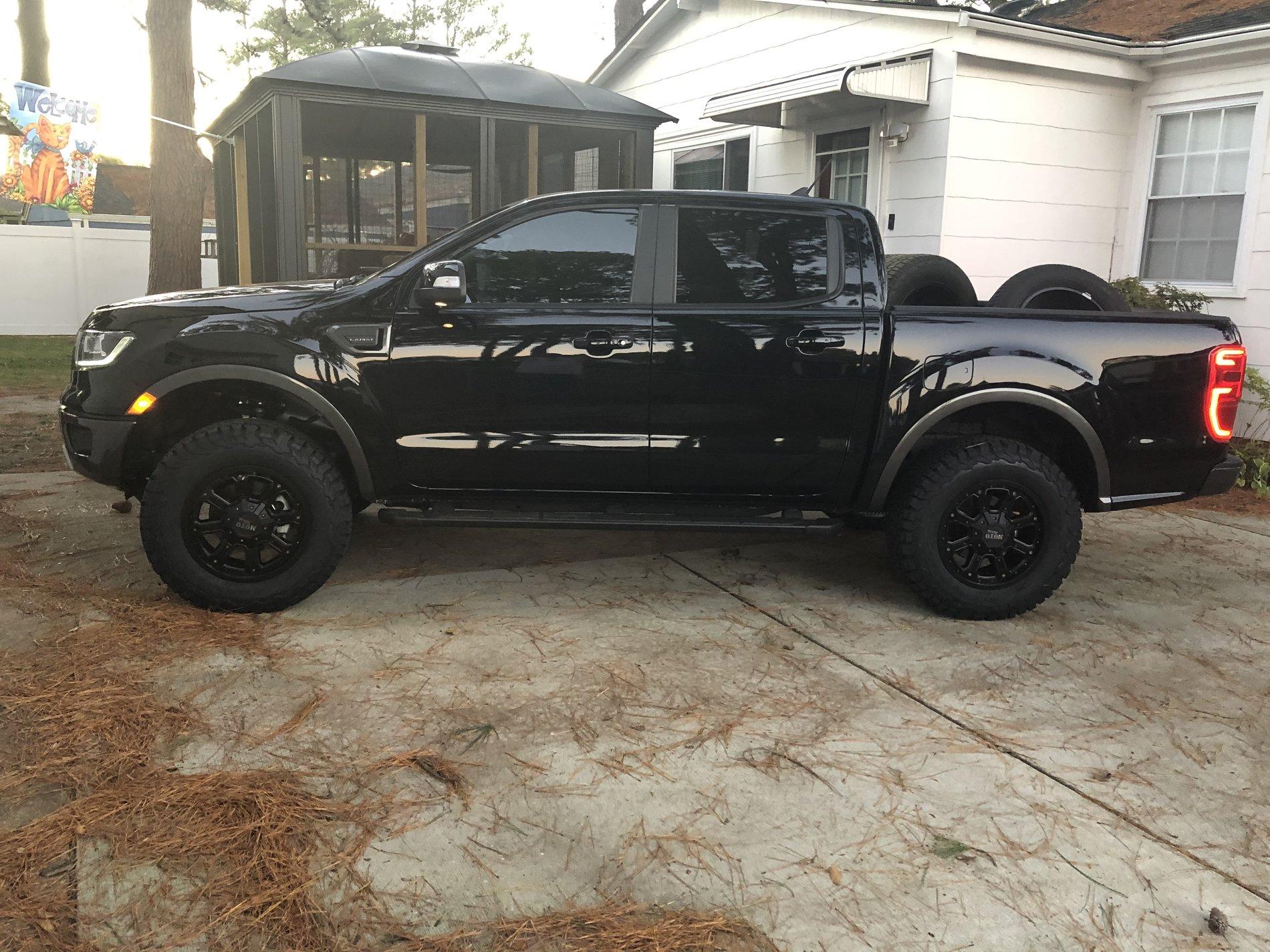

Just had my 2.5" Rough Country leveling kit, along with BF Goodrich T/A KO 285/65R18 and Moto Metal 984 +30mm installed. Only had to remove the plastic covers that are on the crash bar, no cutting and no rubbing.

Truck looks great! Big difference in the before/after shots. :like:

Thanks! The part number is MO98489062730, Moto Metal Shift 984 18x9 +30mm offset

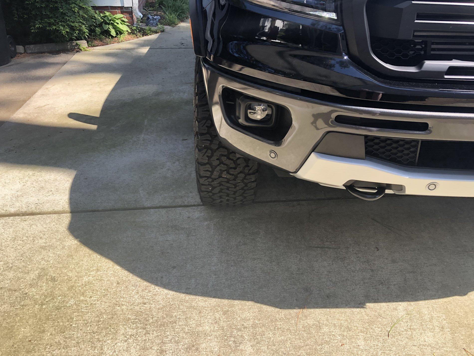

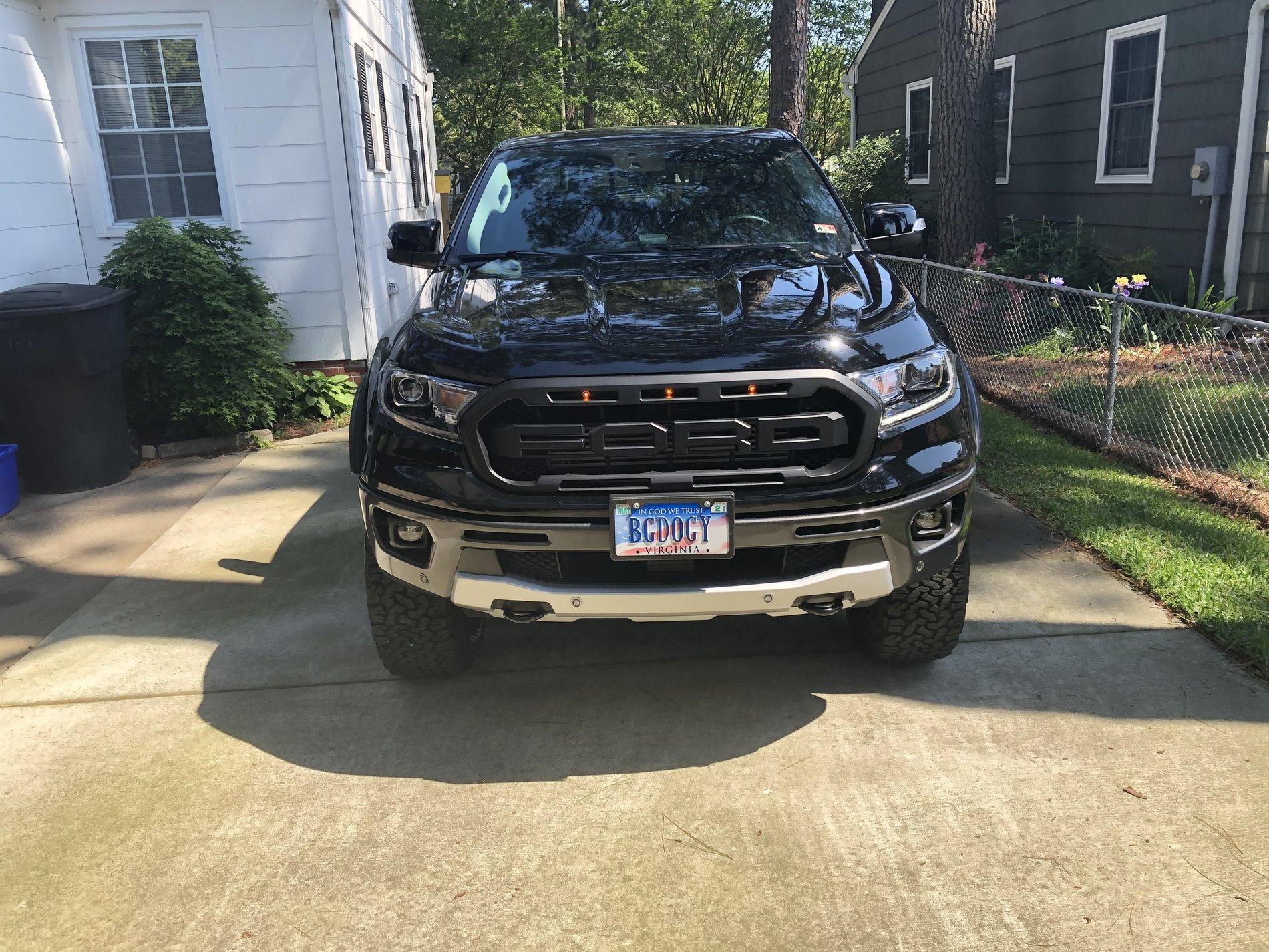

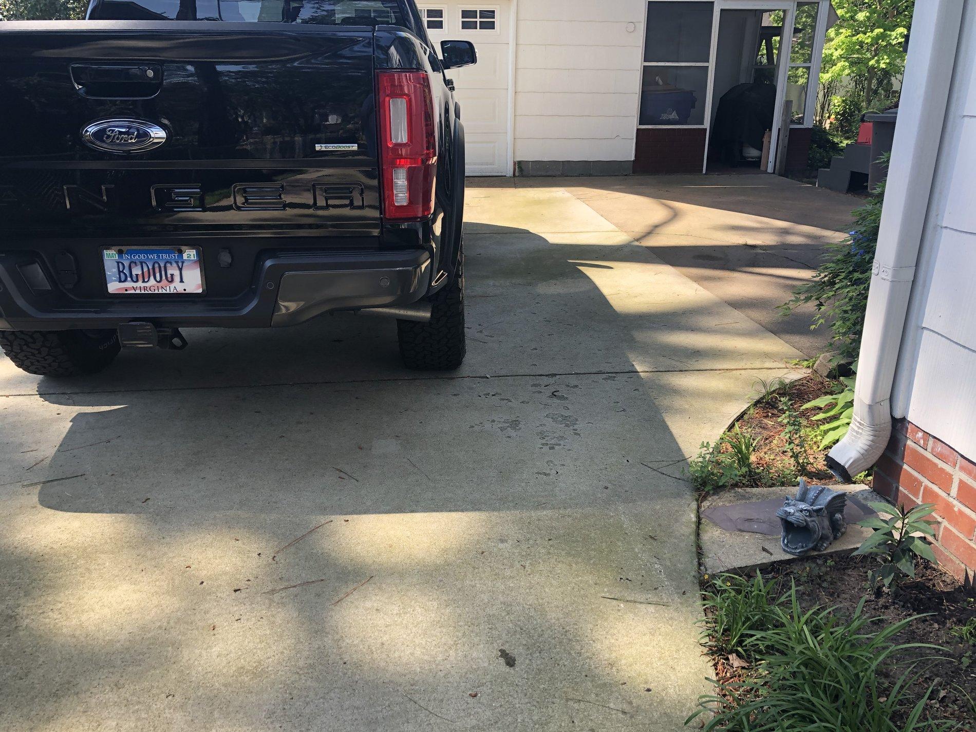

Looks good. Have any pics from a different angle or the front so it shows how the tires are tucked in?

As soon as I get it back from the shop again, I'll get some pics for you. They have had my truck for almost two weeks fixing the leak from the back window, waiting on new carpet to come in.
