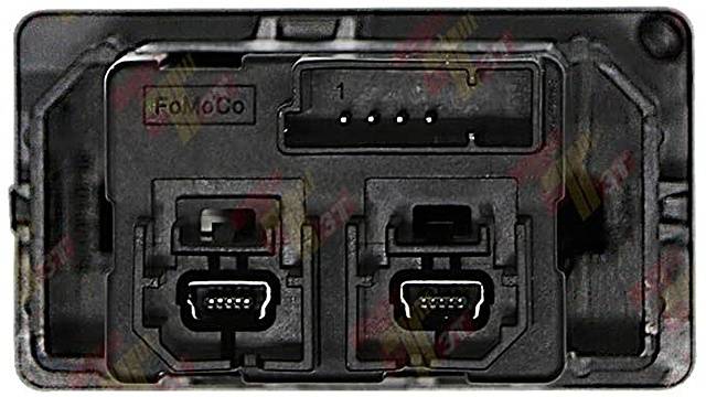

The ports in the lower dash are directly connected to the head unit.
It will look something like this.
When I had mine apart there is a connector at the top that supplies power for the ambient lighting and a single mini usb for charging and CarPlay / Android "whatever they call it".
The USB connects directly to the back of head unit to another mini USB port.
You either have a bad cable, loose cable, bad lower port, or the really bad scenario a bad port on the head unit.
It's easy enough to get to the lower port. Remove the left and right lower panels next to the 12VDC power panel. Remove the two bolts holding the 12VDC panel and remove. From the back push out the USB port. It pushes out towards the gear shift and is clipped in place. Get a mini usb to "x" USB adapter or another device that uses mini usb and test functionality. If the cable works then you have a bad port, or it was loose to begin with. Otherwise you will need to get to the back of the head unit (pain in the ass) and test from there.
If the cable is good you could test putting the cable in the other port. They are tied together.
This is exactly what I was afraid of doing haha. Pulling apart the wires from behind the unit is something that I’m not too comfortable with (my expertise is fab work). But it does sound like the logical thing to do at this point. Thanks a lot for the info!
