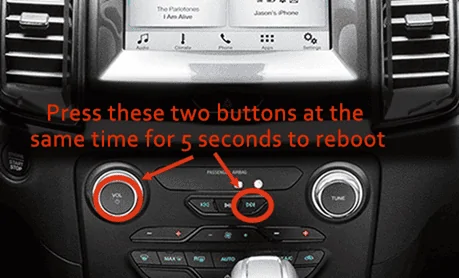

Paul, if the problem you are having with your audio is that it stops, especially when listening to Sirius, it is a well known problem and there are many threads on this (Google Ranger Sirius problems). The final fix was to update to version 21194. This cured the audio issues and also fixed problems accessing traffic, weather, fuel prices, etc. For a quick temporary fix, do a soft reset of Sirius.
Edit: How to do a Soft Reset of Sync:
SIMULTANEOUSLY (at the same exact time) press the Scan Forward button (>>) and the CENTER power button (audio system power) and HOLD them in for a little more than 10 seconds. The screen will go black. RELEASE the buttons at the black screen. System will then reboot.
