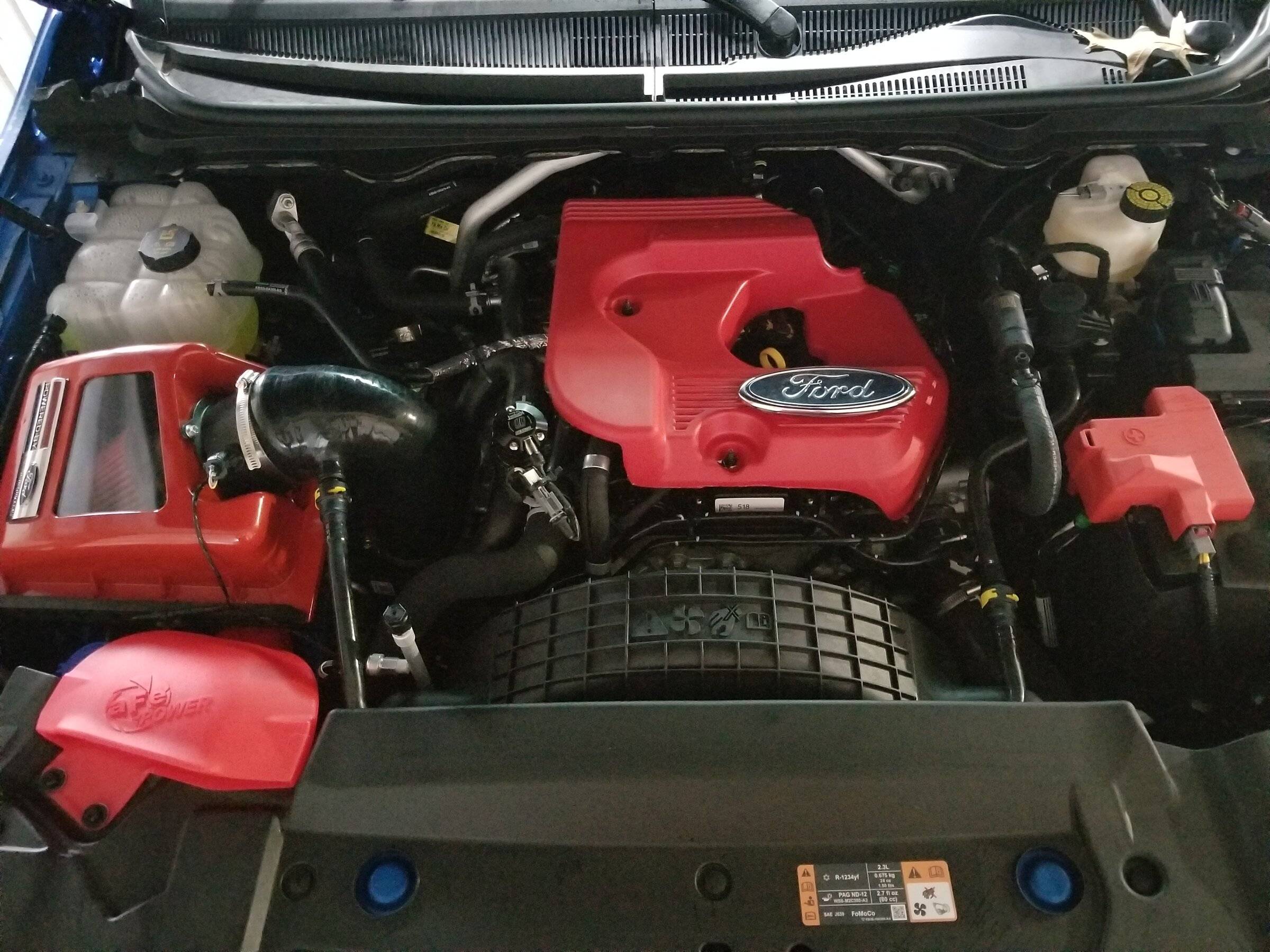

Turbo smart bov, cai, engine cover, afe scoop. Borla exhaust. Getting ready to change the b&o out next. Then level and bigger tires.
Looks great. Question: what product did you use to paint the engine cover. Yours looks better than most attempts. Thanks
I used a foam primer from hobby lobby first. To stop it from melting. Then used plasti dip because it flexes alot better then standard paint. So far so good and has stood up to heat.

Nice job ICE - it really looks great. Also, tell us more about that CAI - looks like a Roush with a makeover.

Thanks, yes it's a roush with a makeover. I used plastic paint promoter on it. I replaced the the roush plate with a ford performance. I wanted something different. I'm pleased with the contrast and moving on to some graphics on outside of truck.

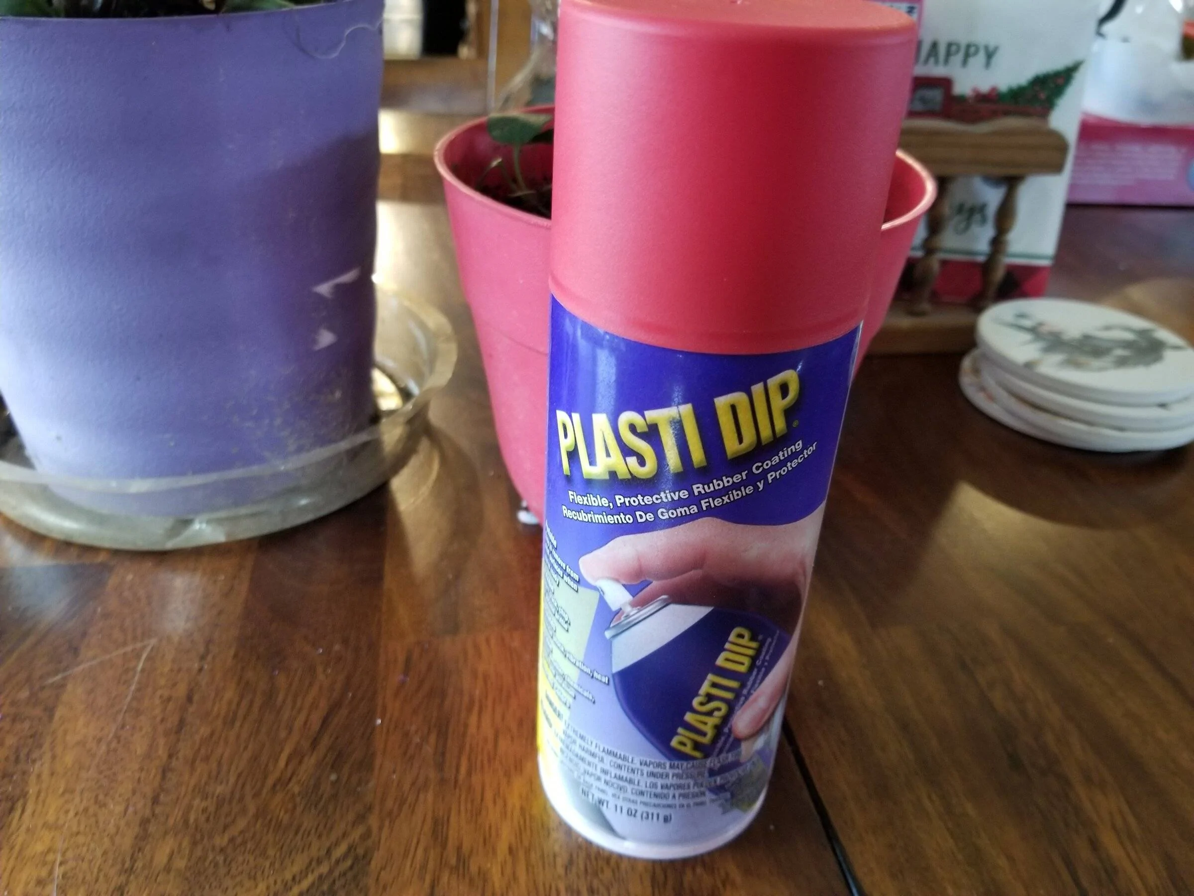

Does that plasti-dip come in a spray on? In my day it was literally....you dip it in. Thanks and great build going on there!
ICE 27
ICE 27
H
Jul 27, 2021
141
280
Illinois
2021 ranger tremor
Ret tech
It's a rattle can. I ordered it from Amazon. Used it because the foam is flexible. I figured enamel or acrylic would crack.
