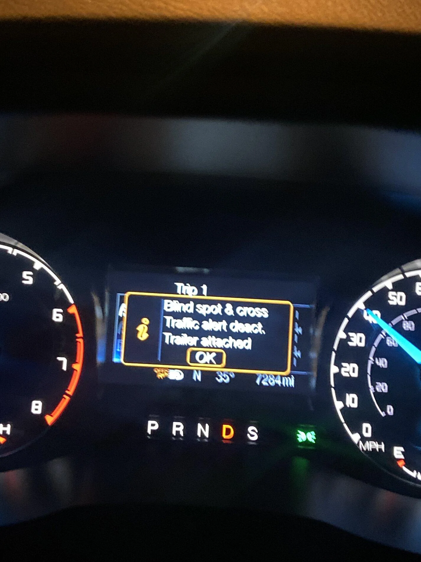

After finally scheduling service for my ranger . I am starting to get frustrated with another issue it keeps shutting off my blis says I have a trailer connected and then a few seconds later detaches not sure if it matters I don’t even have a hitch to haul anything let alone the tow package

are you the original owner?
anything aftermarket tapped into wiring ??
it sounds like a connector problem somewhere back there
Original owner bought last February. Nothing at all all factory stock. I don’t tow anything and have no need to

You don't happen to have a light bar or anything plugged in to the trailer connector do you? Even without the tow package you have the 4 pin connector. UThis will make the truck think a trailer is plugged in.

Nope nothing back there

Check the unused trailer 4-pin connection under the rear bumper...I believe there is a rubber flip up cap to protect the connectors...maybe its off and dust dirt causes it to think there is a trailer? Worth a try? The dealer will most likely re-boot the electrical system/computer.
