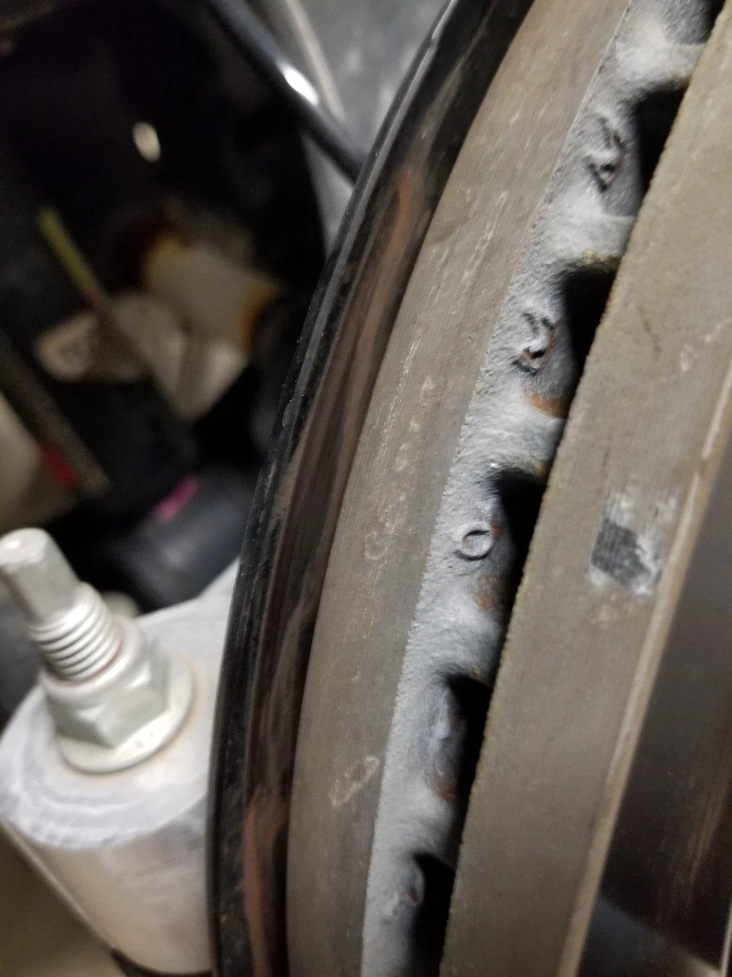

It finally warmed up enough to roll down my windows and I noticed a metal on metal noise coming from my front left tire. I figured it was a stuck brake caliper so I pulled the tire and found the dust guard was bent into the rotor creating a rubbing noise.

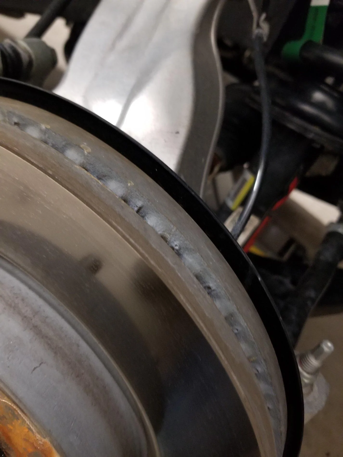

Here is what the passenger side looks like
Just a quick push on the guard and hopefully we're back in shape :like:
