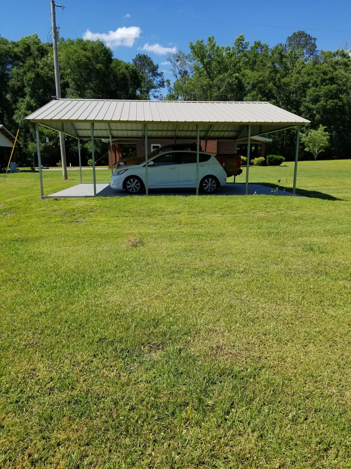

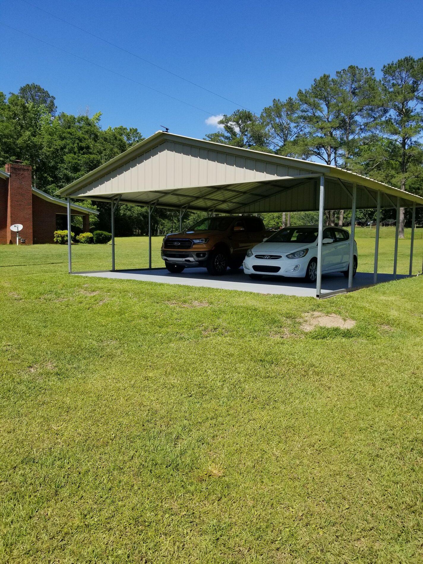

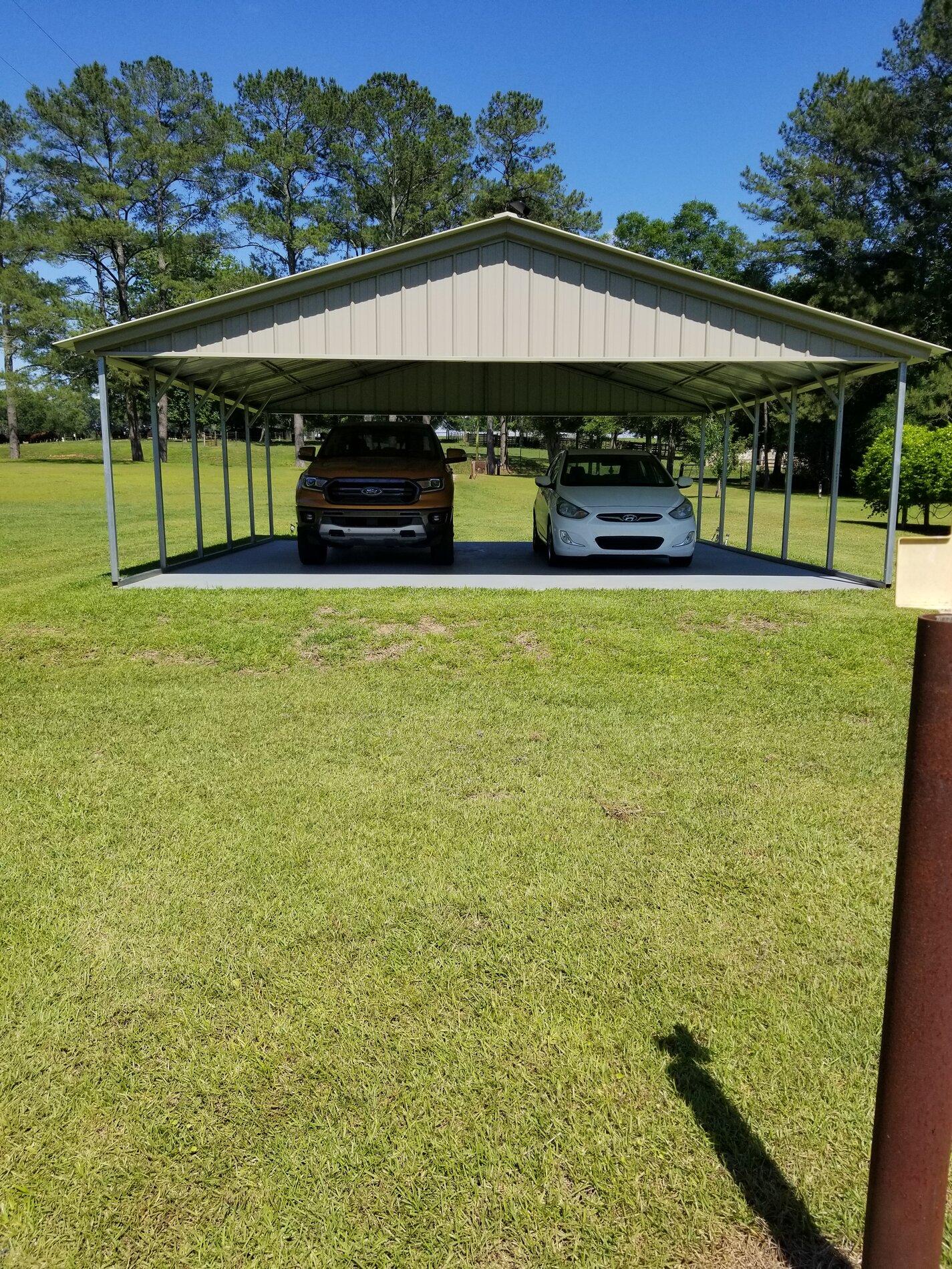

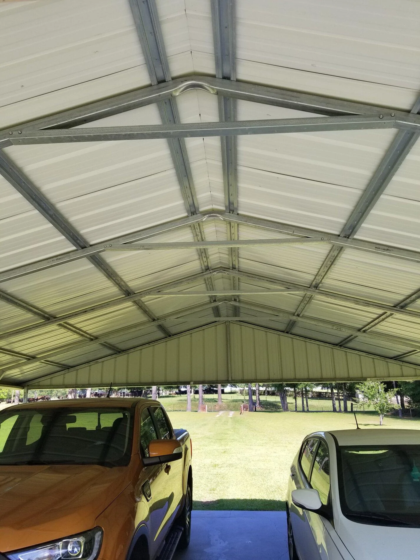

Bluestone Carports & Buildings in Georgia.
24'wĂ—25'lx6'8"(with gables, without 9'8"). Can get any configuration you need. We paid $3000 for carport & $2000 for pad(friend of husband's). Built it for Ranger prior to delivery. We love it, but wish we had gone a little longer. You can completely close it in if you need to- this is just how we needed it. Originally, we did not have the gables on the ends, but rain would blow in bad.so we added them shortly after installation.
The guys putting it up were great. We had great service from this company. Rated for 130mph winds. ?‍♀ That's what they say.

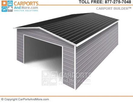

I am doing larger fabrication I will pull the truck out, for small fabrication I just need a little bit of leg room on the rear and sides. Ranger is roughly 17' long so with 26' length I have plenty of room for a 2' deep wall work bench and room to move around without moving anything. Ranger is also 7' wide (I think that is with side mirrors non-folded) so going from my current 12' wide space to 18' will give (to me atleast) a ton more room on side for storage and still be able to open doors. As I mentioned before I have not decided if I am going to make the 10x8 roll up door cut out offset yet or put in right in middle. But also the extra room on the sides gets me even more space on the last 9' the truck won't occupy anyway.
(door is not shown in proper dimension). This is $4,475 + tax delivered. A 20'x28' (2") crush run pad should only run me a couple hundred.

That looks very nice!
142
7,016
36,214
Hi Tracy,
Husband park Butterscotch? Nice and straight.... :)
