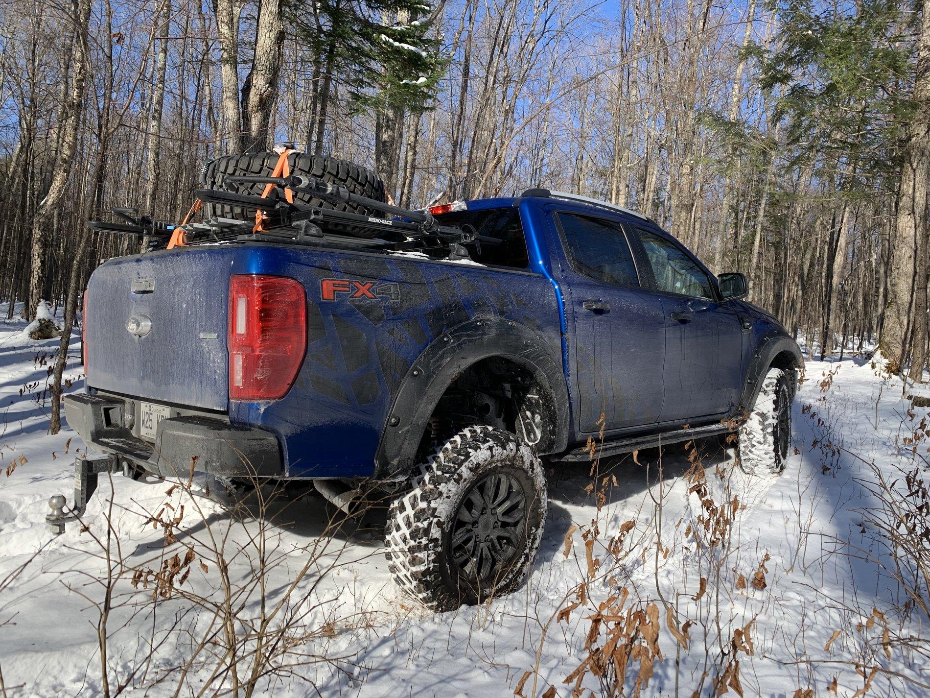

Hi! I’m turning to the community to see if I couldn’t get any good suggestions on rear bumper spare tire carriers. I’m not satisfied with my current set-up because it blocks my rear view and could be dangerous in a head-on collision (see photo below). Since my spare is mounted on a matching Fuel wheel I don’t want to even try fitting it underneath the truck to get all pitted and wrecked!
My google search only came up with one option, from a forum member I believe, that makes a 2-arm swing out. It looks interesting but would like to look at more than one option.
Can anybody help?

I believe the underbed mount has a chain around it in case of an accident to retain it. You could do a similar thing mounted on top to resolve that crash concern you have. It won't address the lack of visibility out the rear, but baby steps. I would safety mount the chain to those yakima eyebolts that attach directly to the T slot on the tonneau cover.
But I would also take a look at actually mounting the tire instead of just strapping it. I'm thinking about something like the Jeep tailgate style thing that secures 3 lugs to the wheel. I'm not sure if something specific has been made, but I wouldn't expect it to be too difficult to weld something like that to a cross member.
