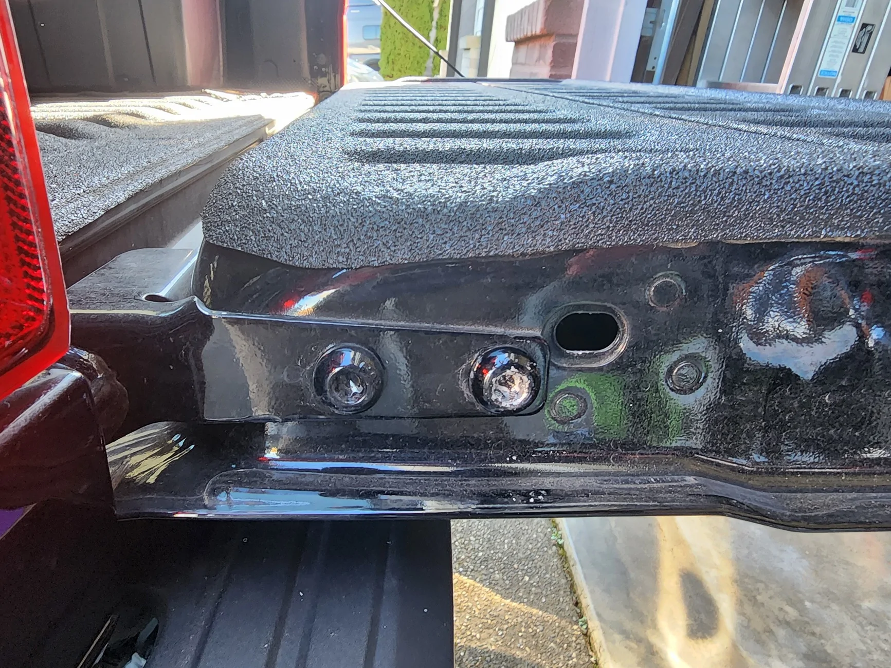

Good morning all. I'm trying to install a tailgate assist, but I can't remove the tailgate bolt because it is painted over. Using a (corded) drill with the T50 torx but it won't budge.
Any ideas how i can get it loose without stripping the head? I would greatly appreciate any input.

You need to go to a buddy (or Advanced Auto or just a "gas" station that has a mechanic) who has a proper ratchet and 50mm socket and it will pop loose no problem. If you have rounded this torx (socket or bolt head) out, use the ratchet/torx on the other side... I think they/it can go on either side (but double check first).

Use a 1/2 inch ratchet and a good torx socket. A drill doesn't have enough torque, but an impact wrench will.

I just used my 1/2" ratchet and but and it worked fine. IIRC you have to go forward and back a couple of times and it takes a little work but it'll come off as soon as you break the paint seal.

I see what you have , you need to use a 90 Deg Pick / Awl - and carefully clean out the bolt head - if you are talking about the forward bolt.
