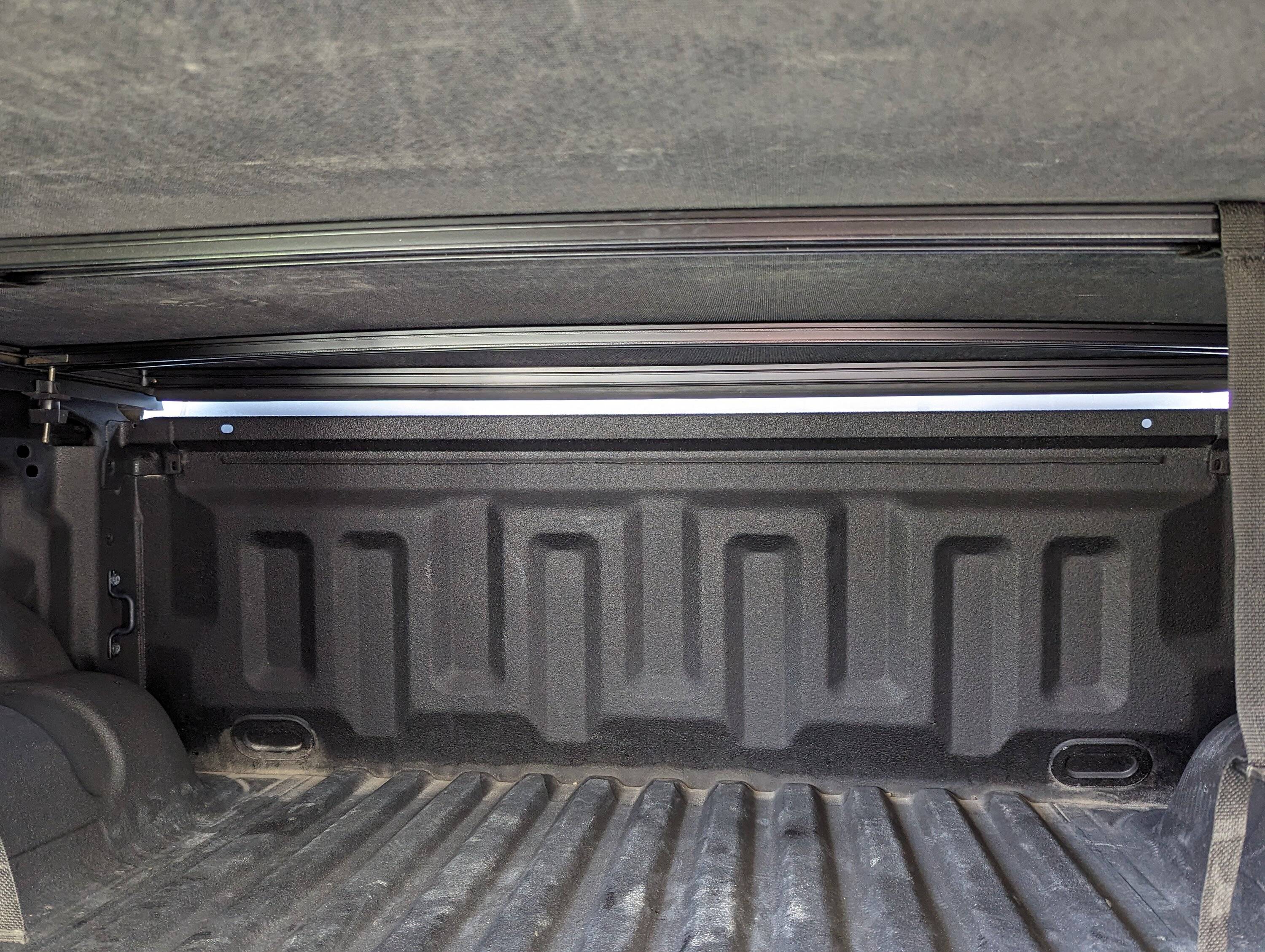

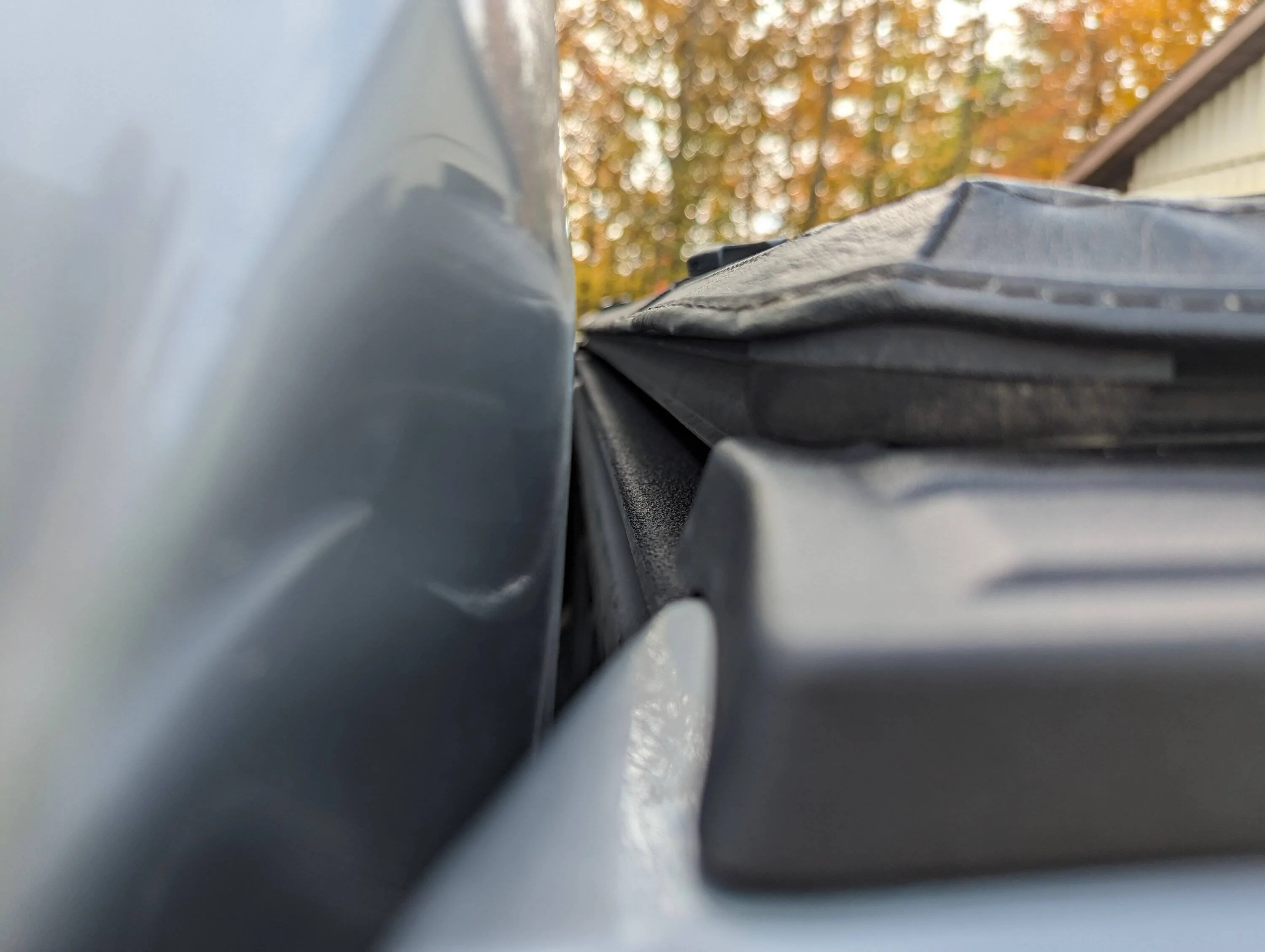

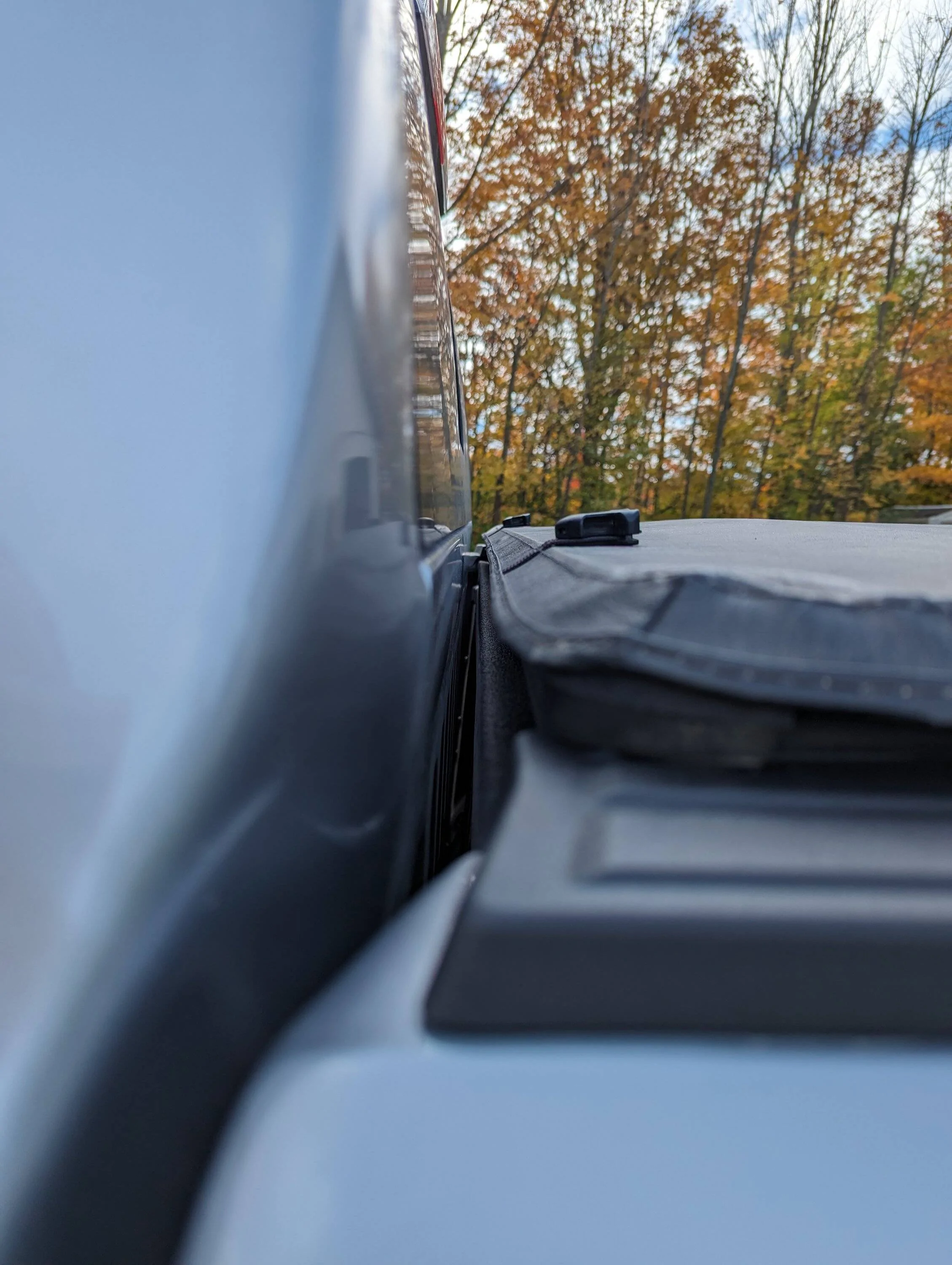

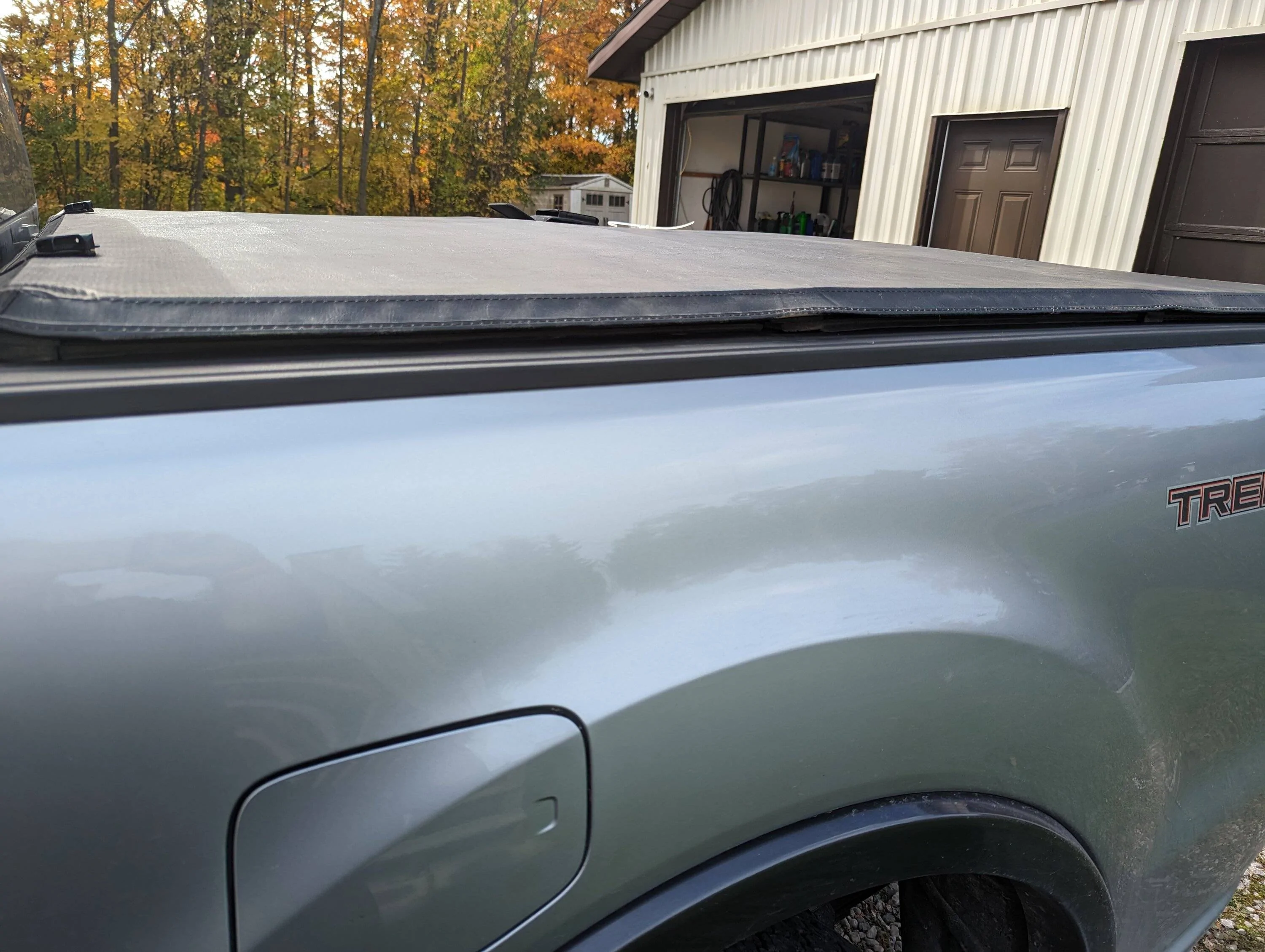

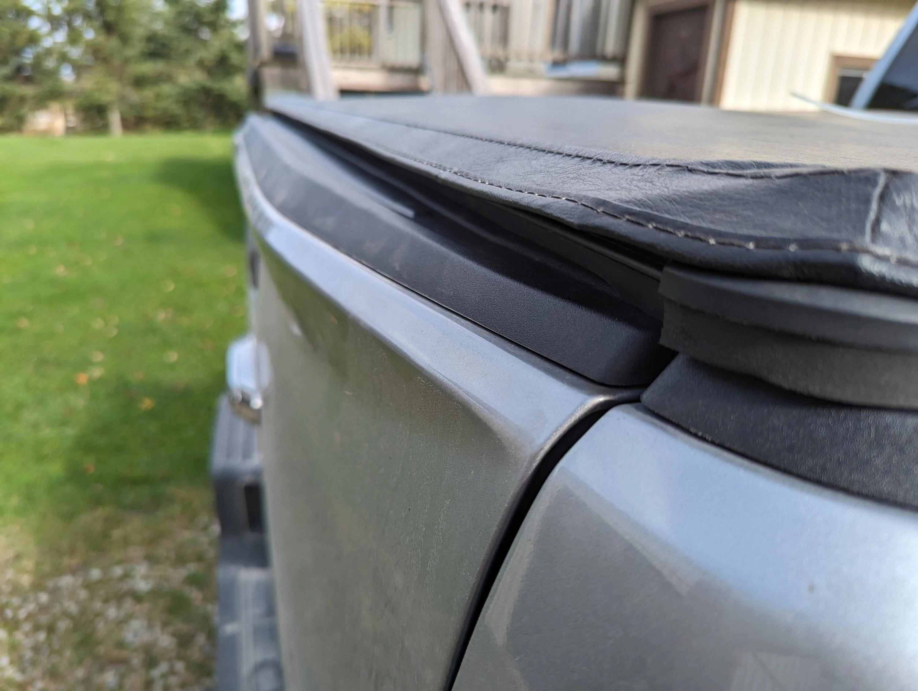

Looking for some suggestions.
I purchased a used Ford OEM soft tri fold (part# is for 5ft box Ranger) but did not come with a manual to confirm fitment procedures.
Installation is as easy as any other soft trifold video on YouTube however.....I'm questioning the sealing of the front header rail on the box (closest to the cab) the gap that is left is almost 2.5 / 3 inches between the rail and the rubber weather stripping on the tonneau itself. The sides and rear tailgate seem to seal just fine and every appears to be lined up but it just doesn't seem right ....maybe it's supposed to be this way...but im unsure....I've attached some photos to illustrate

When I bought my cover new, it came with a seal for the front of the bed. If buying used the previous owner probably ruined it taking it off. nothing that a trip to the local hardware store won't fix.

Ah ok,
It's quite possible that is the case....no luck online trying to find a PDF of probably a 1 page manual which I was hoping had that information in it.
It's a pretty large gap...just wasn't sure if I go with pipe pre slit insulation or regular weather stripping seal....I guess my main concern is adhesion due the spray liner material covering across that top rail

I think if it was me, I would try to stuff a section of foam pipe insulation in there and give it a go. the piece that came with the cover had a peel and stick adhesive on it. Doesn't fit real tight but does the job.
