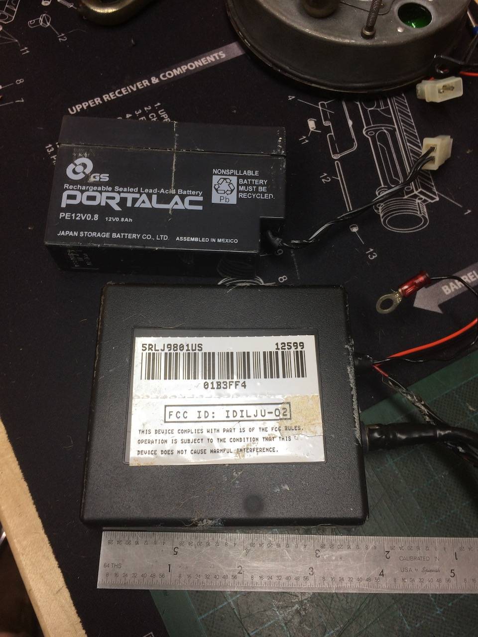

a very old device looked like this. bottom was the transmitter and an obvious gel cell battery for backup. there was a simple power pigtail and then an antenna that had to be routed somewhere, under the carpet, up into dash. but this was a 90's era unit, so I imagine they evolved a bit.
I have read they are suspending all service, seems odd they want you to renew. besides. wasnt Lojack a one and done type install? at least it was back in the 90's.
I will say this, for a while they were the best way to recover a car before it was cut up or shipped overseas in a container.
also, the unit will likely be covered in black tape, covering all identifying markings.
further edit, did some googling and it appears lojack is still marketing thier system and its quite different. this pic is a old style that only activated after your VIN was entered into the NCIC by law enforcement. the new systems appear to be tracking and sending location data more frequently.
