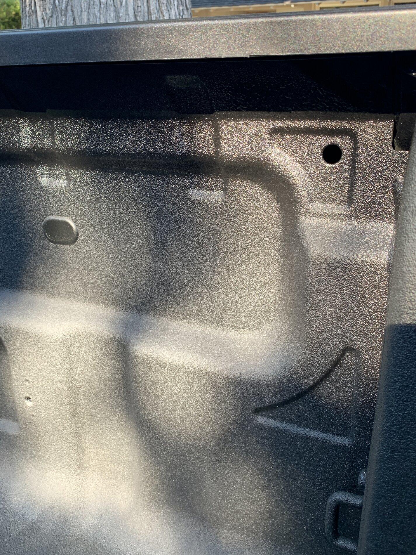

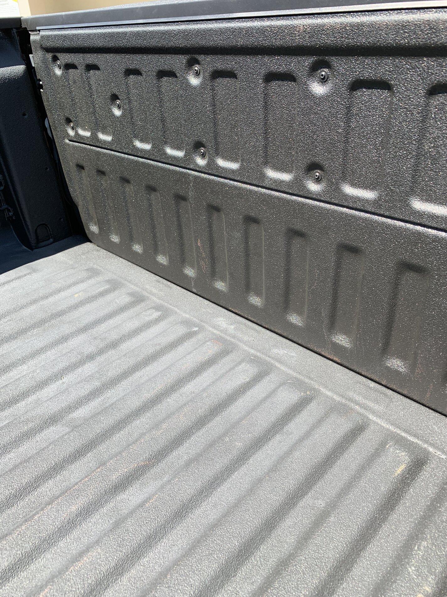

Barely 8 months in, And my rangers linex is more faded than my 10 year old F150 was when I sold it. Buyers beware... If your going with Linex, upgrade to the Premium because the standard coating is not what it used to be. I wish they had told me the basic bedliner would only look good for a few months. Under the rails, tailgate and any area that didn't get direct sun still looks pretty new. Everything looks chalky and faded. Unfortunately, I guess I'll be stuck putting restore on it every six months. Hope this helps anyone looking to go linex.

The way a local shop explained the process to me is that the UV-resistant material is an extra coat, sprayed over the basic material. You can probably still get the extra coat applied and restore the original appearance.

If you don't have the UV resistant sprayed over it you could try the 303 Aerospace Protectant on it. It will bring the graying back to life on just about anything from plastic to metals so it won't hurt to try it on this too. Then either lay a bed mat in there to protect the bed area and you will only have to re-treat the sides. You could get a tonneau cover but then it might be just a costly to just have it resprayed in the long run.

303 is exactly what I was going to try. They make great products. I will eventually have a shell on the back, so someday when that happens I know it will help slow the fading.
I just wanted to post the info for anyone thinking of using linex. For the money and the fact the "basic" coating looks like crap in 8 months.... That's not cool IMO.

What blows my minds is how faded it is right up to the tailgate.... but the tailgate is fine. WTF.
Local Linex installer had such a sh*tty attitude about it, I wouldn't let them apply Linex Restore for me.... Soooo disappointing.
