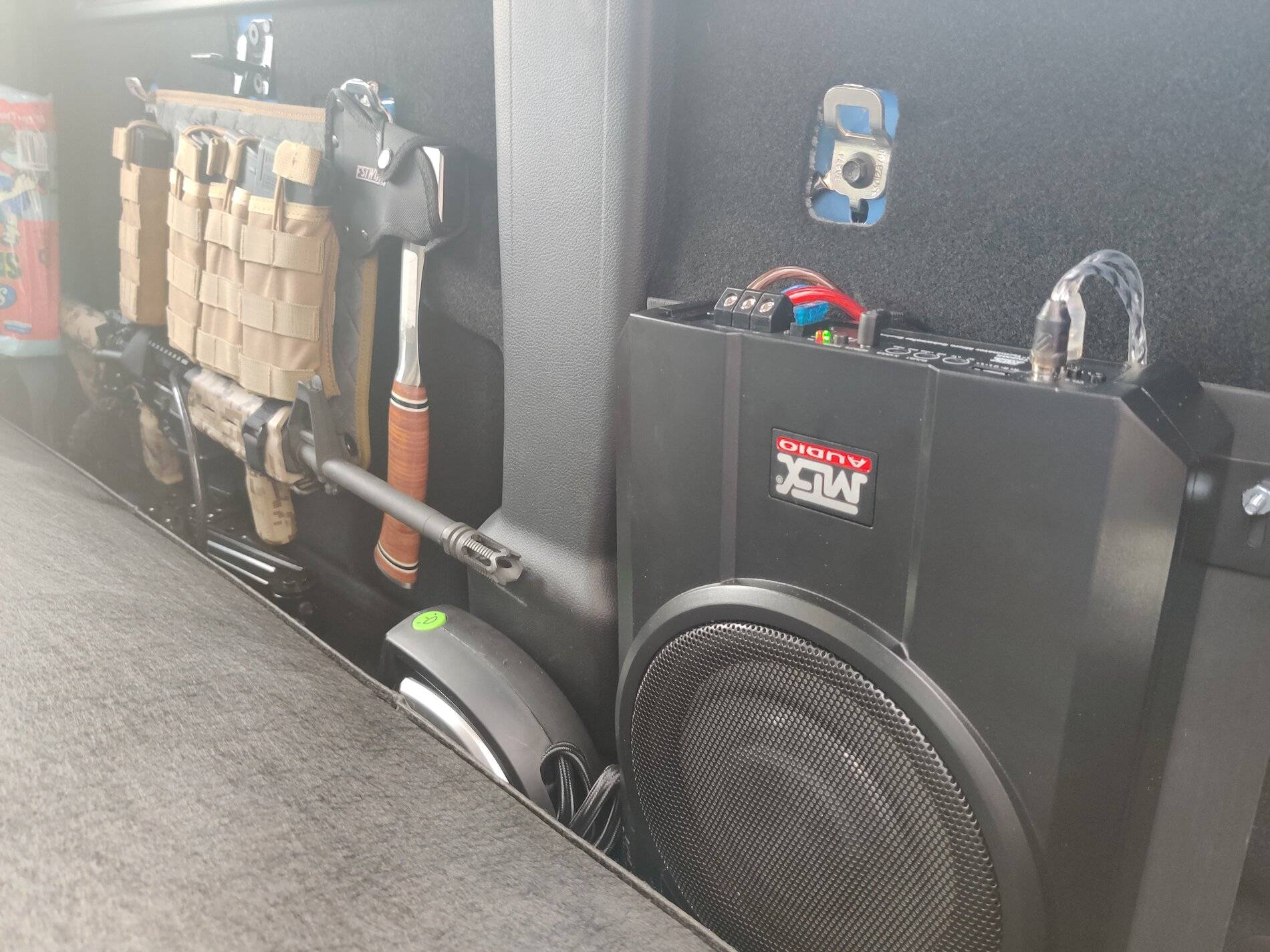

Sub installed. Not a bad unit for $200 but don't expect to wake up the neighbors, just feel and hear the lows better.
Does your seat close easily with the sub in that location? I have my Kicker Hideaway Sub in the cutout where the B&O sub would be but I couldn't use the mounting brackets that came with it.
I have mine in the same place, I made a custom bracket. Closes with no issues. My MOLLE caused more issues.
