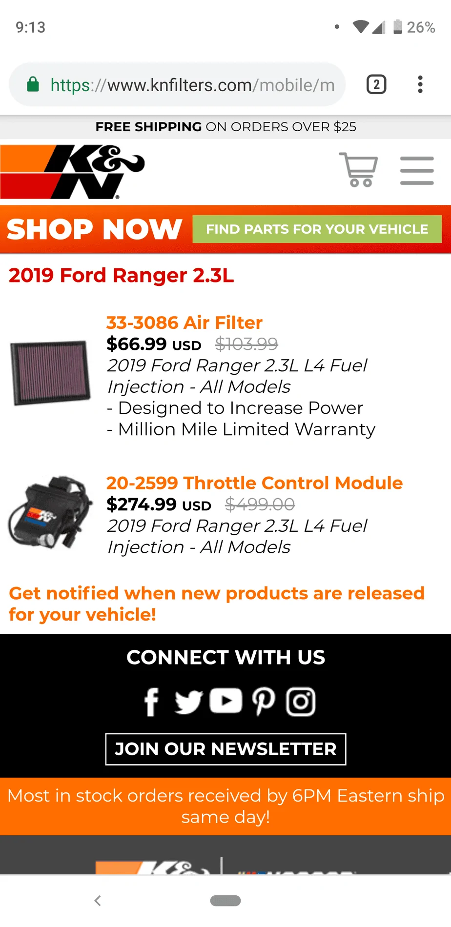

I'm not sure a new intake system would offer much gain. The stock has a good sized inlet and appears well designed. I'll be getting the K&N filter soon.
What do they claim the new TCM adds?

Here is the link to the TCM. They don't seem to be claiming it adds any power, just better response. See the reviews. Tempting
https://www.knfilters.com/search/product.aspx?prod=20-2599

More flow = more dirt, great for engines getting rebuilt every 25 passes, not so good for something that's going to go 200K miles.
The only thing you will see with a less restrictive filter on a turbo motor is faster spool. If the filter is restricted enough to hurt performance after initial spool, the turbo is going to suck it through the intake tube (I've seen it when a mouse makes a nest in the intake box, the turbo sucks the filter into the tube until the engine chokes out).
At the best case you will polish your turbo vanes prematurely and reduce performance, worst case is something will fail.
The TCM just messes with the pedal position, I'd rather do a tune than have something actively messing with the OBDII signals.
