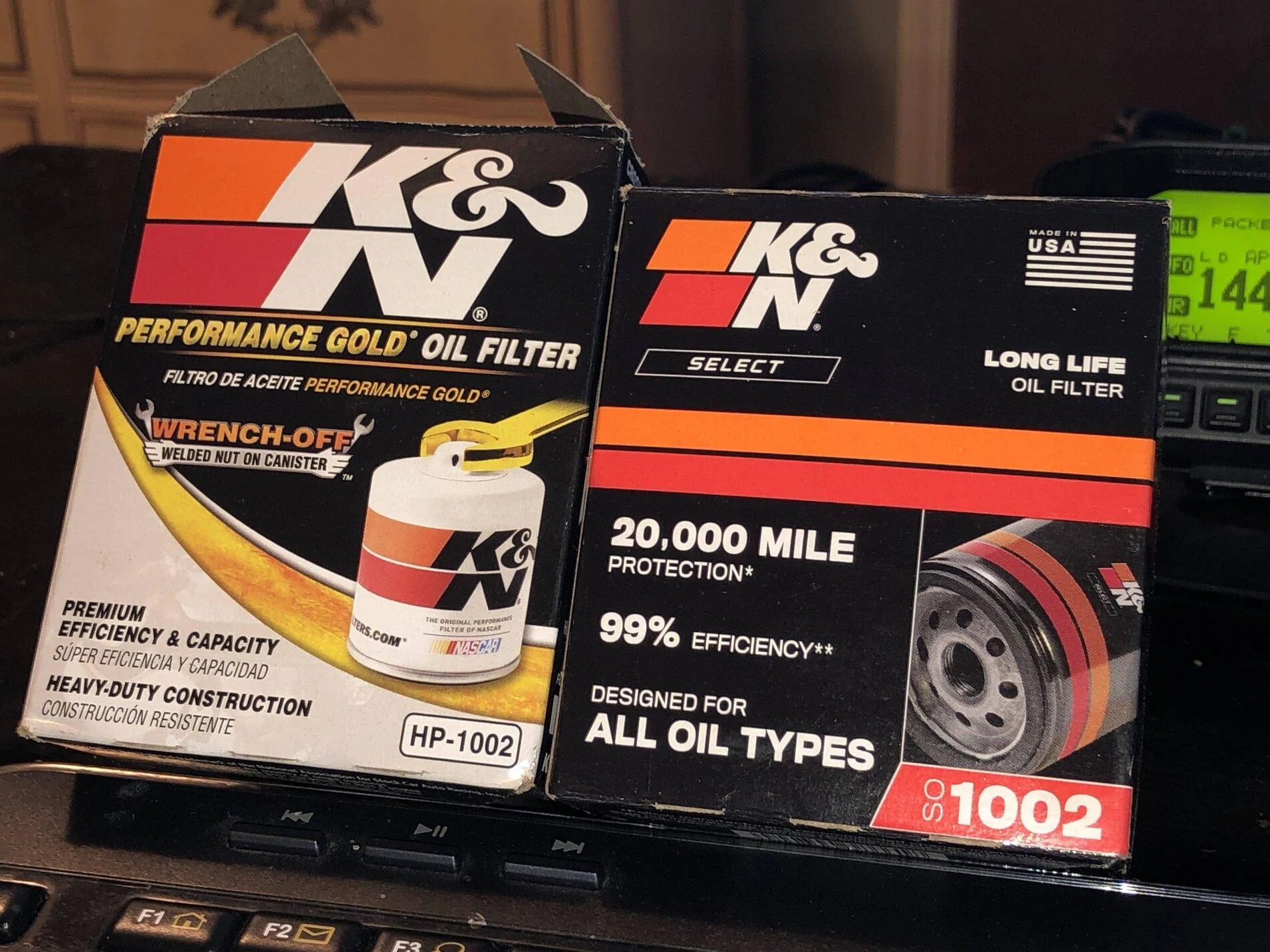

I have been using the K&N HP-1002 oil filters on my Ranger, and before that on my Explorer. The HP oil filters are the ones with the nut welded on them to help loosen them. I don't care about the nut so much and I buy them because they are marketed as being high flow. I have been buying them at Wal-mart for $9.97.
For a while I have been going to Wal-mart and they have always been out of stock. Today I went to Wal-mart and they have a K&N oil filter with the part number SO-1002. Same $9.97 price. It advertises 20,000 mile protection and 99% efficiency.
I don't know what this means. I'm going to change the filter at each oil change, even if I don't have to, so I don't care about the 20,000 mile protection. What does 99% efficiency mean? It stops 99% of all of the contaminants in the oil? Or the flow rate is only reduced by 1% making it 99% efficient?
Looking through the threads into the filters, they appear to have similar construction. I can't find any info on the "SO" version of these filters. Perhaps they are sold exclusively at Wal-mart?

It’s the particle size that it traps. So it’s probably in the .5 micron range. Does it say smallest particle size it filter to? That’s what is most important. Their supposed claim is the volume of material in the filter will allow this efficiency

I found this answer on the walmart.com website:
HIGH FILTERATION EFFICIENCY: Captures 99% of contaminate greater than 30 micron​
https://www.walmart.com/ip/K-N-Sele...A-VOLKSWAGEN-Vehicle-Models-SO-1002/634533795

Wix are 21 micron and motorcraft is probably right there with them
I found the specs on the "HP" version and it says "Down to 10 microns." I might have to take this filter back to walmart.
