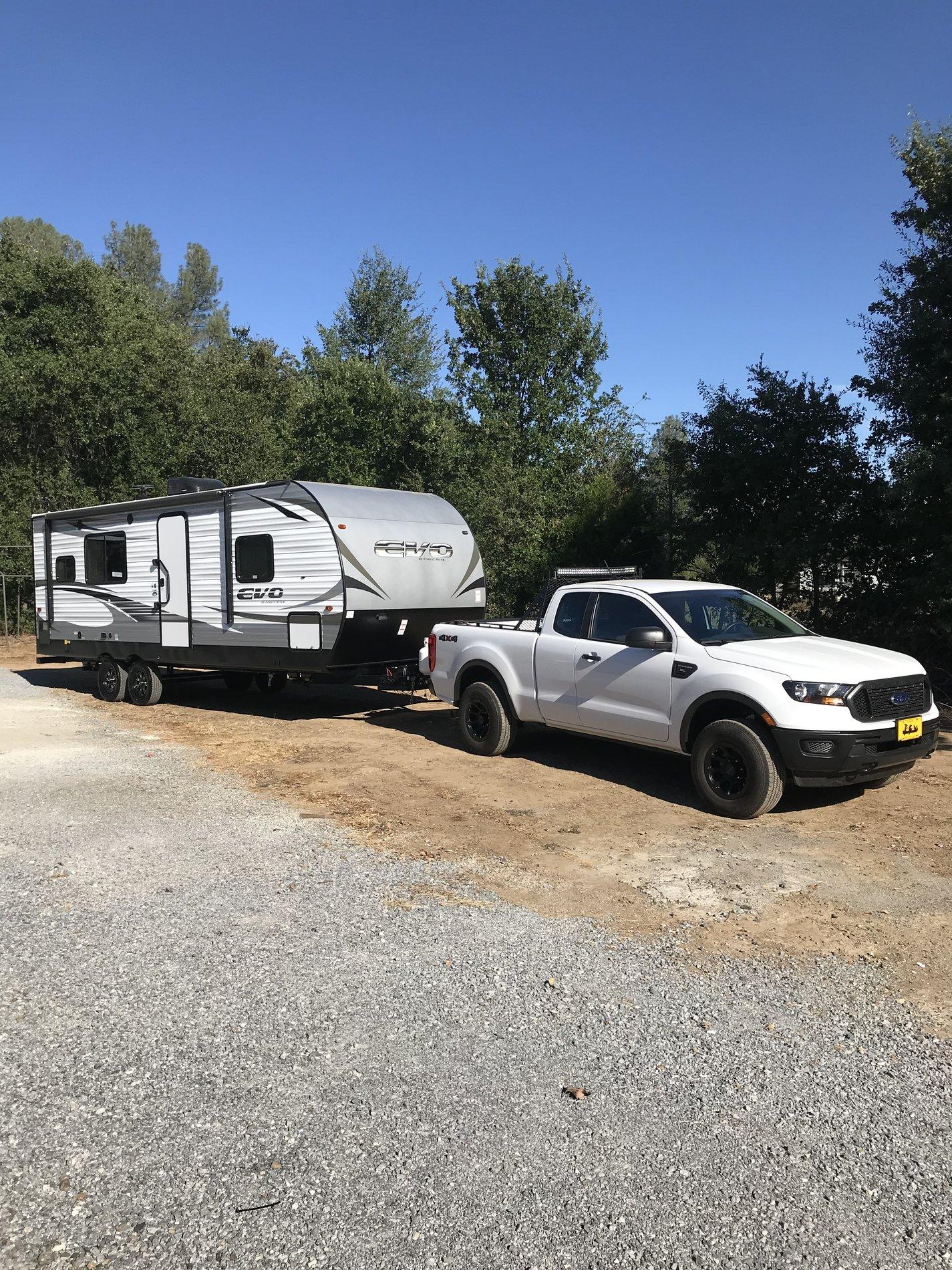

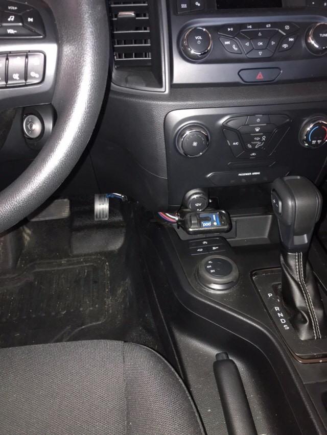

2019 base model 4x4 Ranger no tow pkg, bought a 7 way adapter plug for the back off etrailer, could not find any wiring for a brake controller so did all that. Curt hitch, distribution hitch with anti sway. 2020 Forest River Evo 25’ Trailer weighs 5400 dry and gvwr is 7550. They filled the fresh water so I was probably towing 6200 or so. Did great, cruised it at about 58-60 on the freeway 15 miles to home. No lack of power really. I don’t think I had any unusual sway, seemed to tow well.

Very nice :like:

Update, loosened up weight distribution hitch and tightened up anti sway and it feels much better. Truck pulls great!
