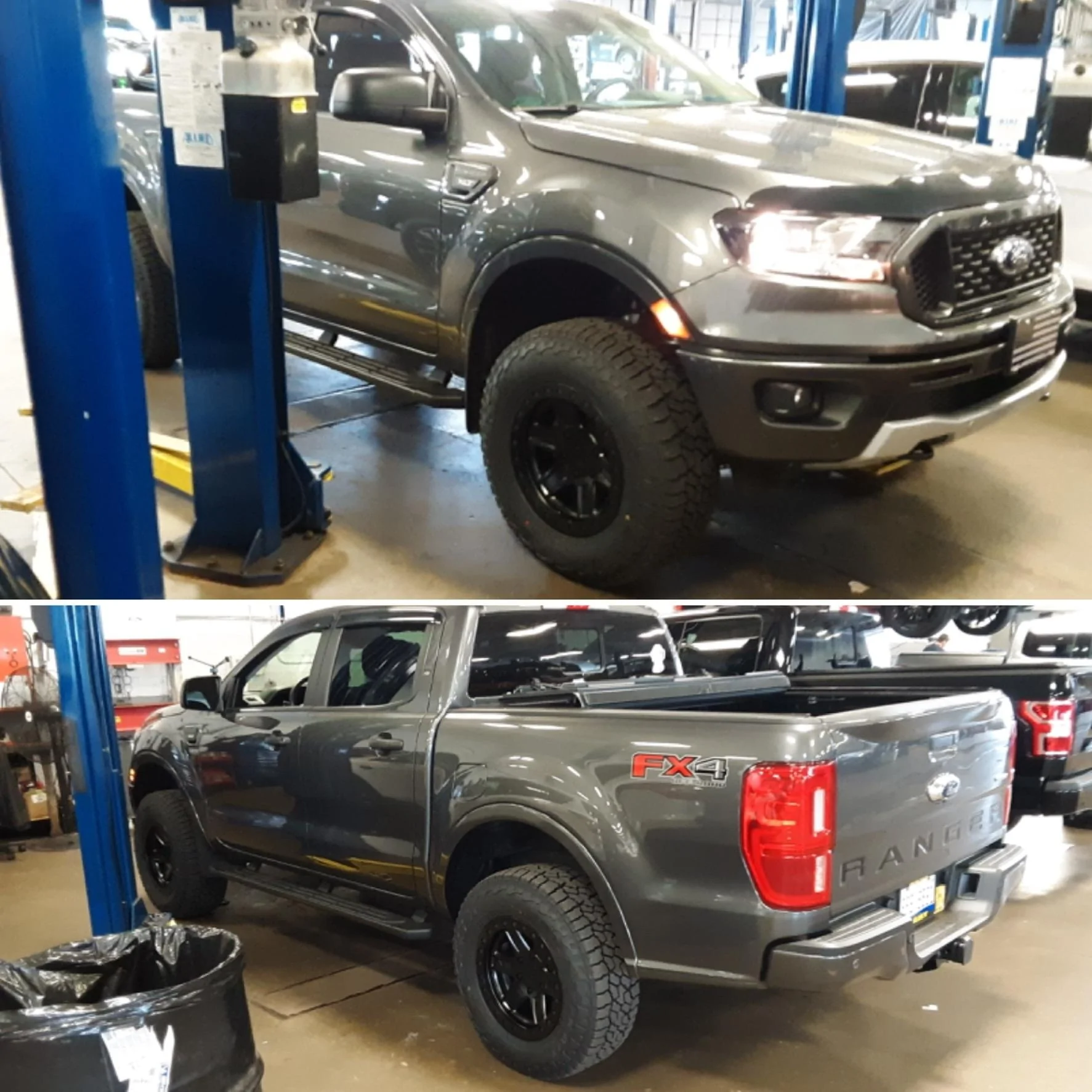

I took my 2019 Ranger in last Tuesday, 23 June, to a dealership for a Fox 2.0 suspension upgrade and new wheels/tires of a larger size than stock. As part of that process I requested that the dealership update tire-related systems.
When the dealership attempted to update the ODO/Speedo/UBS/etc., the vehicle locked them out. The techs reset the truck and tried again, directly and via over-the-air, but matters only go worse. Over the course of the week several attempts by the dealership and by Ford technical support failed to repair the issue. The vehicle disassociated itself from the VIN and the keys ("the truck doesn't know it's a truck"), alarmed all body errors (E.g., air bags), and ultimately denied access to the vehicle's computer systems. It will start given bifurcation in engine/body systems, but nothing else.

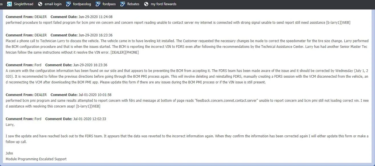

UPDATE: A week and a day later the truck is still down. The Ford software patch did not work as promised. According to Dean Sellers Ford (Troy, Michigan), they are at a loss and now have to wait on a Ford engineer.
Upside, if the patch didn't work it may be localized to my truck. Downside, it's my truck they broke.
Frustrating, but could be worse.
EDIT: for the tech-curious, attached is the dialogue between Ford and the dealership; dealership sent it over this afternoon.

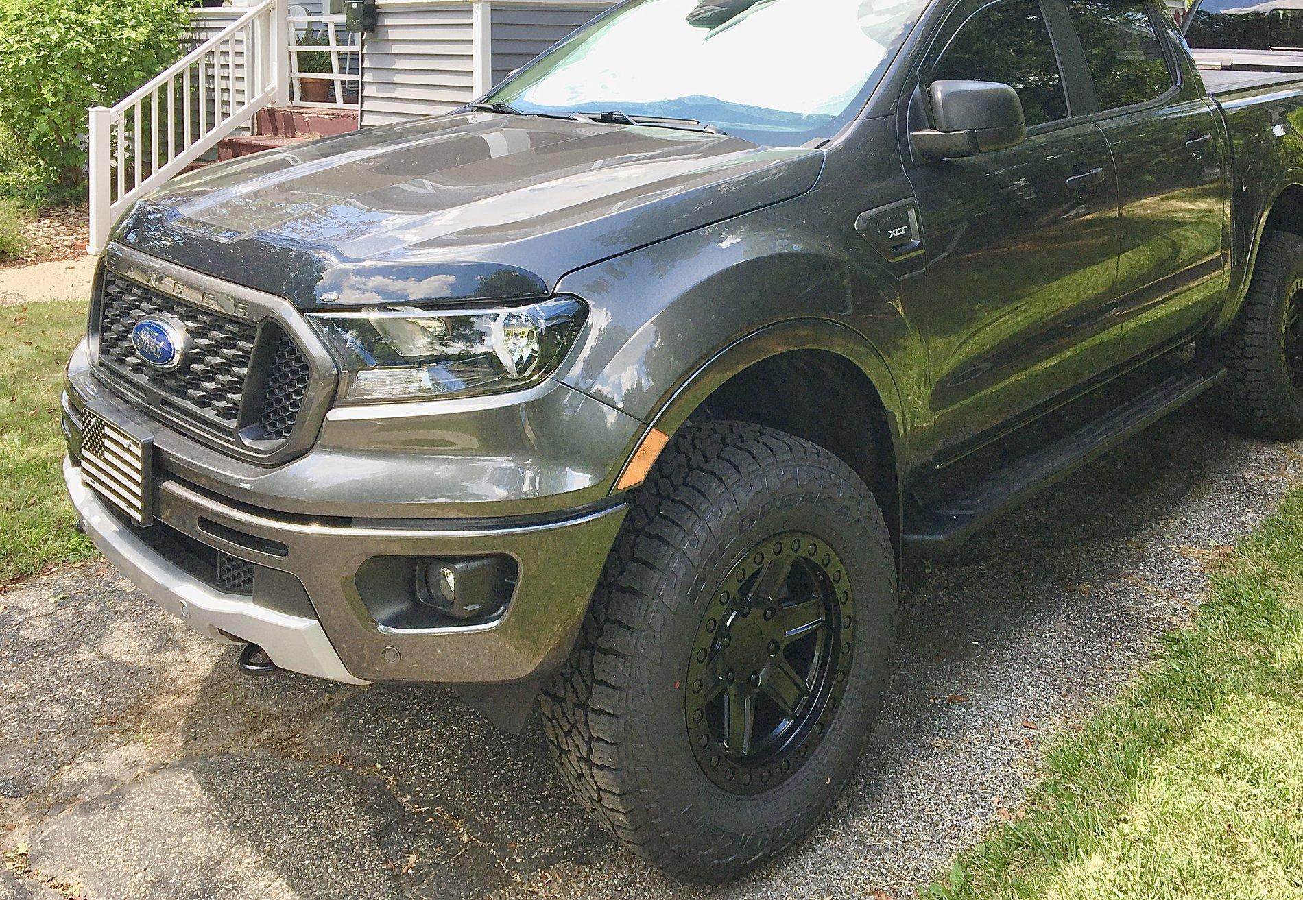

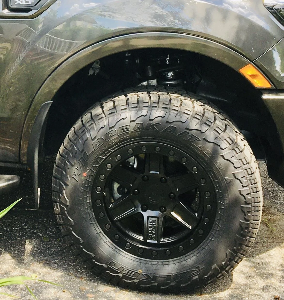

For a different forum but since we all love a bit of tire talk:
Replaced a 3” spacer lift and 285/60r18 Nittos with Fox 2.0 coil overs (kept the RC UCAs), Rhino 17” wheels (+12 offset) and 265/70r17 Falken Wildpeak ATs.
Surprisingly there is a modest bit of rub at full lock in reverse (front driver’s side crash bar; rear passenger crash bar). Surprised only because 265/70r17 is the largest size recommended by Ford, is the top end of their performance tune, and comes on the new Ford Performance level Two and three trims due out later this year/next.
Maybe it’s the offset difference. I took out the plastic crash bar covers; hoping that works on the front. If not I may adjust the front up a bit or simply turn to full lock with caution. Plan to keep the crash bars. Rub at full compression is always a concern.
