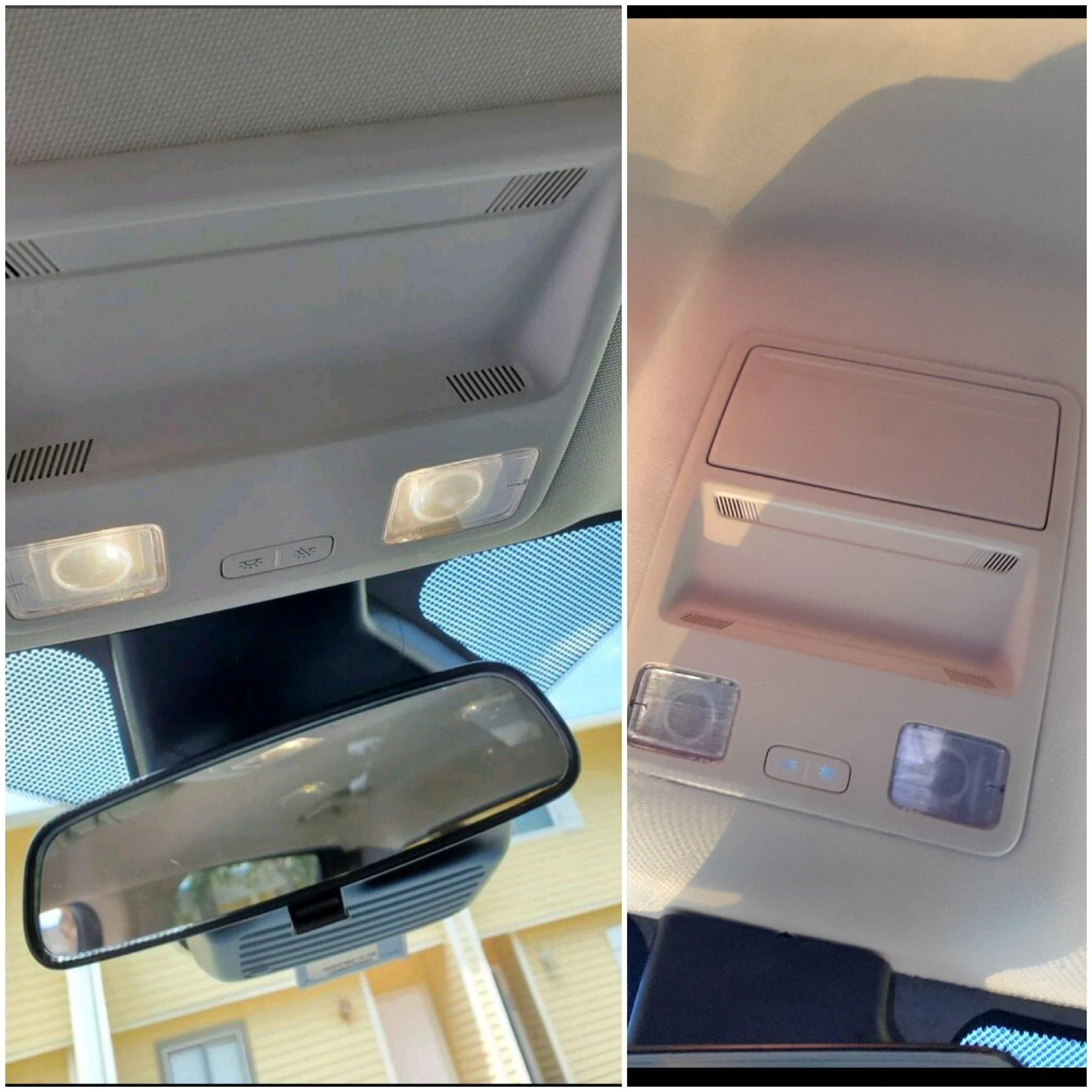

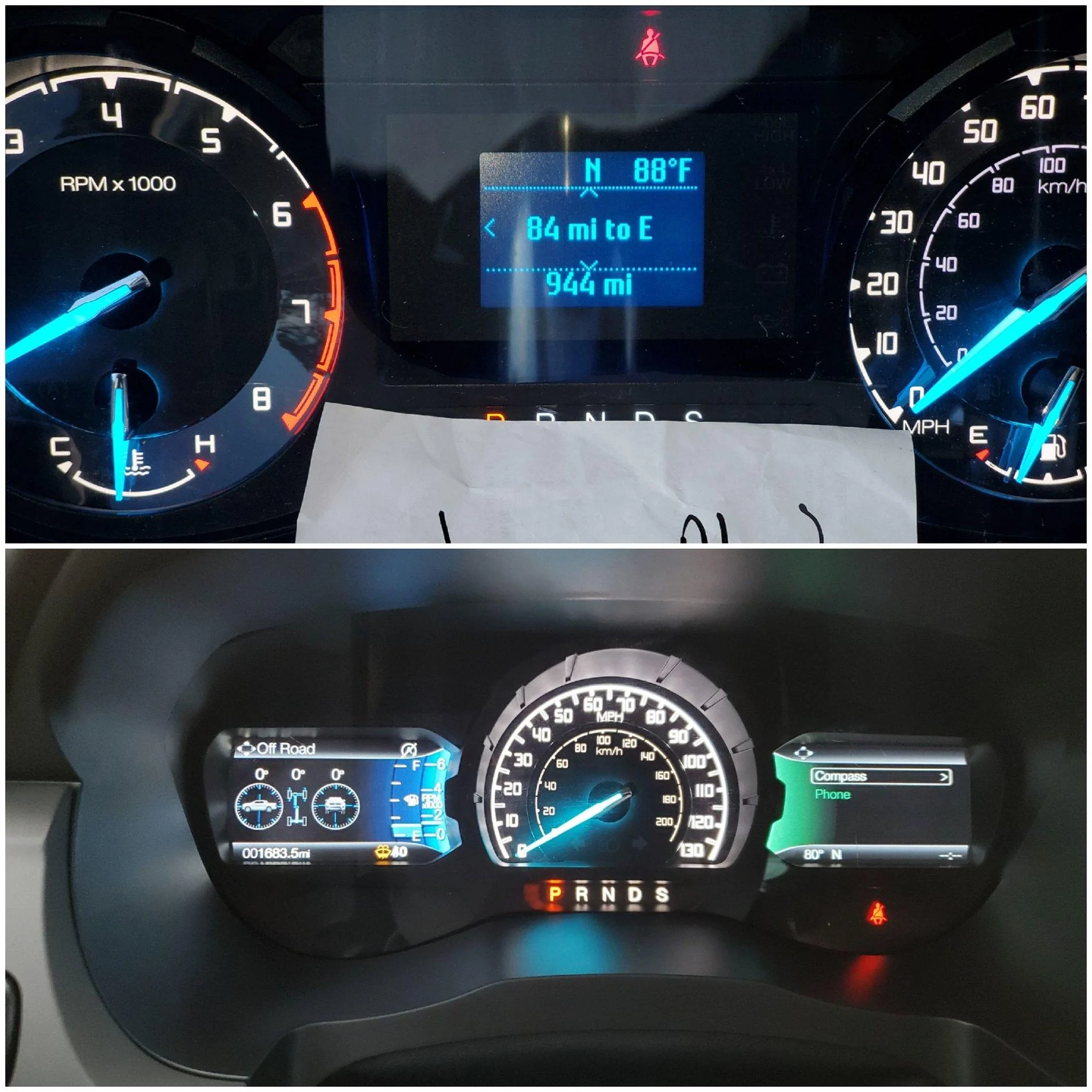

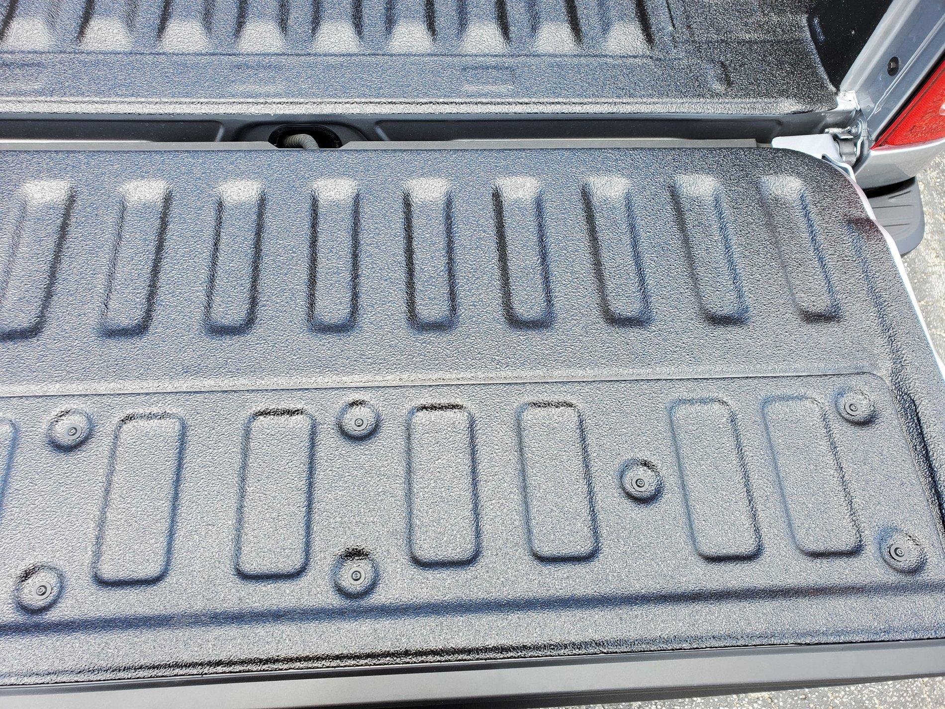

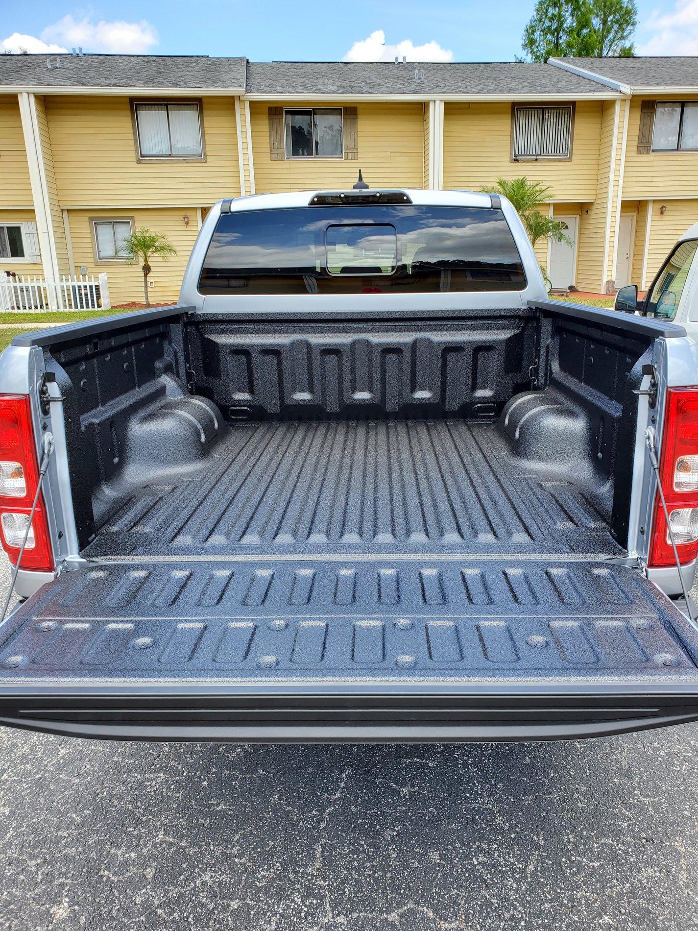

Switched out the xl visors without mirrors,, to xlt visors with mirros, switched out overhead console to xlt with sunglass holder, switched out speedometer cluster from ugly blue 2.5 inch screen to lariat dual 4 inch. Got bed spray lined.

Cluster is nice what did that set you back?
I got it from a junkyard for 75.00
how did the cluster swap go? any issues?
no it is plug and play, and all lariat things work fine, the only issue is finding miles close to your trucks. You can go forward in forscan but not backward. I actually tried a xlt unit first, but the chip was locked.
