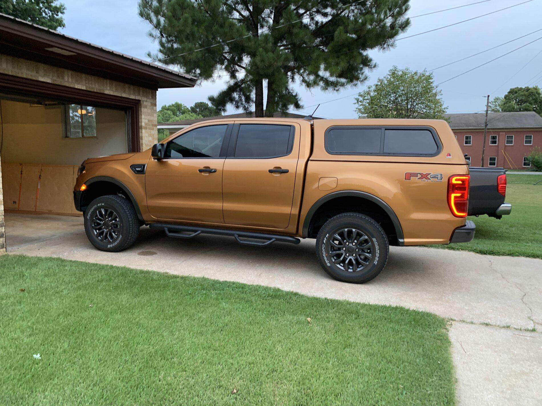

i replaced the bov with a Turbosmart Kompact EM bov and replaced intercooler tubes with one made by aFe. Truck has spells of hard shifting or it’s not sure what gear to be in. Gas mileage is about 22 mpg, according to the truck. Not happy with the hard shifts. I have added a 2 inch leveling kit to the front. Interesting note on that was after installation truck went in for oil change and a front passenger side cv boot was torn, truck was under 5000 miles at the time. I don’t want to mess up my truck. I like my Ranger!
