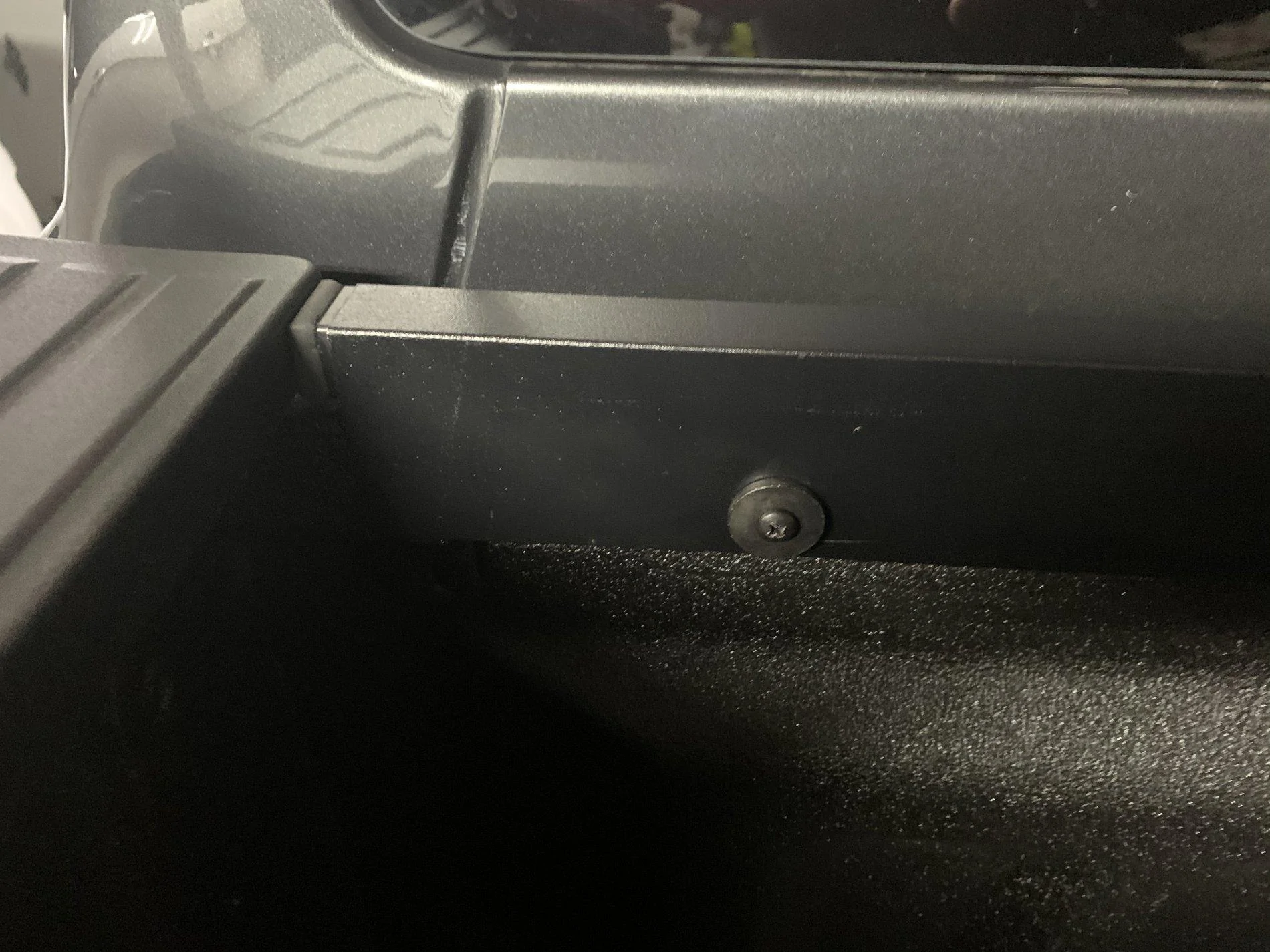

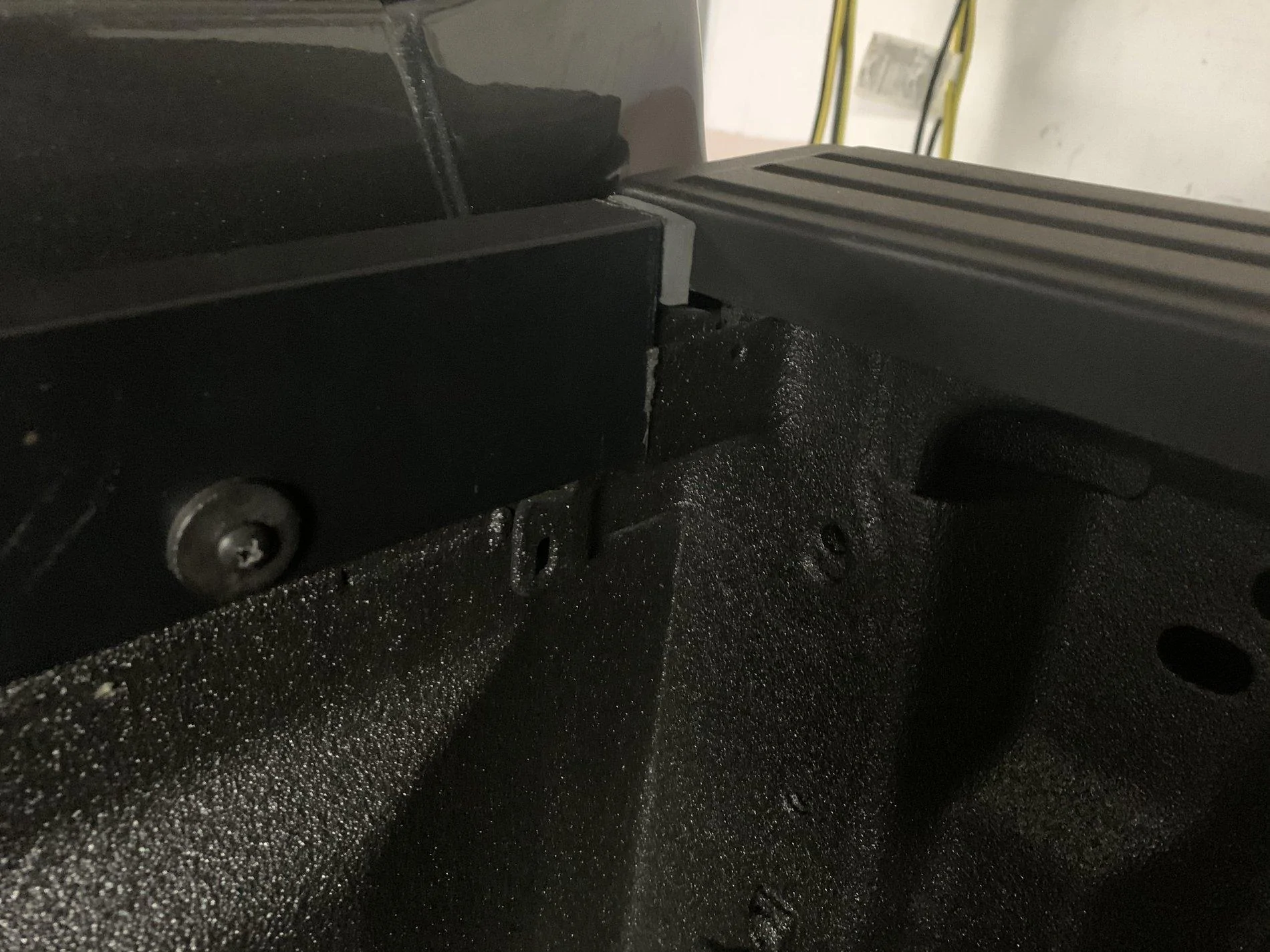

Easy install, crappy instructions. I saw some other members who had issues with gaps, but mine sealed fine all around. I think the key is to not have it overhang too far on the tailgate. The tailgate has a gradual flare up on the back half of the top that will make for gaps if you position it too far back.
Also, don’t skip the bulkhead bar they give you for the front of the bed. It will leak if you do. I know the instructions on installing that bar suck, so here’s a couple pics of it installed to hopefully help others.
The “lip” of the bulkhead bar sits on top of the front bed rail and makes it even with the side rails. Skipping this step will leave a good one inch gap.
cheers!

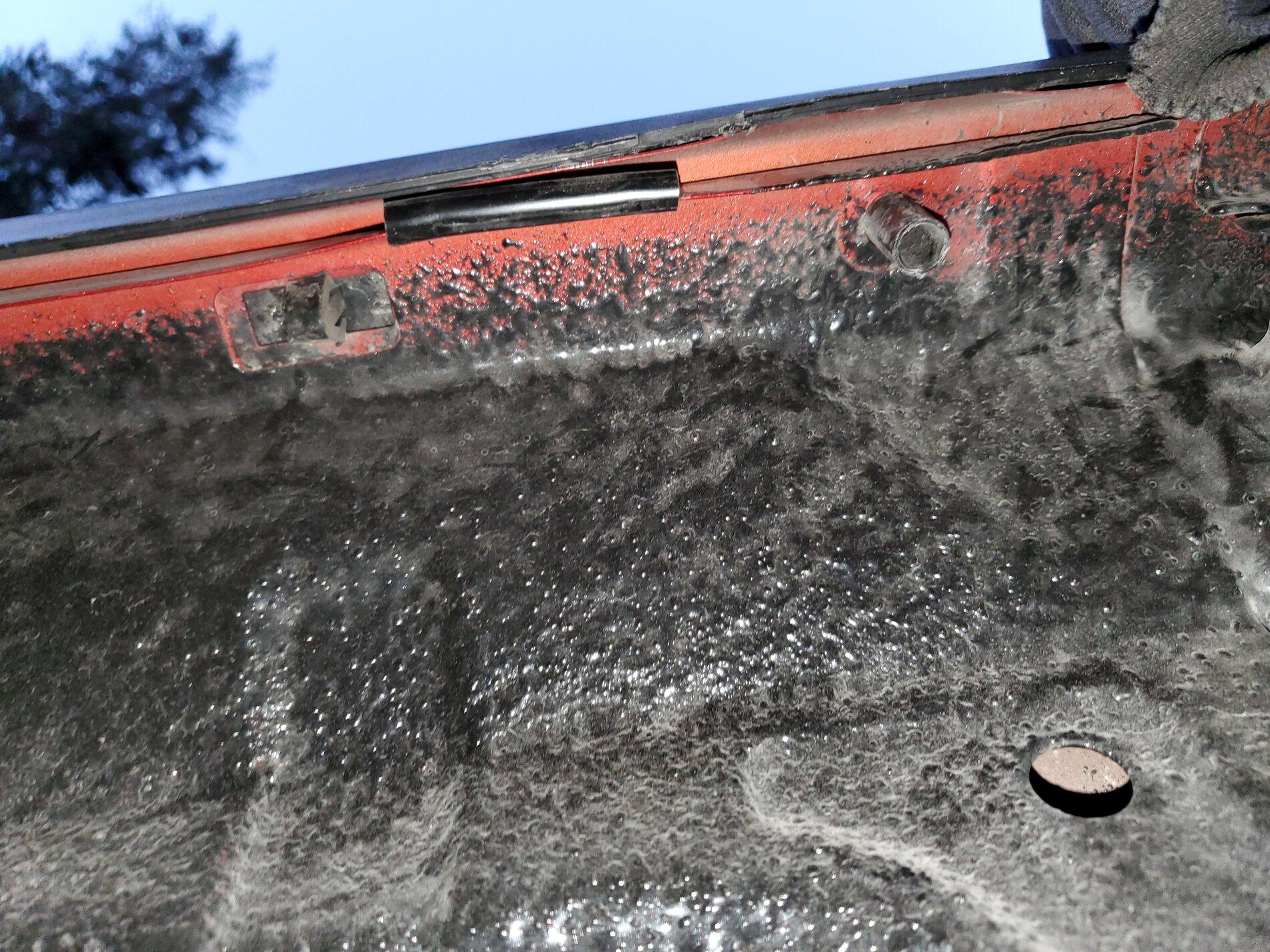

I've had mine for a couple weeks now. I feel like mine is about a half inch to short to seal on both ends, and they forgot to send me the parts to attach the bulkhead bracket.
Also, I noticed mine has started to bend the lip where the clips attach, and I have tried to be careful to make sure it's not too tight. Not sure if it will be a problem long term or if other covers would have the same problem.

I just barely noticed it on returning from a camping trip, so I haven't had a chance to investigate closely. I have been pretty careful not to overtighen the quick-release clamps, and the clamps near the cab don't seem to be bending it at all. I was also able to compare to a similar soft trifold on another ranger. It had different clamps and no sign of it bending the metal. For this reason I tend to think the quick-release clamp design is to blame, but I may just be not using them right?
For what it's worth, I noticed a couple reviews on Amazon mentioning the bending.
