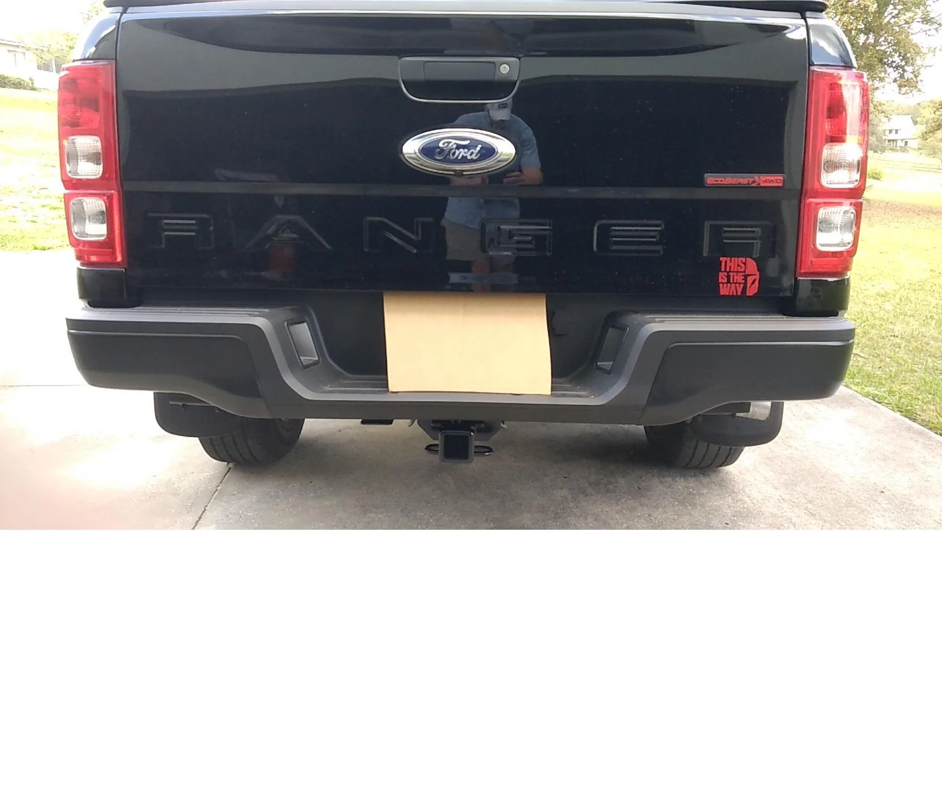

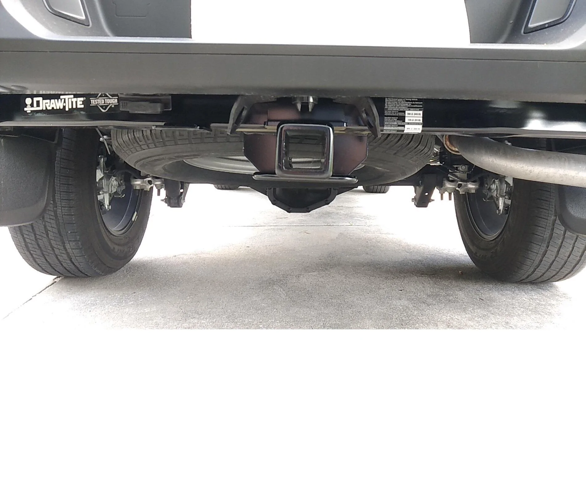

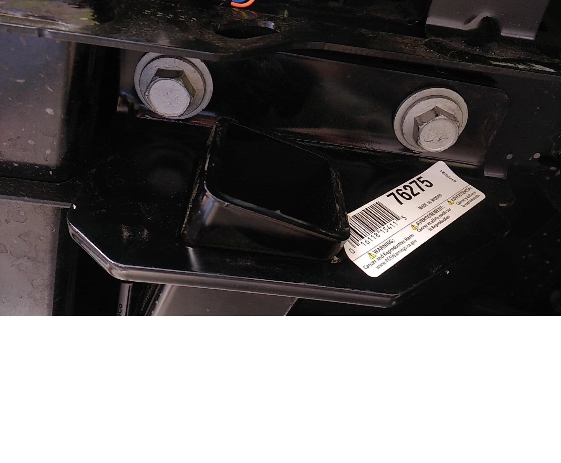

I installed my class 3 ...2" Draw Tight hitch today p/n 76275 from Etrailer ..
1125 Pound Tongue Weight . 7500 Pound Towing
Nice piece , fits like a glove , nice and tight to the frame when viewed from behind . 4 bolts 146 ft lbs (uugh) and your done . I did not have to remove my spare tire to install it on my 2021. I used a 5 gallon bucket with a few 2 x 4's on top of it to hold it on one side while I hung the other side . Kind of goes without saying but watch your face when doing this its pretty heavy and you could lose a few teeth if it slips and hits you .

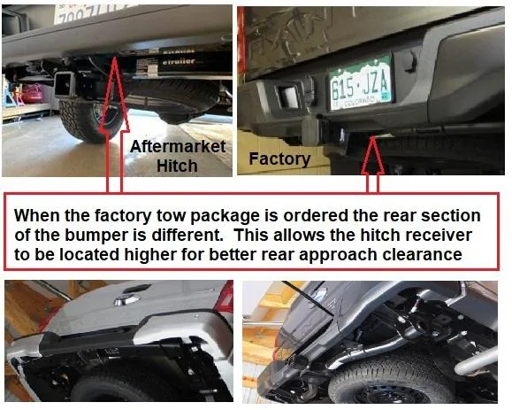

Looks about the same as the "etrailer" hitch. About 3 inches lower than the factory installed hitch.
