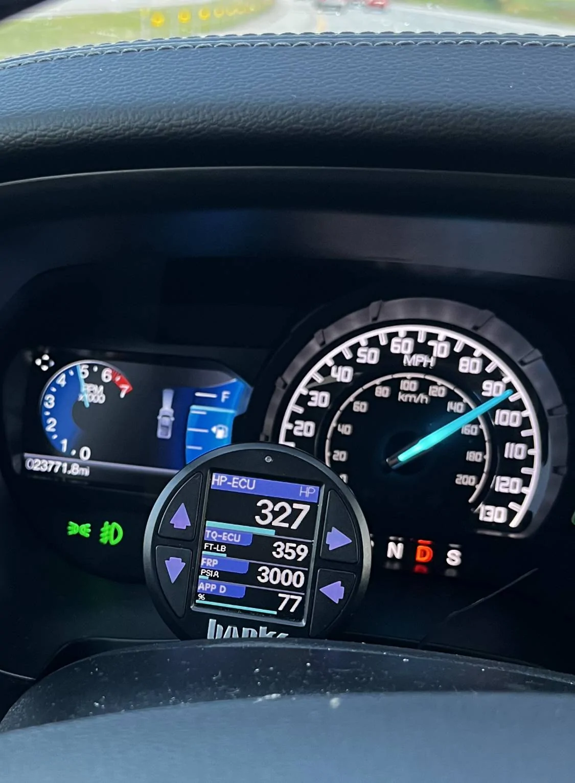

The all have 4 lobe cams, the HPFPs have different part numbers but I don’t know what they flow. I know I’m running over 3000psi and not losing pressure yet but my injectors are done. I’m sure I’ll need a pump once I get injectors but I’m doing one thing at a time to be thorough.
Is the Fuel Rail Pressure the same as the psi reading you are seeing on your injectors. For kicks, I was watching my FRP on my iDash and at idle during startup it was hovering around 3600psi.
Not sure I understand what you’re asking between rail pressure and injector pressure, they use the same sensor. My pressure is currently fine, the injectors just don’t flow anymore. I’m going to get a set of + 50% Ranger injectors from XDI as soon I possible so we can finish tuning. If it ends up needing a pump I’ll do that next.
