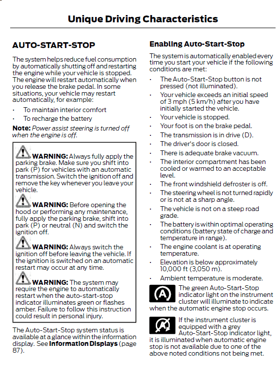

My Ranger is a week old, and the Auto Start/Stop hasn't engaged yet. I don't really want it to, but just curious why it isn't working.

Brad, I know you want to break it in slowly but you have to go faster than 3 mph to activate this feature. ?

Looking over all of these conditions, it is a wonder that it engages at all!
I scanned that before I asked. Didn’t see about Defrost. It’s been on since I got the truck. I turned it off and it worked. Now I have to keep it on forever.

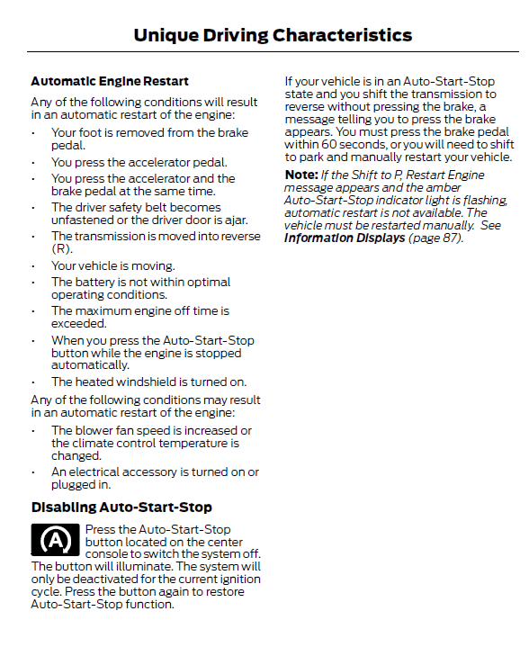

If you want to know why or why ASS is enabled/disabled, you can go into the fuel economy menu in the left hand screen and there is an option to show you why it is, or is not currently active.

This has not worked on my truck for several months and the wife and I kinda miss it. Doesn’t seem to be any kind of unusual event that might cause this.
The button works as expected with the dash message showing on/off when the button is pushed. Fuel menu shows normal operation.
The sensor is connected at the battery.
Ideas to try before a trip to the dealer?
