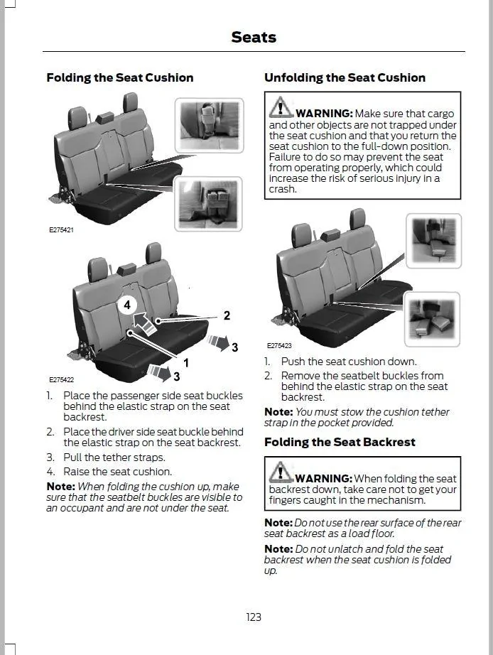

I raised my rear seat to get something stored under it. Now the seat is locked in the up position, Help
142
7,016
36,214
Pull the black nylon strap
Hi Jon,
In the owner's manual under Seats....
Owner's manual is not very good, but I recommend you consult and if you need to cure your insomnia, read it cover to cover....
