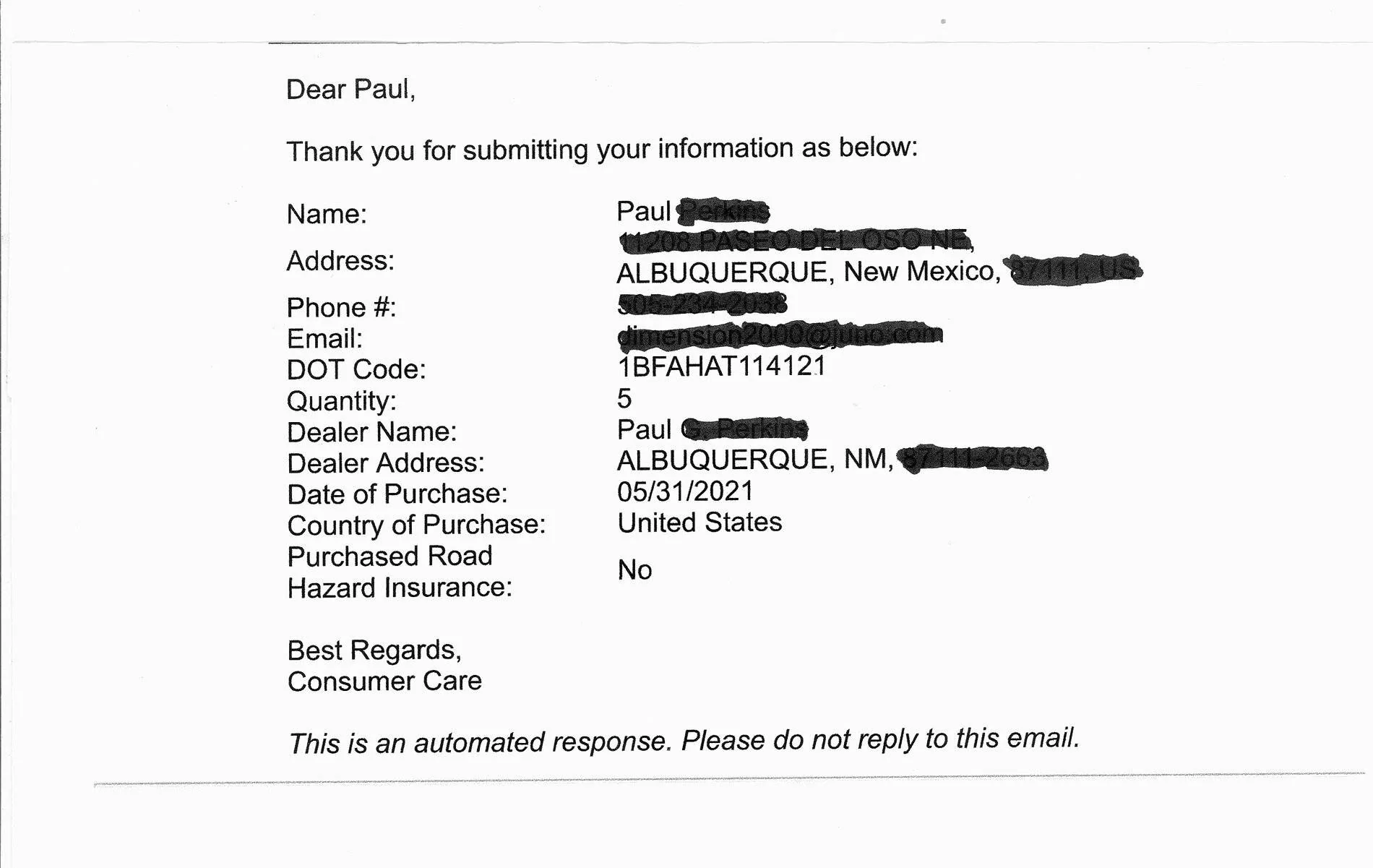

I opened the BFGOODRICH link and a form appeared to fill out:
Next: Enter your contact information:
After you finish the above, fill out this information: Enter your dealer information: (But do not use any Dealer information, instead insert your Name, Address and the following information that applies to yourself). This is permissible and your personal information will be accepted.
Next: Enter the DOT codes from your tires:
You might need to check both sides of your tires for the complete DOT Code. For instance, my BFG’s are mounted with the black sides out and only part of the DOT Code is stamped on this side (the last 4 numbers which is the date is not stamped on this side). I had to look on the inside of my tires where the white lettering appears and was able to get the full DOT Code which includes the date. Do not enter the letters DOT but only the full Code that follows it. Also, do no enter the spaces when you enter the Code.
COMPLETE the information on this page and if you have entered everything correctly,
you will see a check mark with a notification following that mail will be sent to you which
will confirm your registration. I received an email immediately confirming my registration:
