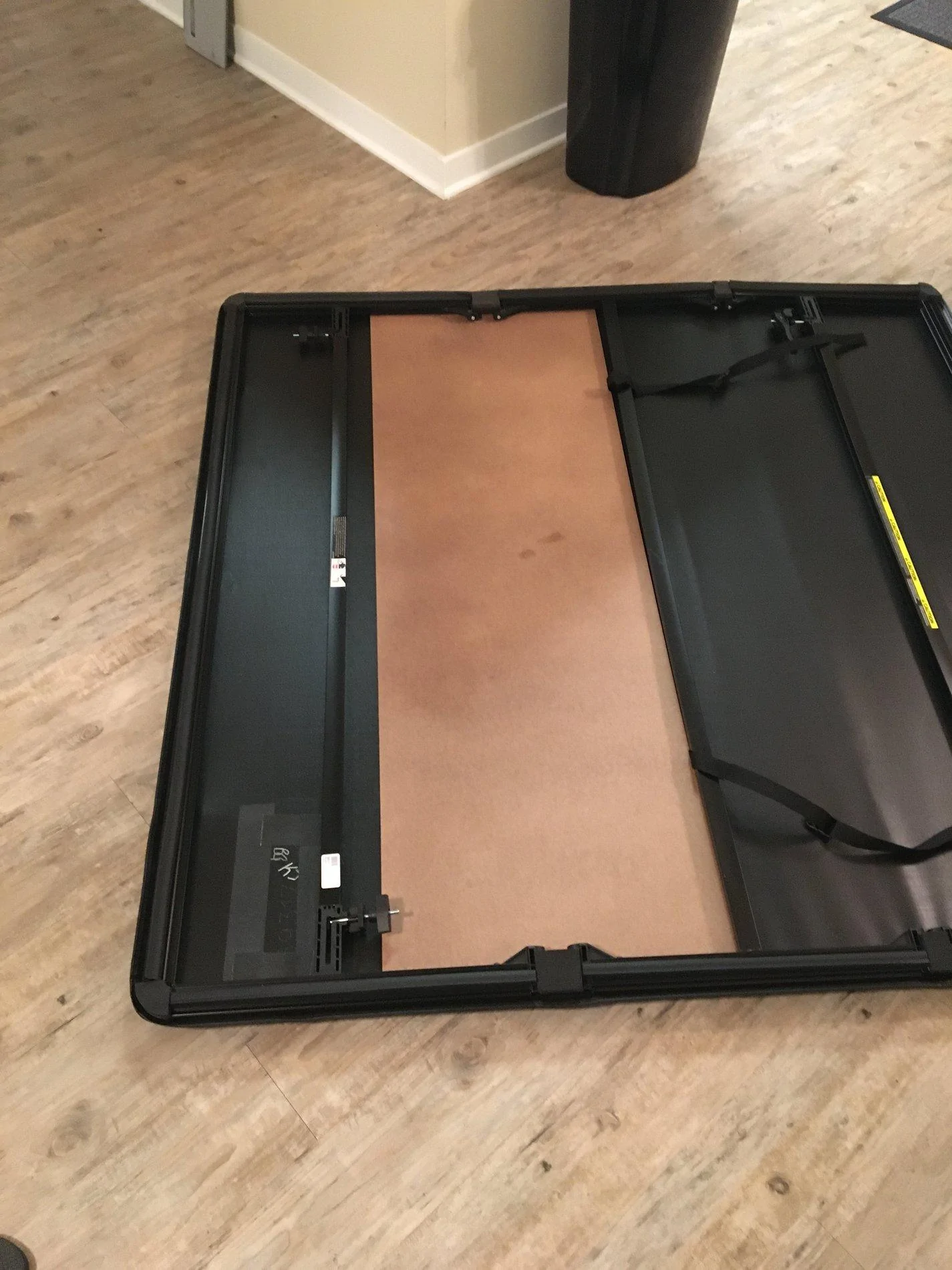

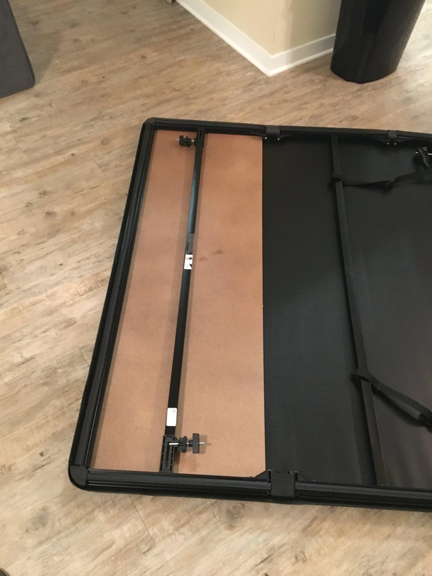

You need a sheet of hardboard ($ 9), measure your size between the frame and cut it for each third. Between the 1st and 2nd strut (from the cab side) is the largest gap to get the sheet in. My middle strut is bended, therefore i kept the middle part without.

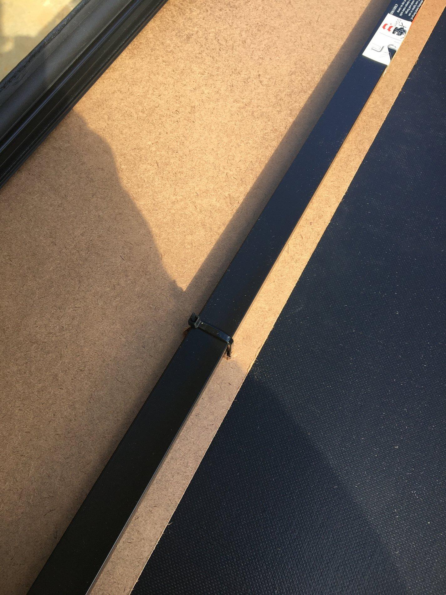

With cable ties to fix it and avoid from moving.
What is the benefit?
You can put something on it without fear that it could tip over (maybe a can of beer) or destroying the tarp. You will feel better if you use the car wash and the dryer fan comes closer :) or if you drive 80 mph on the HW.
Or i was bored and needed such a project (LOL)
