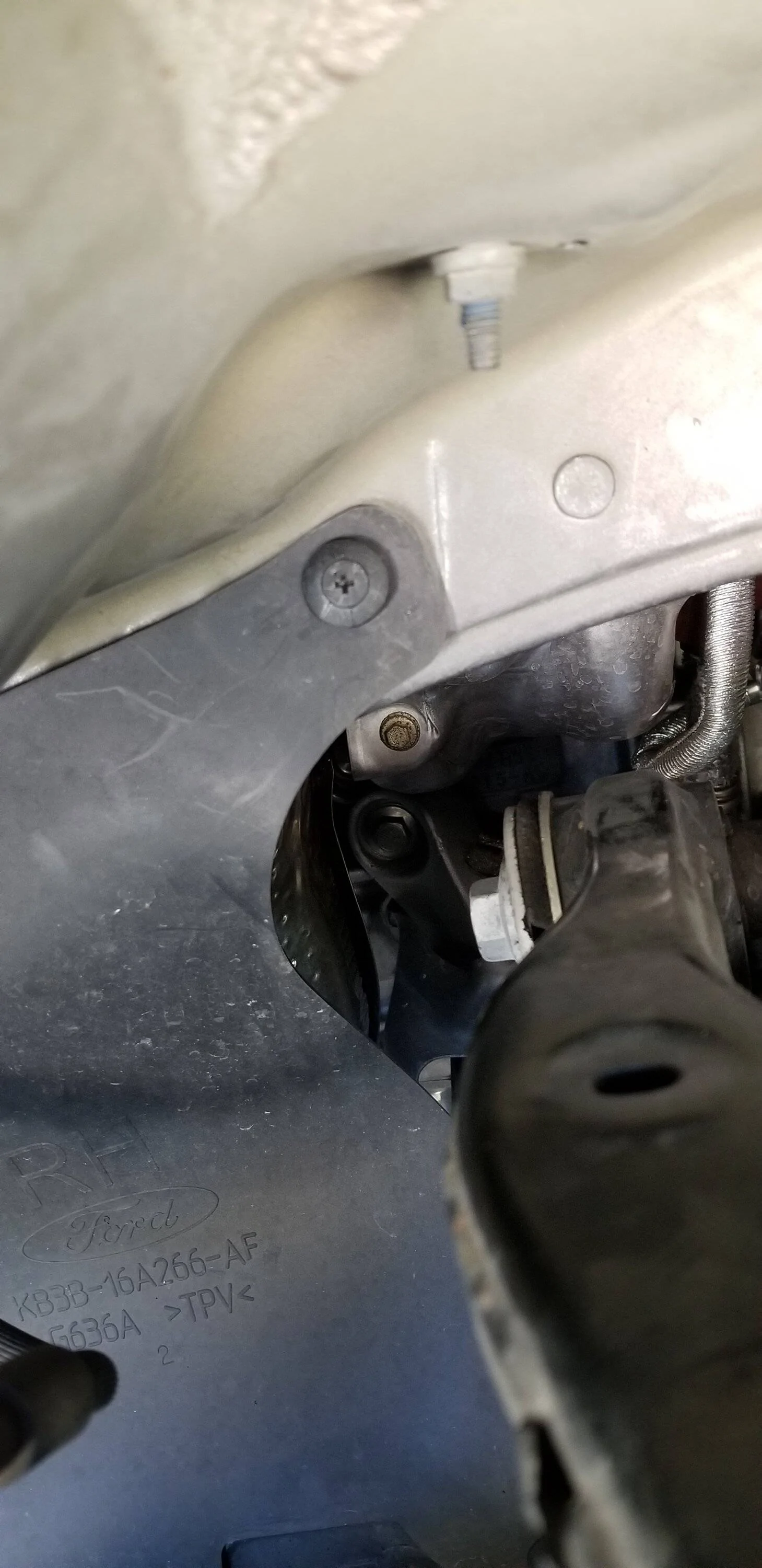

How do you remove these plastic screws holding the fender liner splash guards?

Not sure what they are called exactly but I tried to pull and unscrew, hold outer ring and unscrew inner, yank on it etc. Are you suppose to rip them out 1 time use? Do I need a special tool? Thanks!! Trying to get my downpipe installed.

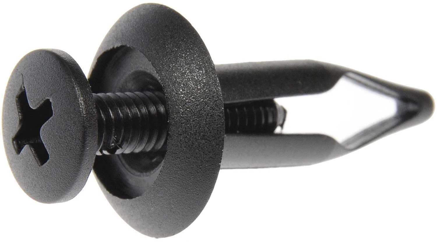

You unscrew them until they stop backing out, They will usually free-spin when they're half way out.
You then use a plastic rivet removal tool (picture below) to remove the base of the clip out.
You don't need this tool, You can use side cutters(don't cut lol) or similar tool to get behind the base of the clip.
Assuming you don't destroy em, they should come out like this
I usually clean them with soap n water before I reuse em.

So far all of the screws have been free spinning from the start but not backing out. Maybe I need to put a little pressure on the back of the screw as untightening. THanks for the info.
In those cases, I'll use a flat blade screw driver to get behind the clip, then use the plastic retainer tool or small side cutters to pop them out.
I have a set of retainers I got from amazon that includes the tool and some body panel tools
https://www.amazon.com/gp/product/B07L6FJGR4/
Sounds like they're broken from the factory so good time to replace em with other styles.

You can’t push in on them at all or they just spin. Best way I found was to just make sure your bit is in the Philips head and gently and slowly turn until the thread begins to catch, then they should come out. Or just destroy them and replace with something better
This was my issue! My dumbass was putting too much pressure when "loosening". Happy to say I now have my downpipe out. Ty for the tip.

Like @RedDakooter05 said - slowly and without any real pressure, back out the Phillips screw part way, then use the trim pin tool.
If they don’t back out and just spin freely, I use a small flat head screwdriver to gently pry the Phillips screw up to get it started.
I also have a crap ton of spares that can be ordered super cheap from Amazon because if either method doesn’t work, I just pop them out and don’t care if they break when I do. ?

I just hold the outside edge with my finger while slowly unscrewing the center. It's a PITA but they'll come out eventually. I loving call these fasteners "Little Bastards". Feel free to adopt the name for your own. ?
