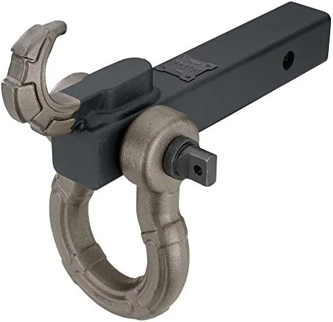

I am thinking of adding a winch on hitch mount to my gear to bring along for days i go further or deeper than i should. Im not worried about the tow hitch being up to the challenge. My concern is the safety chain loops under the hitch tube. example : I run the winch line out to an anchor / pulling point, snatch block it and from that point return the winch line to the rear of the truck. Normally id just use the hitch for a strong hook point. but, if i use a rear winch on the tow hitch that options off the list. Is it safe to use the chain loops under the hitch for my return pull line??? I have no idea what the WLL is for those. I assume they are stout enough to handle the load in keeping with the hitch rating but that does not make them recovery point strong. I know the frame etc. but id prefer not to risk damage for awkward pulls.
thought about one of those dual hitch adapters that could use winch in the top spot and have the lower open for a bow shackle or something but i dont think those are stout enough. those would sheer and the winch would pull itself free from the adapter.

I'd be leery of the chain loops.
You don't want to be the guy to find out they weren't up to the task.
All it takes is that one time where the pull was just too much.

thats what im worried about too. they may be ok for keeping the trailer from going out of control into traffic but thats different stress than being winched on at off center lines etc.

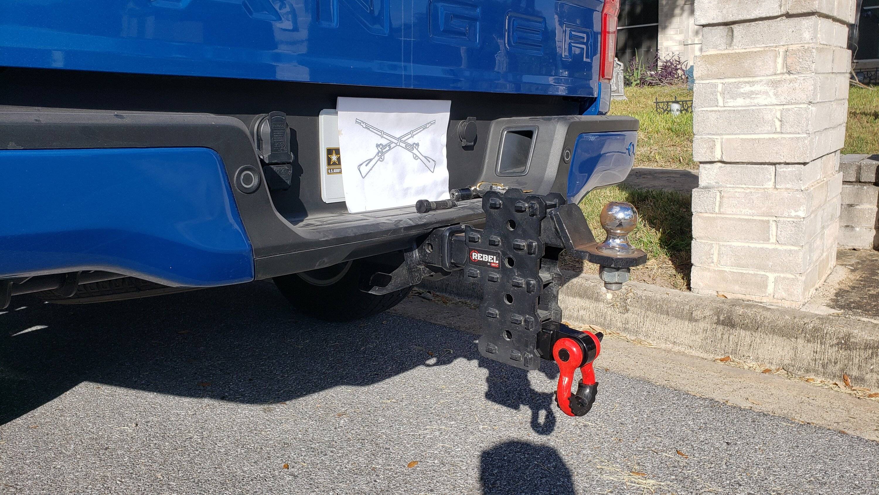

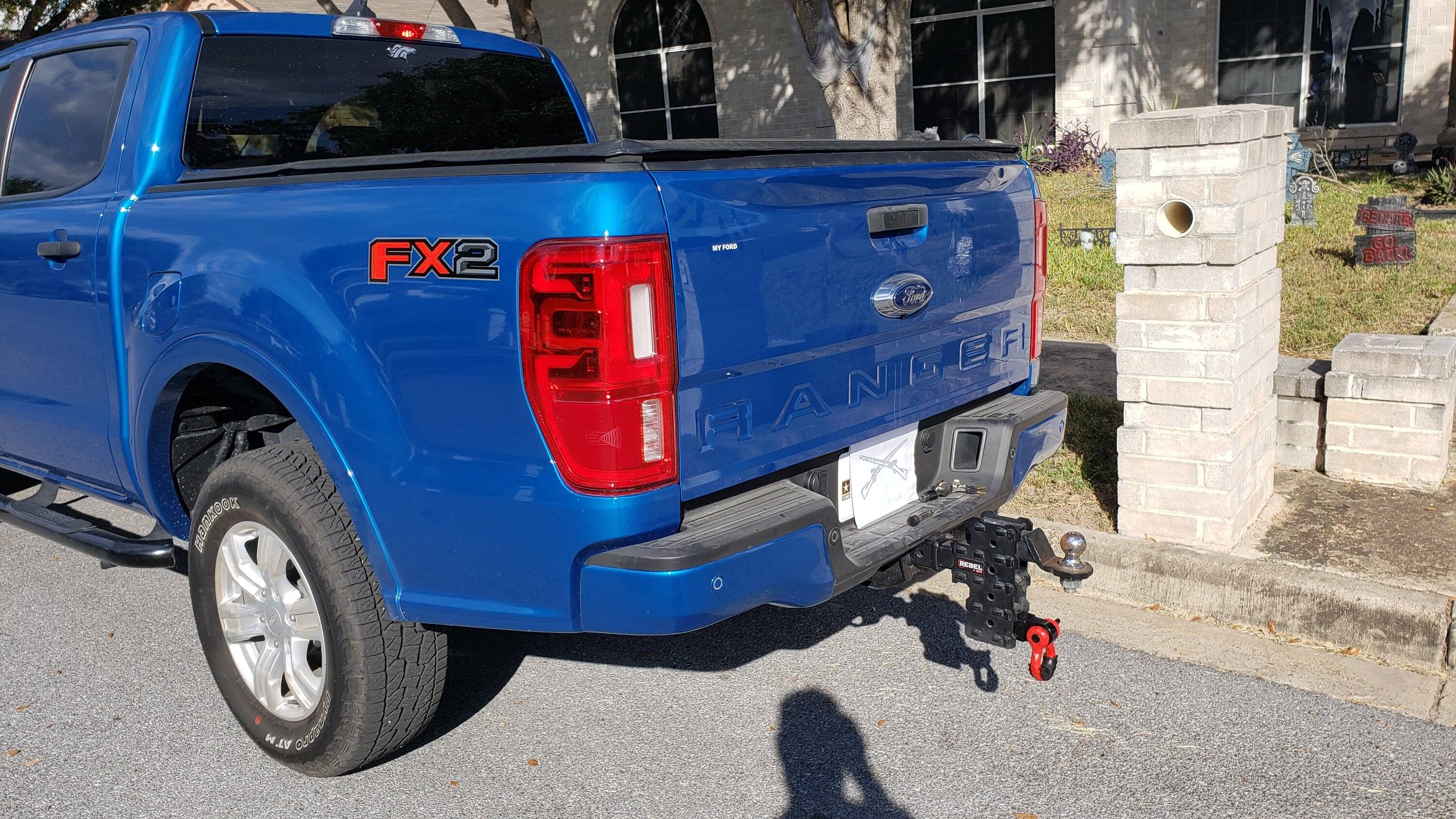

Maybe something like this? You can put the winch where the tow hitch is and then of course the loop.

Would not use this for tugging off of.

that is very similar to what i was thinking of! i was thinking putting all the stress back on one spot with the adapter would make whatever the weakest weld or spot was would sheer off.
