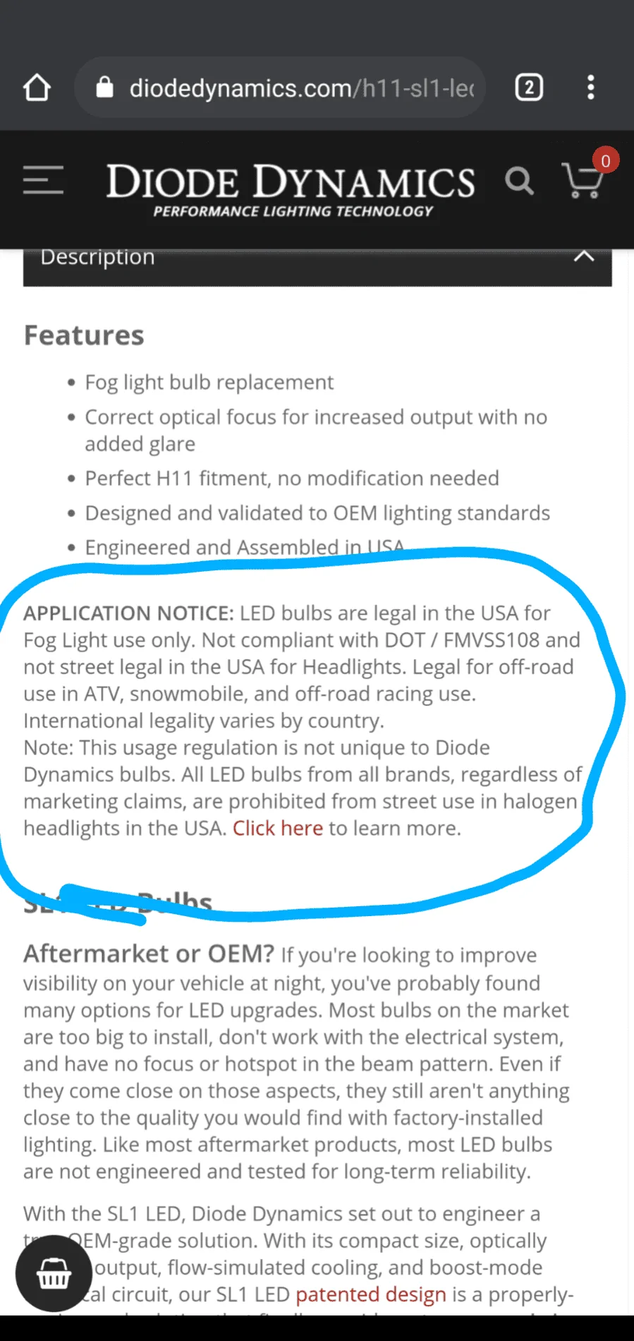

H11 is the correct size for Non-lariat low beams and Fogs. Lariat uses LEDs for both.
Seems like if they don't meet a set standard retailers arn't allowed to list them as compatible for headlights.
If they were Hella Yellows they are not street legal in headlights.
Compatibility guides are wrong from time to time.
