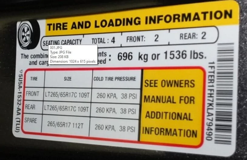

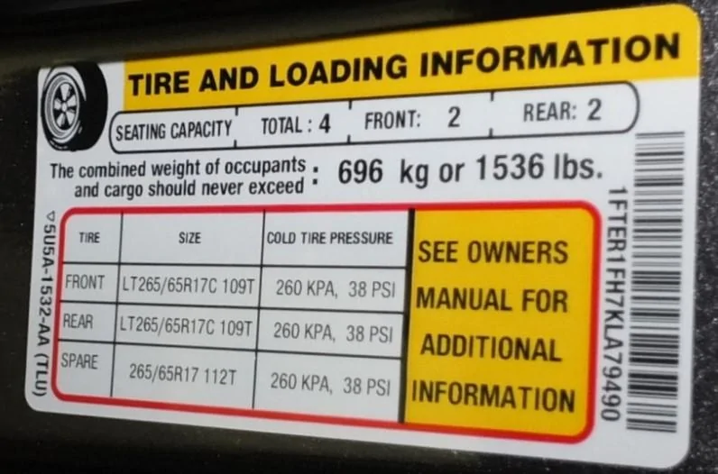

Pretty amazing the variance of pressures based on tire sizes... here's a photo of the door sticker for my Ranger:
I noticed your tire/rim is R17C what is that compared to R17's?
I have no idea. I know the sticker has R17C... but there is no "C" on the tire.

I notice that your wheels are shown as LT265's and the previous photo above yours shows just 265's.
That would account for the 38psi vs 30psi variance.
Not sure about that SN13. My spare isn't an LT tire (I verified that on the truck spare), yet the sticker on the door frame shows the same pressure, LT vs non-LT, @ 38 PSI.
And I checked the "factory air" in the spare tire... it has 38 PSI in it.
The other thing I'm noticing... on my truck the spare has a higher load capacity (112T), than the LT tires (109T)? And I think that's true of most trucks, the spare has a higher load capacity.
LTs always have a higher pressure than non-LT for a given load rating. The spare is probably defined as the same because having one tire running almost 10PSI/25% lower could lead to squirrely handling.

its not the tire size its the load ratting, you have the LT tires, 10 ply rated, the nonLT are 4 ply rated that's why the difference in pressure

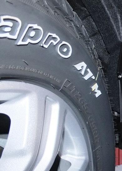

A "C" denotes a 6 ply tire a "D" is an 8 ply tire and an "E" is a 10 ply
Ugh... OK... Great...
So when the tire doesn't have a C.... or a D.... or an E... yet it has LT.... what say ye then?
