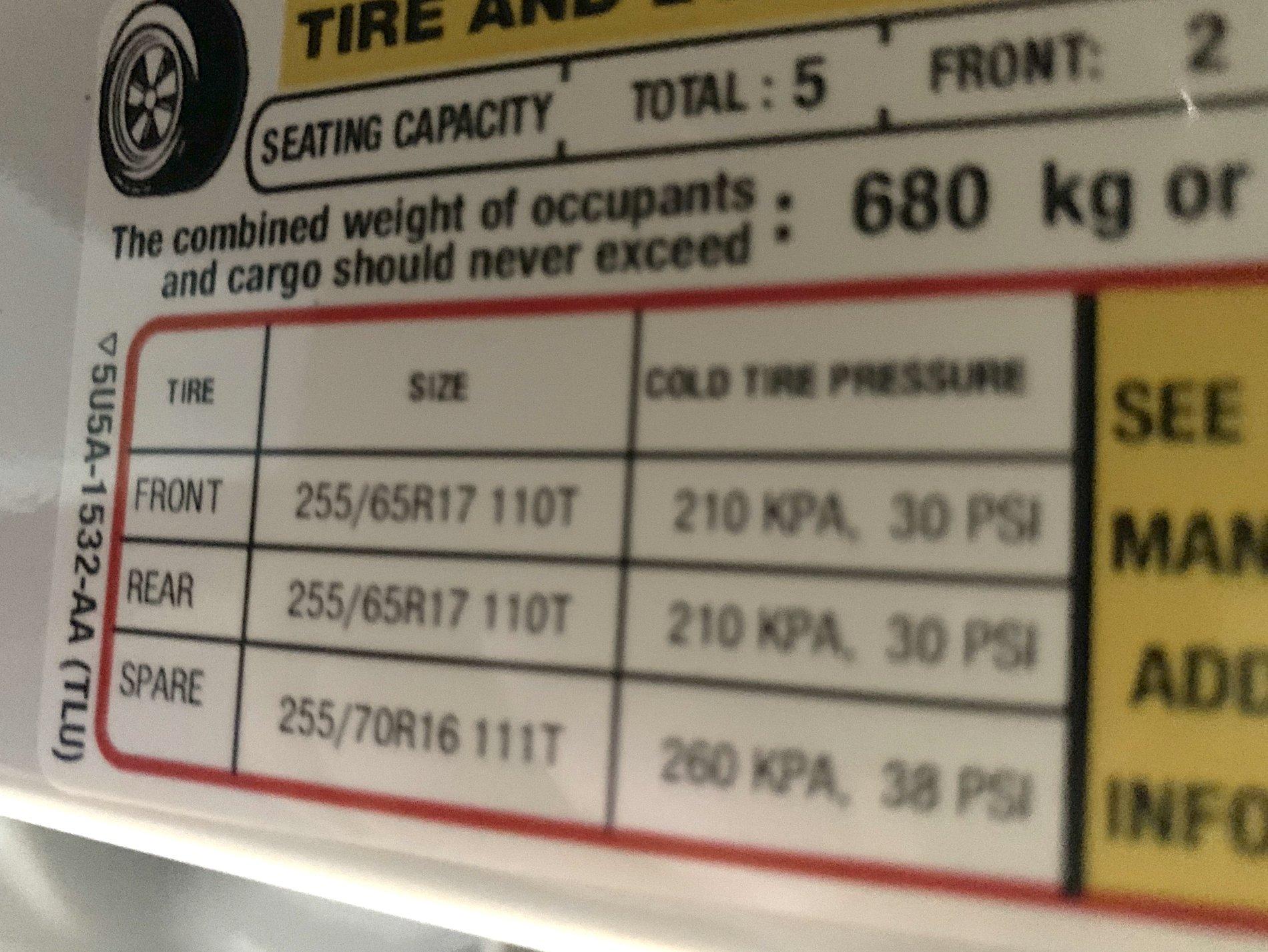

What are the recommended levels on the sticker? I've now increased mine all around from sticker 30 to 32, w/ the cooler temps I'll see how they do.

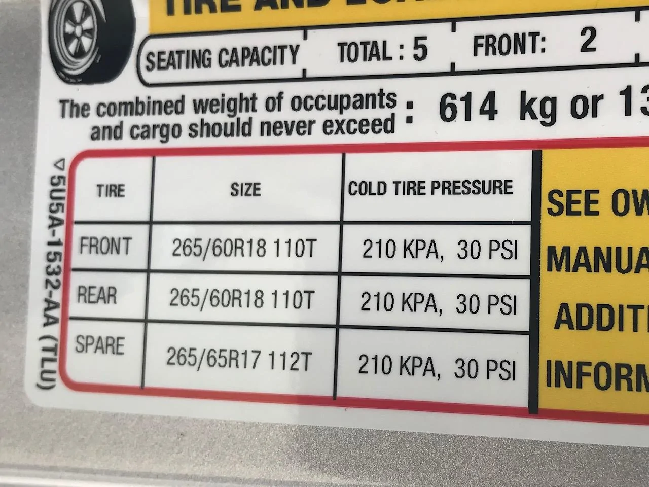

We all know on a truck the weight ratio, front to rear, is pretty dramatic when the truck isn't loaded.
I've always wondered why the sticker doesn't show an "Empty Truck" tire pressure and a "Loaded Truck" tire pressure?
Seems like that would be ideal, the correct pressure based on the actual loading.
Pretty amazing the variance of pressures based on tire sizes... here's a photo of the door sticker for my Ranger:
The tires themselves have the max loaded weight and tire pressure recommendations on them already.
There are just too many variables to the weight of a load where they couldn't put them all on the sticker.
Also, many people change different tire types and ratings.
I've seen on the forum people going from OEM S load to XL load or even E load rated tires and they all have different tire pressure recommendations per manufacturer.
It's just up to the individual as long as they don't exceded the max pressure rating of each tire.

the differences in tire pressure have little to do with load ratings (all the rangers are the same, and aren't stressing tire limits) and more to do with things like sidewall stiffness

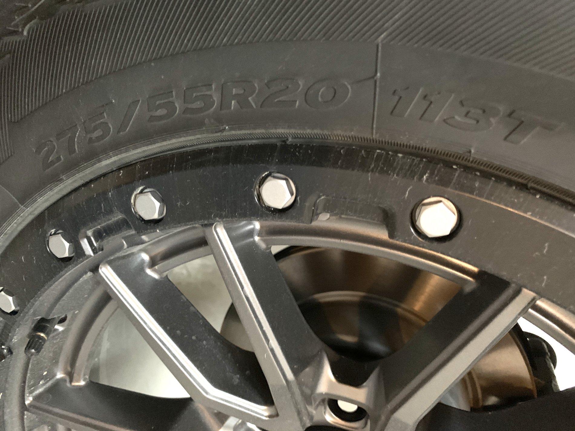

Dealer installed Hankook 275/55R20’s on mine (plus 2.25” lift) before I bought it, but never changed out the door sticker. How can I find out the real pressures?

If it's not a factory combination the only way to find the optimum pressure is to chalk the tires. Here's a video

I notice that your wheels are shown as LT265's and the previous photo above yours shows just 265's.
That would account for the 38psi vs 30psi variance.
