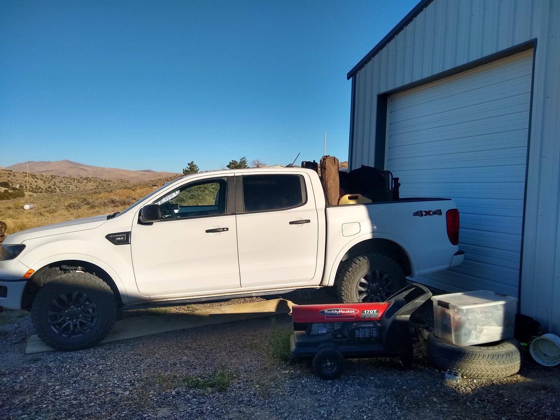

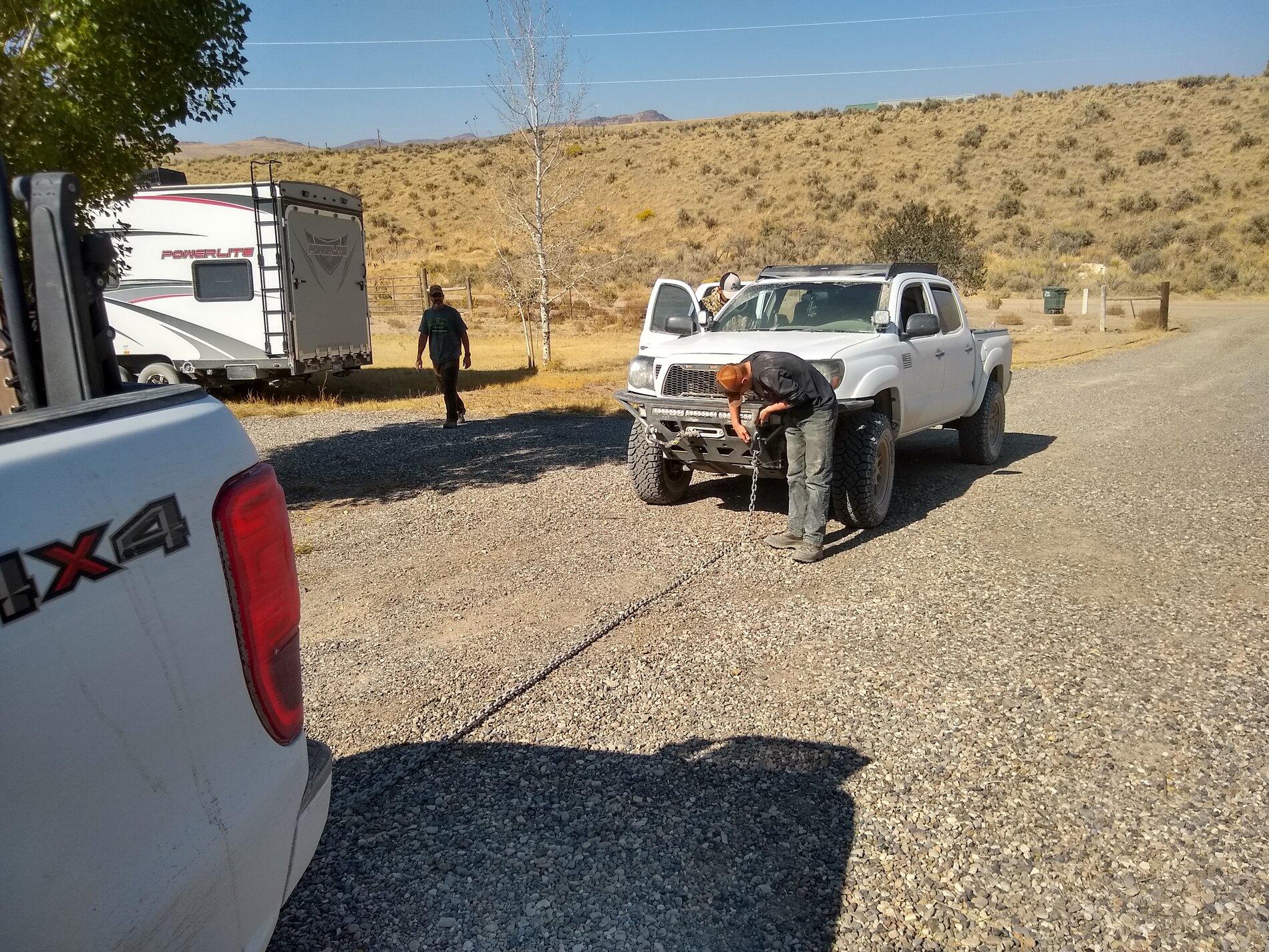

Out deer huntin with my kid who has a 2005 Tacoma decked out for off road with lots of clearance. Out in the brush, dust and rocks this past weekend, his Fumoto valve protection clip came off (or was removed by bushes) valve opened, lost all his oil, thought we caught it in time, got oil back in pan, thought it was ok, nope..... Engine is done, I had to tow it with my ranger which was loaded with a wall tent camp..... I know nothing about these valves and would only say, if you actually take your rig out in the sticks maybe dont put one of those quick drain valves on your truck......On a lighter note, the Ranger prolly had 500 pounds in the bed and towed the Tacoma 100 miles up and down a summit with no issues.... I do have the timberline bump springs installed and that made things great for the bed weight.
