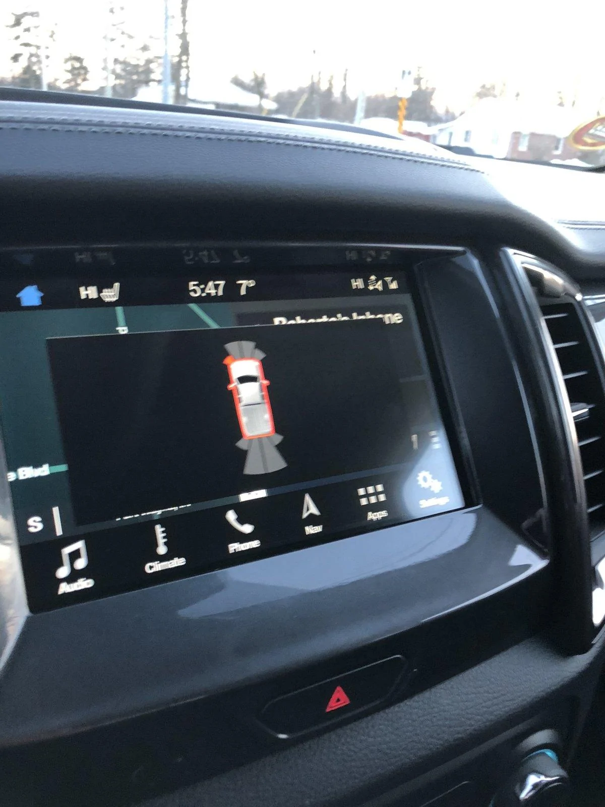

Just today my front far left sensor started going off constantly when I go at low speeds. Doesn’t stop. I think it is mainly because of the weather/wind. The sensor is directly where the wind is coming from. Started this morning. I tried cleaning it but really there wasn’t anything to clean off. It has been in the red as you can see from the picture. I actually tried giving it some warm air from my mouth and it started going to the yellow. But went back. So it makes me think there’s some moisture/ice inside or something. Anyone have experience with this with a different vehicle? Emailed the dealership.

It is just refusing to work correctly because it is too COLD!!!! :LOL:

On my wife's '15 C-Max when they get dirty they go off sometimes. And also occasionally in VERY heavy rain - but it only happens when you are driving slowly. It is kind of annoying when you pull up to a stoplight and they start beeping even though no one is close. Cleaning them has always fixed that issue for us.

So... It finally stopped an hour ago after work. It definitely seemed like it was ice within the sensor. And I figured it was because I actually used a blow dryer to it 2 days ago and it stopped for awhile. But it was like still -12 then.
Sun has been on it for awhile, and while it is 14 degrees. It seems like it has melted. I will let you know if it comes back. If it comes back I will try to get it replaced, but seems to be working now!

Note, I cleaned it and made sure there was no ice on it or anything. Saw online, a McDonald’s bag stuck in the bumper could cause this. lol but it was too cold to check for that.

Good day all, both my front sensors left and right side have been doing this intermittently since I got the truck. I am wondering if there is more to the story here. One thing I will say is that I had my truck rust proofed which would have involved spraying the underside. Perhaps some of that product made its way on to the sensors? However if anyone else can comment that has had this issue it would be great.

If they dirty, they will go off intermittently.
