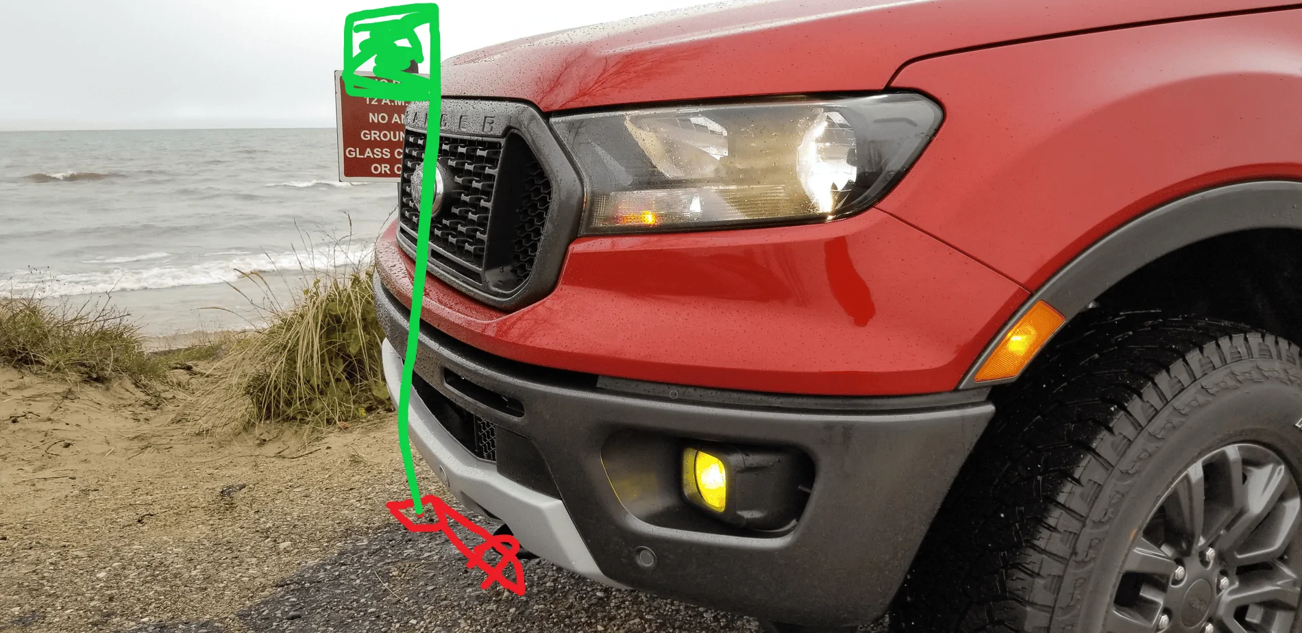

Now, onto my community help request. The parks seem to all require a front bumper mounted flag. I can't really seem to figure out how to proceed with that. I don't want to drill into the actual bumper, so I thought that a good place to mount it would be onto the tow hook. The only tow hook-direct mount I'm coming across seems to be just two circular plates that sandwich the tow hook. It has bad reviews online, and seems to me that it wouldn't be that great anyways. Otherwise, it seems that you mount a bracket to the bolts that the tow hooks attach to. Except I was hoping for something a bit more temporary. Any bracket I put on, I'll have to take off in order to fit back into the garage, so I really was hoping against constantly removing the tow hook and retorquing it since it's a vehicle recovery point and everything.

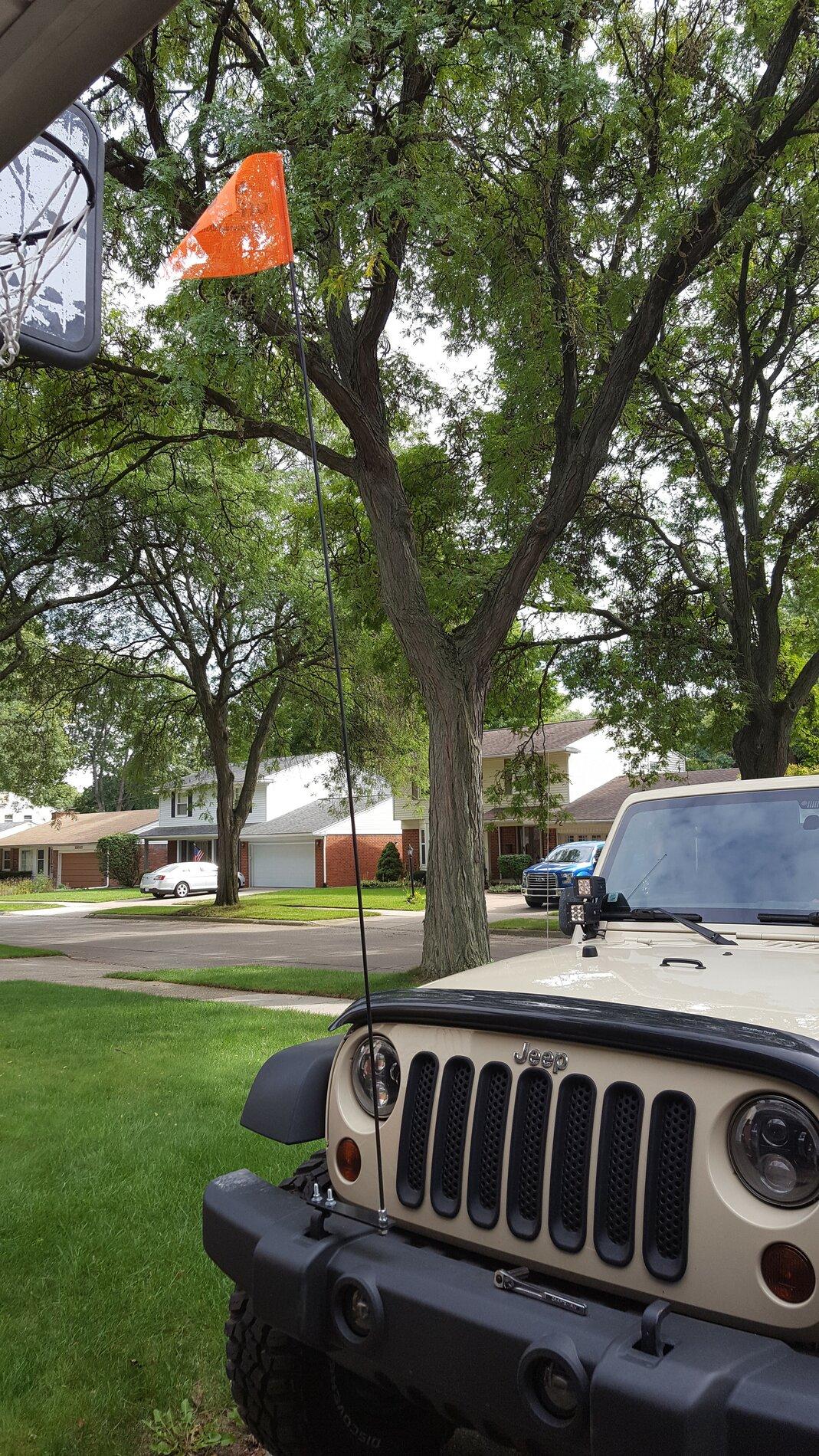

I feel the pain on the front mounted flag! I offroad plenty in Michigan here as well, though mostly with my Jeep! While most places say that you should have a flag mounted to the front, most of the parks around Michigan don't really check that closely or measure either. I think it's most important at Silver Lake because of the dunes and the high speed nature. Most of the rest of the parks around Michigan are not nearly as strict. With that being said, I do have a few ideas on the matter.
First off, check out Appletree for some flag mounting options. That is where I got my flag mount for my Jeep and their prices are super reasonable! The most easily mounted for our stock tow hooks would probably be the sandwich type tow hook mount as it keeps everything horizontal, but I have never used one.

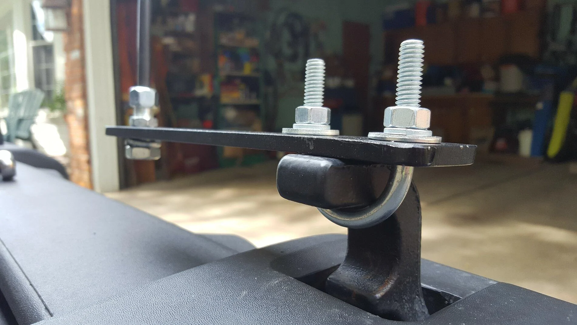

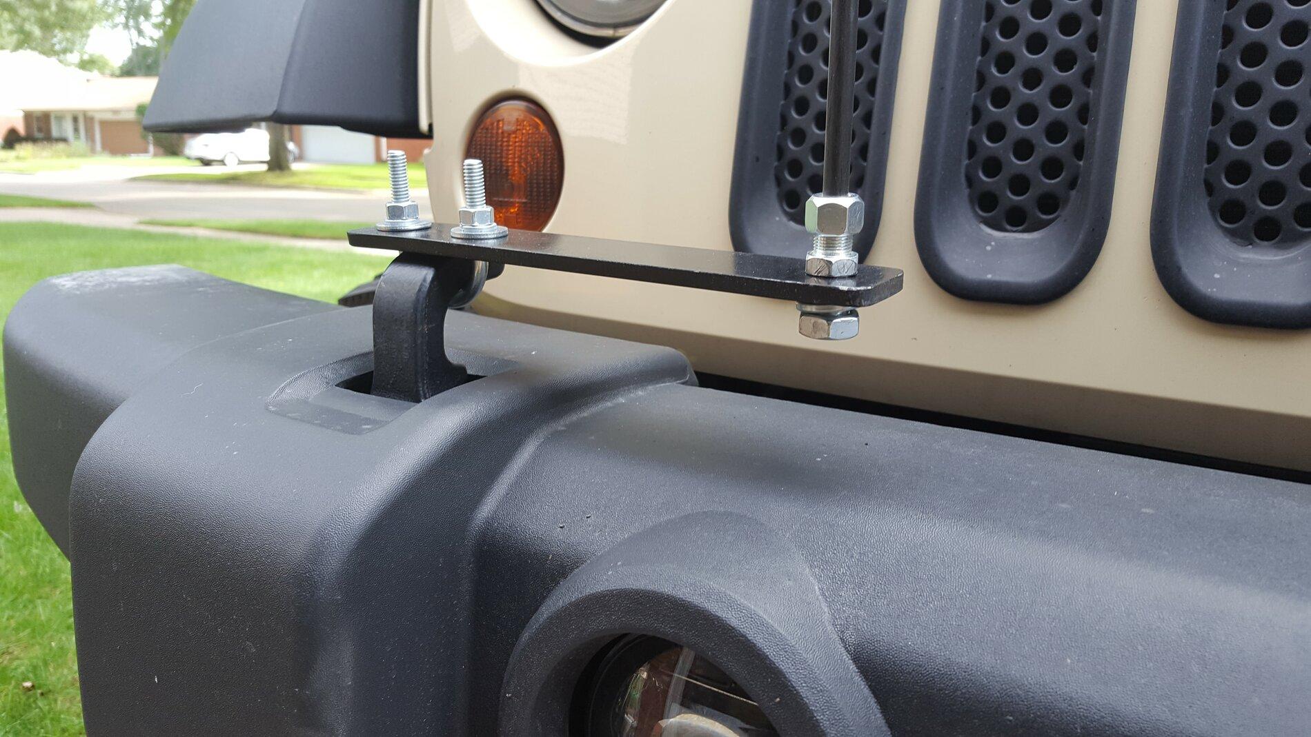

Next option would be to use a u-bolt with a flat plate! I have used this method on my Jeep for years and just tightening the U-bolt down has never allowed the mount to come loose, and I have put some good pressure on the flag! Here's the bracket I am talking about and how it is mounted on my Jeep OEM tow hook.
As for either of those mounts, the biggest thing I don't like for the Ranger is that the tow hooks are so low, that a flat plate stick straight out hurts your approach angle and I would be worried about it digging in too much in the ground. Another idea I had is a play on the flat mount above and that would be to attached the mount on an angle to the tow hook (like a 30 degree angle) so that it is raising the flag up and putting a flat face down more like a skid plate, and then putting a flat bend on the end of the mount for the flag. Would be pretty simple to put together, just not sure how well the hold would be. Maybe I will test the hold a bit later with my mount I currently have. Please excuse my horrible paint drawing, but you can kind of see my idea in the picture below.

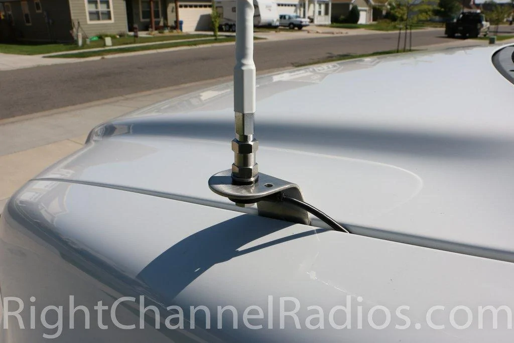

Lastly you could get a hood/fender antenna mount such as those meant for a CB or other radio antenna and mount it on the fender. Would probably be strong enough and would be close enough to the front of the vehicle for most Michigan ORV parks in my opinion.
