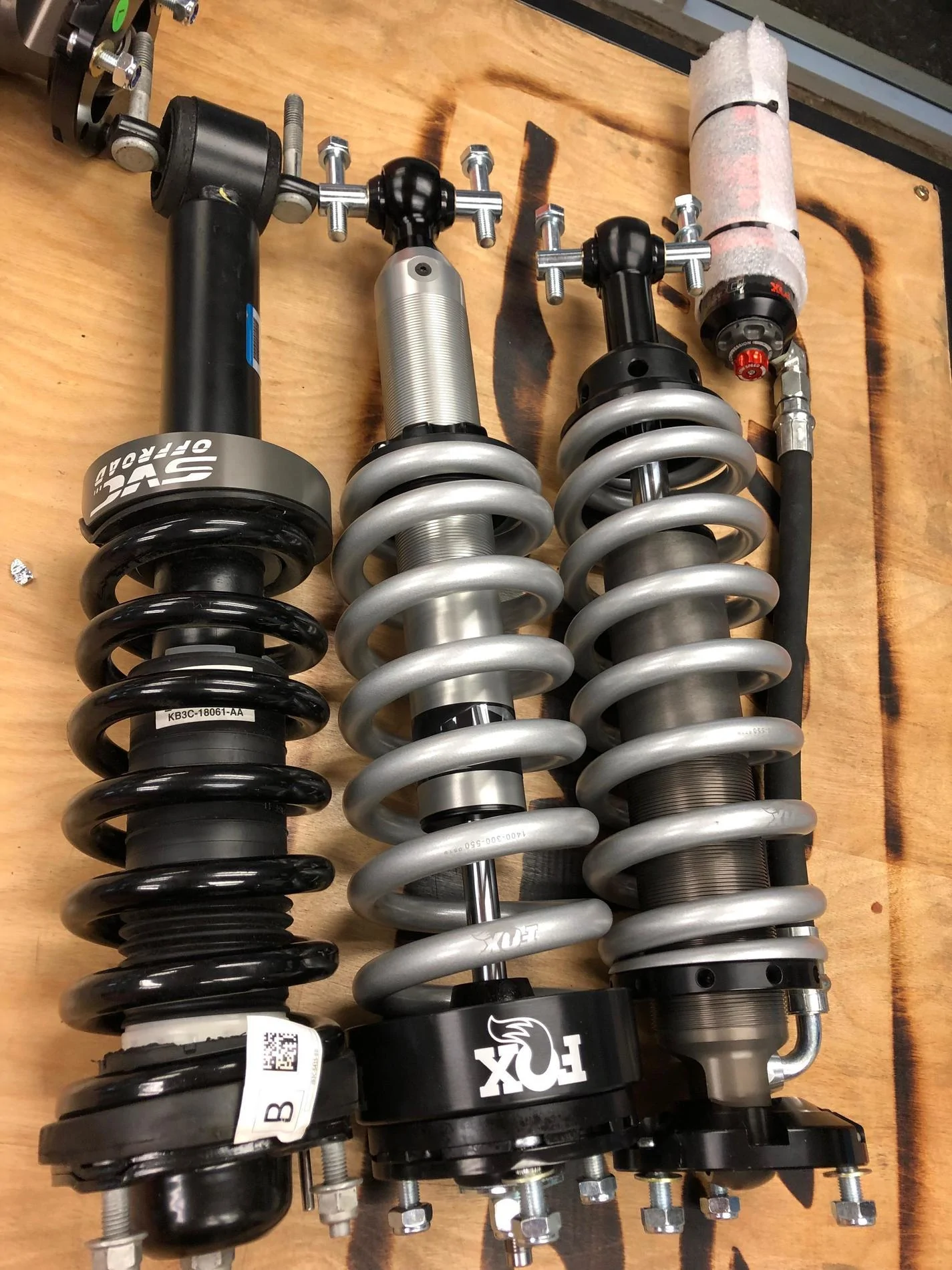

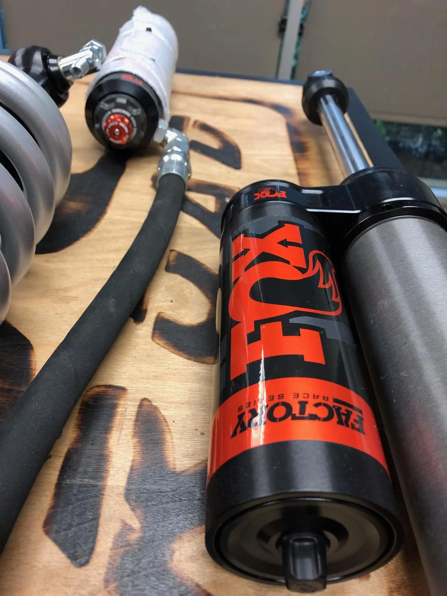

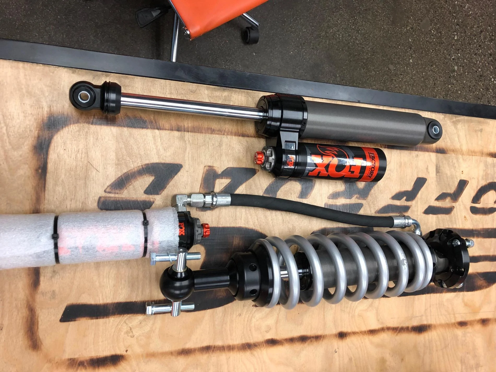

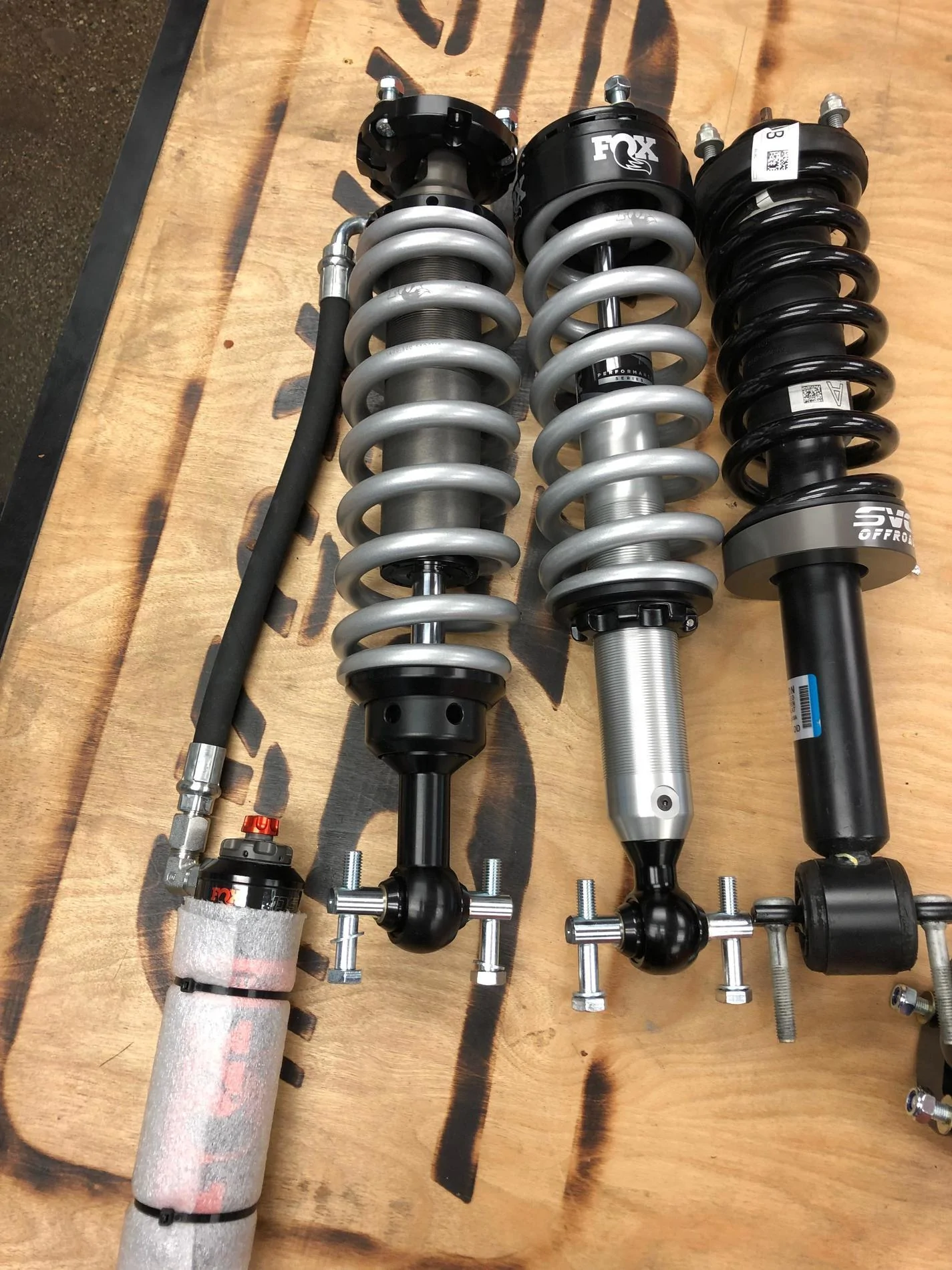

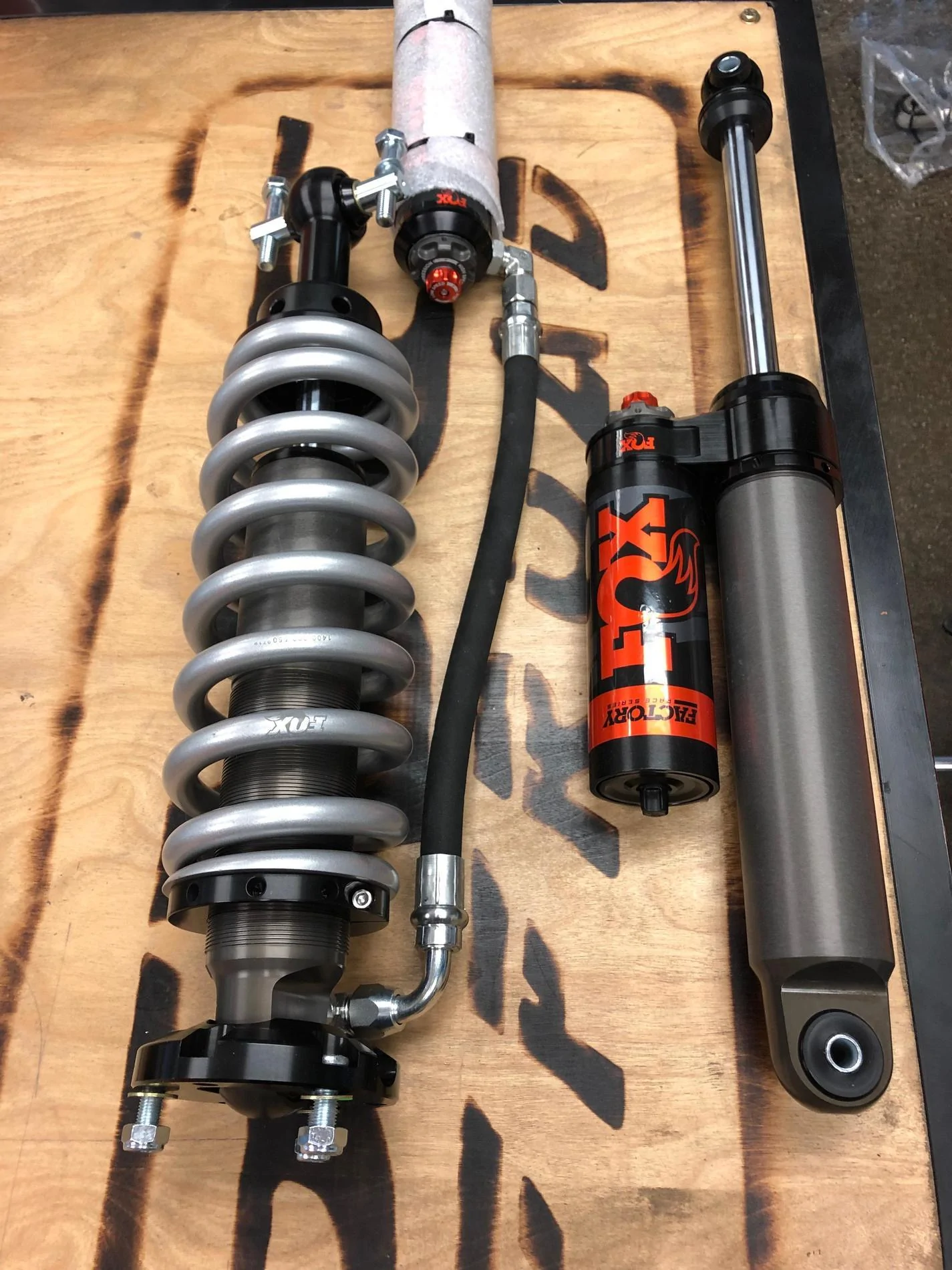

    Wanted to start a thread showing you guys some of the cool stuff we have been working on with the Fox Racing Shocks Engineer dept. SVCOFFOAD was lucky enough to Team up with the Fox team during Prototype and Pre-produciton phases to help offer input on what we would like to see on their line of Ranger Shocks. Over the years we have been known to push the limits of The factory Ford Platforms to find out just how capable they are, Same thing will be for the Ranger. Below are some comparison pics pre install. Feel free to ask any questions you would like answered! I have listed some Key points Fox has done to make these shocks unique and simply put badass. Excited to share our feed back post install.
    1.) All new Aluminum Bodies On Coil-over and Rear shocks with Hard Anodize.
    - This Will now mean the shocks bodies will not be easily destroyed by harsh elements like the steal bodies in the past. This is huge for states using road salt during the winter.
    - This also Means they are lighter weight(less un-sprung weight)
    2.) Dual Speed Compression Adjuster standard on all 2.5 models
    - Low AND High speed compression adjustment will let you fine tune your ride
    - Quick and easy adjustments for Front AND Rear depending on preference, terrain , and truck setup
    3.)Nothing new but should be noted
    - Allows for up to 3" of lift
    - Threaded body lets you set ride height to your liking and even offset height side to side to counter any "lean"
    - Larger shaft for better control on and off-road
    - Added travel both front and rear
    - External Resi. for more fluid flow/displacement

    Look soooooo sleek! Anxiously awaiting how the ride quality is!

    Looks awesome! Just for reference whats the diameter of the Ford factory shock body?

    How do you adjust ride height?
    All the threads I can see seem to be for spring preload.

    Stock shock is a 2.0 diameter as well but different valving/ piston and body then the fox 2.0 setup

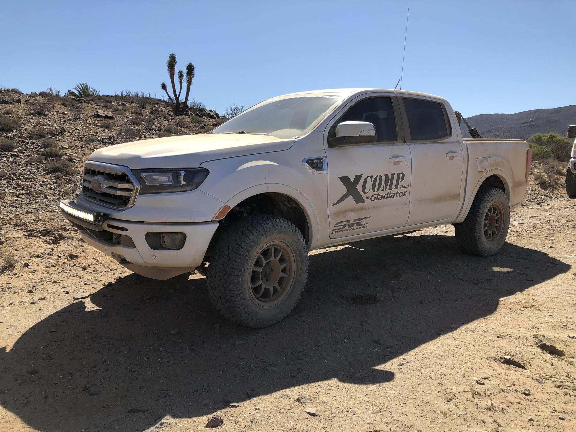

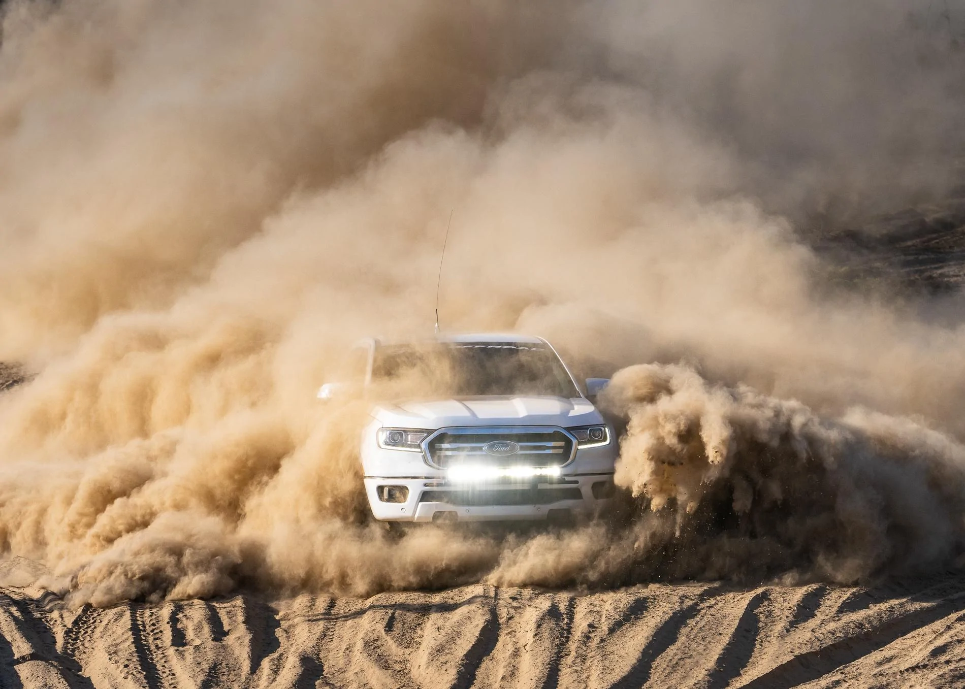

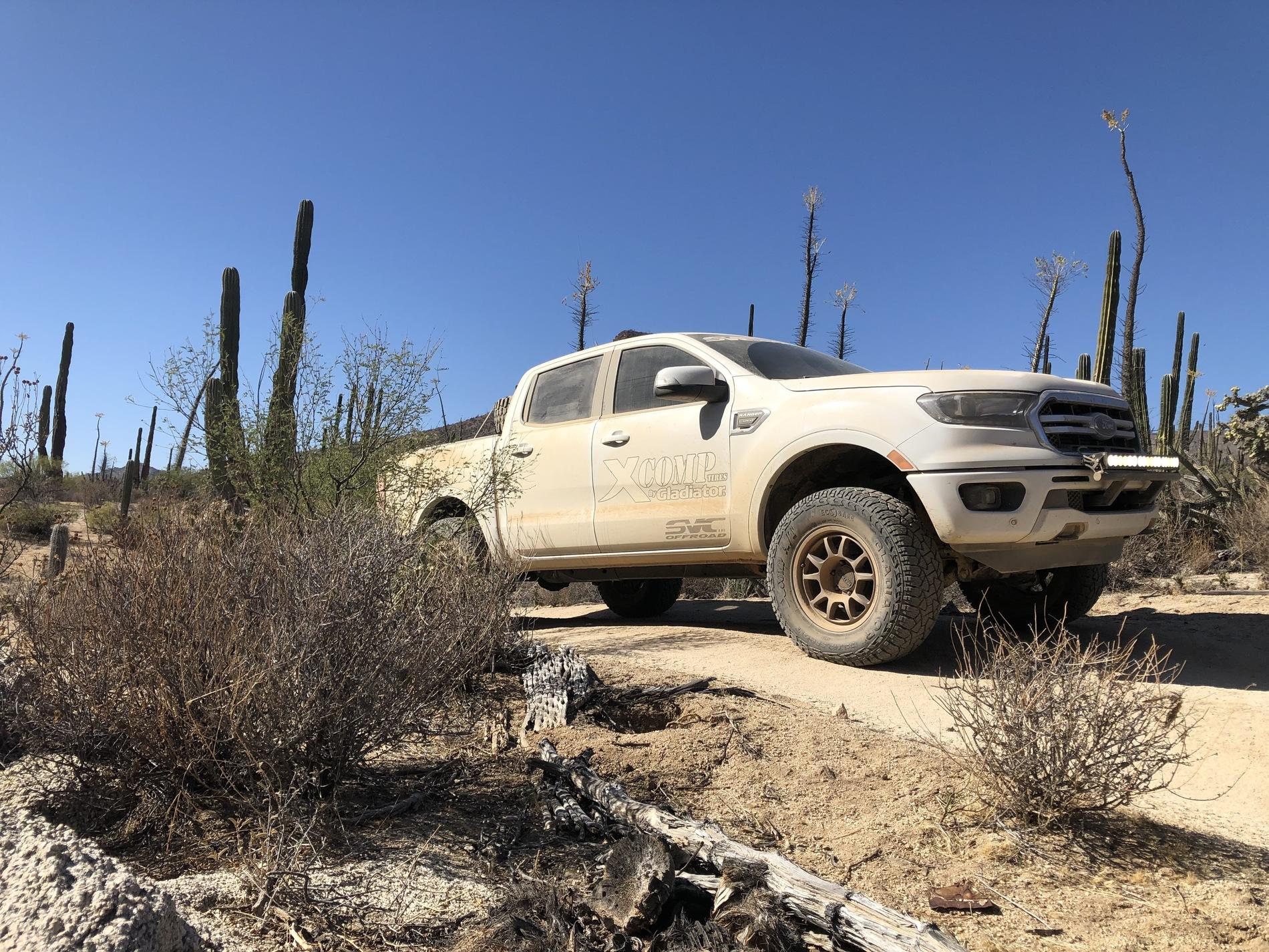

    Just ran about 600 miles off-road down in baja and these things kicked some ass! was a little soft at first but cranked down high speed for some of the un expected hits and helped tremendously . even ran with 3 full size spares and a ice-chest loaded to the brim. totally different playing field then the stocker's or 2.0s will get some pics up shortly

    Beyond confident enough I could run on the raptor runs and keep up. The adjust ability was huge especially when I began carrying the 3rd spare from another truck.
