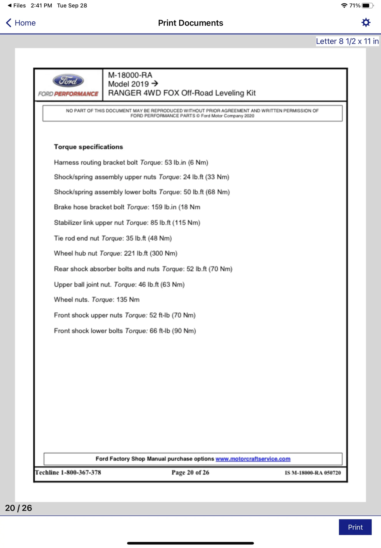

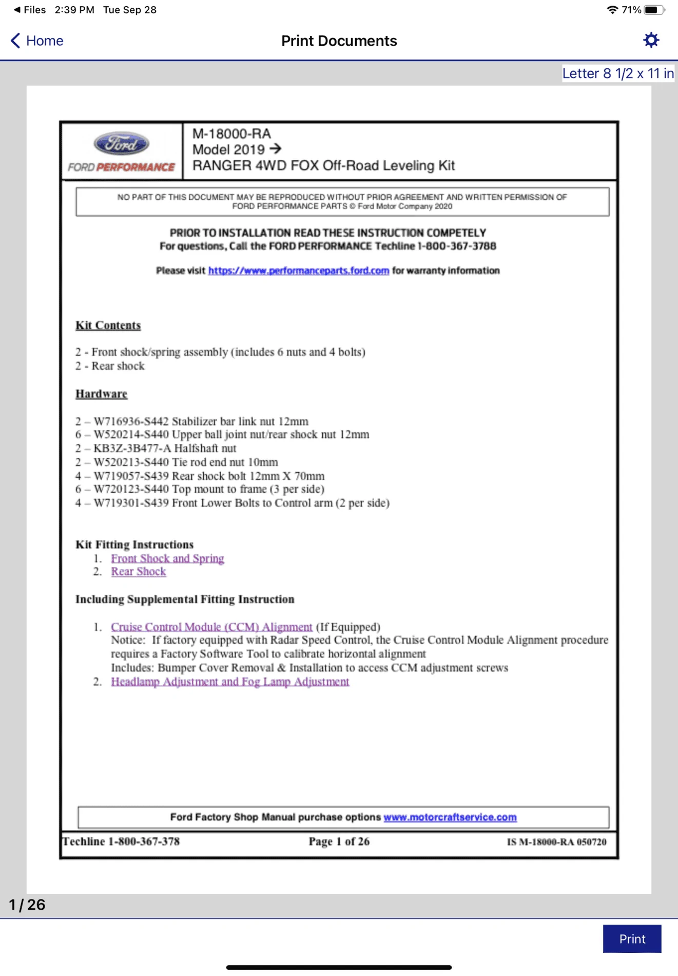

The other part is listening to that 2% and wondering if I missed it after install. Meaning a mistake on our part or failed unit from Fox. We followed the Ford Fox install pdf to the T, except for the new hardware at the swaybar, tie rod, and axle. Which could've led to loosening up.
Think I'll get to the dealership before I go over to my brother-in-laws place this weekend. Hopefully they have that hardware in stock.
Anybody got the Ford part numbers for the axle nut, swaybar nut and tie rod end nut?
